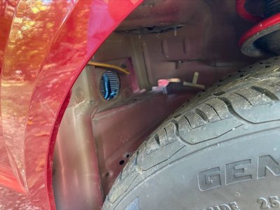

also if anyone wants to unplug the door harness, I made a little video of that.

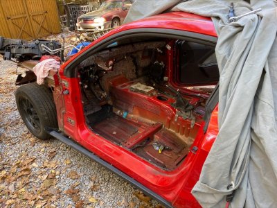

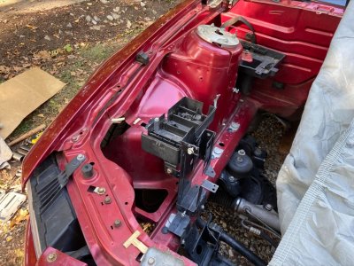

thank you, it was a Southern car we bought used but it was only a couple years old. We have tried to keep it nice. If the engine hadn't blown up I would have just kept driving it as is. It still has less than 100K miles (on the body). My wife drove it to work and the kids borrowed it once in a while. Now it becomes a bit of a toy!Nice work. It looks like you've prepared the blank canvas ready to paint your own masterpiece. The '07 has an impressively clean and rust-free bodyshell.
Thanks,I think this is the first 4.0 to 3.7 swap I’ve seen that went this in depth! Kudos to you for documenting everything so well! I hope you enjoy it and it’s worth all the effort once it’s all back together! I’m putting parts together for a 5.0 swap in an 08 s197 at the moment so I understand the want for a newer powertrain in an older chassis!
