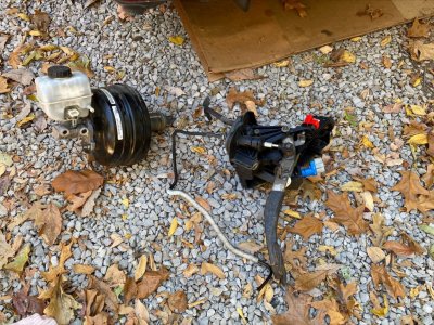

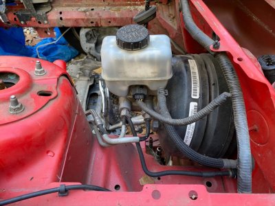

One thing I found interesting is that the hydraulic clutch uses the brake fluid from the master cylinder (MC)... and the 07 MC has a provision already for it!
Yeah, the 05-09 Mustangs have a common reservoir for both the brake and clutch fluid. However if you look inside, there are two separate compartments. This ensures that a leak in one system won't cause a failure in the other e.g. clutch slave cylinder leak won't cause a brake system failure!
good to know! I was wondering about that!

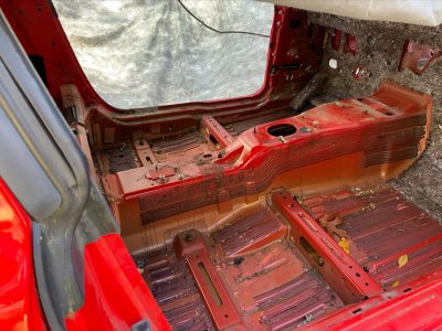

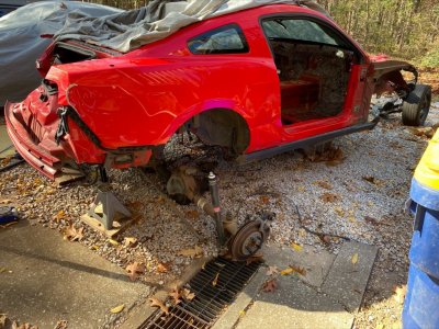

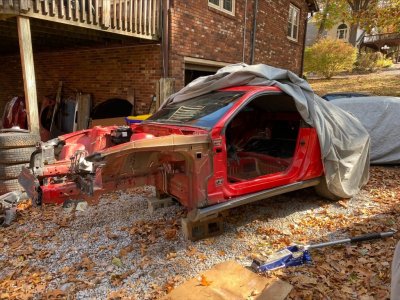

I did finally get all the wiring out of the 12. I also removed the clutch & brake pedal assembly and brake booster. I'll put the car up on stands and drop the K member and rear-end as well as the E-brake and ABS stuff. then I think it's ready to get scrapped.

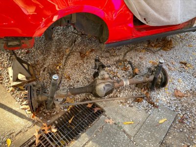

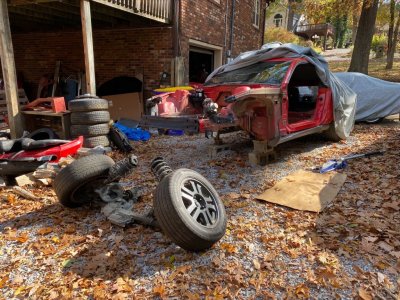

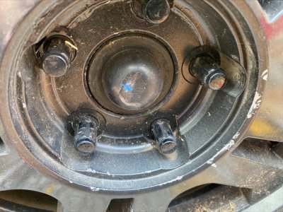

I ran into an issue removing (or not be able to remove the wheels). I'll have to get a "key" socket. But I did get the K-member off at least. Still need to pull the rear axle though.

"Tuner" lugs, hate those things lol.
I had a car a few years back, factory locks, no key. I welded a regular lug nut to one, removed. Than welded that lock w/nut to the next, and so on. Now have custom paper weight of 4 locks and a nut.
redfirepearlgt
Mar 19, 2011
2,496
266
That spline socket is common. Its not keyed like those evil hateful crazy key lock lugs were that came on cars back in the day.
A coworker actually had a local tire shop give him one just last week. His son had lent his to a friend and it never found its way home. He found out when he went out to do a brake job one morning before having to be at work at 2pm.

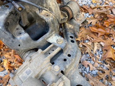

a few more pics today. I didn't get much time on the car but did observe the K-Members are a little different. The 12 has an extra mounting point for the EPAS
