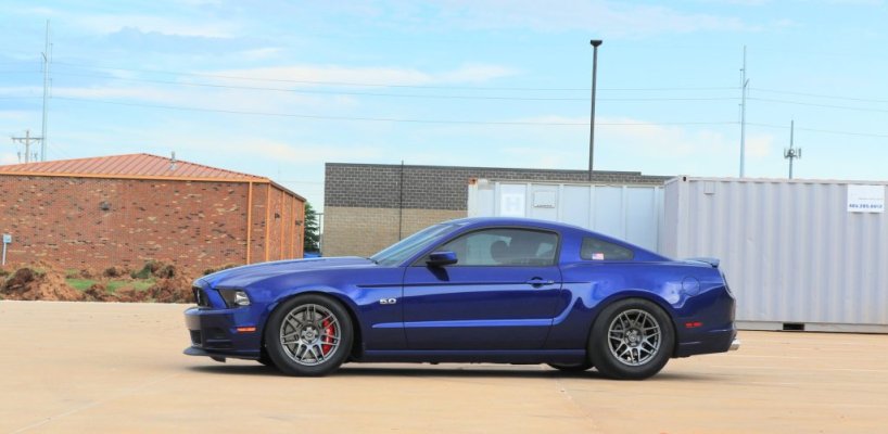

Correct. Depends on the wheel. I have the 6 piston calipers on my car with the GT500 15" rotors and they fit my wheels perfectly fine (daily 20s and my 18" skinnies seen below.)

How did u get 18" skinnies to fit over the 15" rotors ??
My 17" skinnies fit over mine. It's the backspace. The small part of the wheel does not make it to the caliper. And they are forged.
As mentioned, it depends on the design of the wheels. Backspace is important as well as design of the spokes on the wheel...whether they are straight, curved etc. The F14s are perfect in this regard. My car is not a drag car and I was not willing to remove my big brakes.
