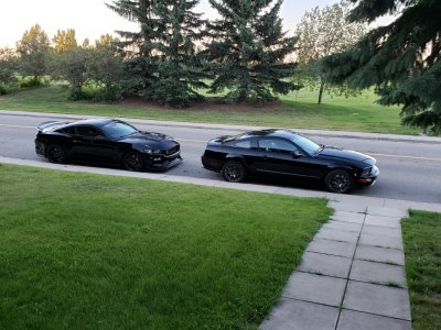

Here's a photo of my car with a big fat boat behind it
