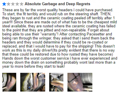

Pentalab
Mar 5, 2013
5,216
1,104
304 stainless steel..then ceramic coat inside and out.
316 stainless steel is marine grade, supposed to be the ultimate in corrosion resistance..... but I have never seen it before. You can get stuff like SS hose clamps etc, in 316 SS. Dunno what else is available in 316.
There is no excuse for the junk in the above pix. 'Warranty' is a joke.
Having the steering shaft go right through, dead center on a primary is fubar. It was never engineered, it was ill conceived.

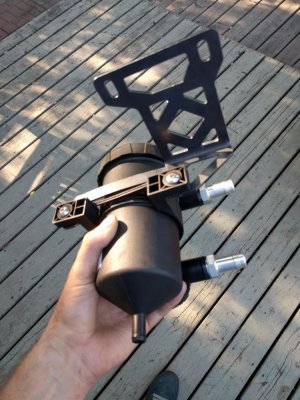

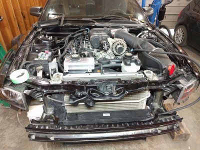

Two months later, tying up the last of the loose ends. I went with a pypes offroad midpipe, painted my headers. Found the only place this provent will fit.

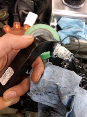

woke up @ 5:30, swapped off the FR500's for my stock bullitt mufflers (man, what a difference.. unreal what mufflers can do.)
Drove her to work. There was a high pitched whine coming from the engine last night, I scoped the acc. drive, cannot imagine what it could be.

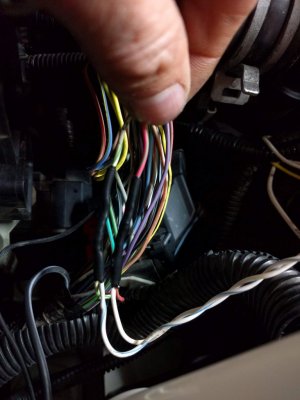

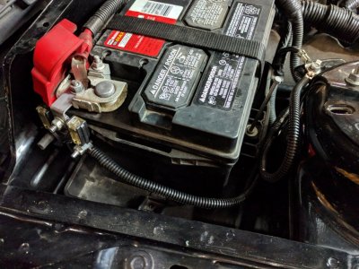

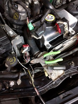

EPAS is working. Split KO power that was going to the intercooler pump relay on my roush harness, sent it to the rack. Squinted hard and cut the can lines to the ECM. Made some nice solder joints. Kind of neat feeling it power up!
I think I'm leaving the car together for the fall/winter, going to break it down early next spring, pressure test the manifold, check it for straightness, figure this vac leak thing out. I may smoke test it before I take it apart. Hopefully do some WOT tuning on Tuesday - weather is just brutal. 45 degrees and rain today and tomorrow.
