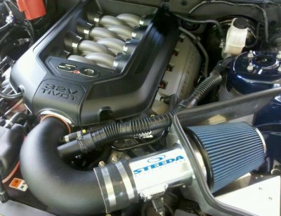

I think just about all of the top tuners " 87, 89, 91, 93 tunes" are probably about the same nowadays. The ones that were making a little more in power in the beginning were leaning the motors out to get more hp than the other guy and deleting knock sensors(which I am sure most have gotten away from this unless it is an in-house car). This is where the majority of #8' issues were coming up. The tuners that run a tad on the rich side may not quite put out the peak numbers as some of the others but actually are safer in this motor. Running an A/F a tad on the rich side aids in the cooling of that #8 piston which has an inherant design flaw in the Coyote motor. I have the Steeda 87 and 93 CAI Inducton tunes. They feel identical and I too question if there is any difference. That being said, the Steeda 93 tune and Cold Air induction that I run turned my car into a beast.
