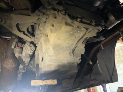

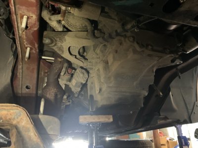

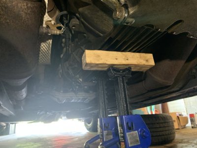

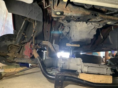

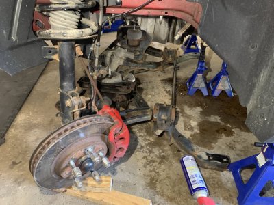

Hey all, I’ve recently brought it upon myself to swap my forever leaking oil pan, after doing some research I decided to drop the entire sub frame. I currently have 2 jack stands under the transmission and would like to take the oil pan off but seeing as the oil pan is also bolted to the transmission could my engine potentially fall if the pan is taken out?28568687-75D1-4BD0-81F8-259B5DB0DED1.jpeg 9342B691-A976-416F-8A44-428362FB474B.jpeg 9EDC3F36-4B79-4C85-8068-03800626DCCF.jpeg A4133098-91C2-4477-8283-2F04E1A6C765.jpeg

Is the only thing holding your motor up the transmission? If so, I wouldn't even crawl under it right now.
