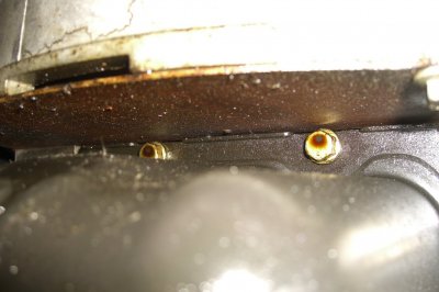

Did oil change today and noticed a medium to bad oil leak dripping from the pan and the transmission plate. (2007 V8 has only 40k miles) I think it will be the rear main seal.
Does anyone has some advice or hint? I will probably do it myself on jack stands but not sure when, I'm in Germany and must import most parts from US.
Is it possible to drive it for additional 1k mi?
Thanks!

You shouldn't have any problem driving the car but I suggest you carry a piece of cardboard to put underneath everywhere you go so you don't drip oil onto the ground, and carry spare oil with you to top the engine up. The biggest problem with a leaking rear main crank seal is the mess it makes.

It may temporarily swell up the seal and slow down the leak, but it may also reduce the lubricating properties of the engine oil and accelerate engine wear.

Here’s the deal, if you don’t get in there and change it soon... then you will need that clutch and a flywheel much sooner. You’re going to be constantly bathing your clutch in oil causing it to slip and burn up. As far as repairs go, it’s pretty straightforward, the right angles, trajectory and A couple wobble extensions and a little jack finesse.

Get it done sooner than later. While you are in there since the trans has to come out put the clutch in now. Save yourself the labor for next time.

You might change your pan gasket and see if the leak stops. It's a lot less work than pulling the transmission and changing the rear main seal.
I agree with other posters that if you drive with a bad rear main seal, you will destroy the clutch. I am not sure whether the 4.6 flywheel bolts extend into the crank case. You should coat the threads with Permatex Thread Sealant with PTFE just in case. A bottle is only about $8.00.

I believe, don’t quote me, but I’ve been told you can drop the oil pan without dropping the k member. For a clutch the LUK is an excellent oem replacement. Don’t expect high performance, but when used as intended it functions as intended. LUK is manufactured in Germany so maybe you can source that from them over there and save yourself a few Euro.

I'm not sure. You can certainly drop the oil pan but you might not be able to get it past the oil pump pick up screen and out of the way without at least lowering the K member an inch or so.
