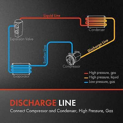

If you are saying it blows cold and you are only experiencing the concern when idling, that is not so much of a concern. Pressures vary in an AC system under load. That is based on air flow through the front of the vehicle going across the condenser.
As the Airflow goes through the condenser it assists in the system breaking the Freon down from a High Pressure Liquid into a Low pressure gas. It does this because when it goes through the expansion valve it changes the Freon to a mist. Imagine a bottle of cleaner. Clearly a liquid, however when sprayed it comes out as a mist. This helps the system remove the heat and humidity out of the cabin of the vehicle allowing it to feel cooler.
Ultimately you can change out the compressor or clutch assembly and have the same result. If this is happening while driving the you have more to investigate.
