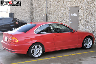

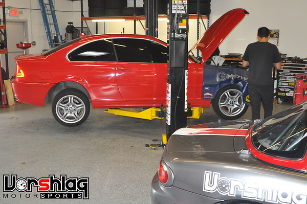

These are two more E46 cars I've owned. The 323i sedan (left) was just a daily. The 330Ci coupe (right) became an autocross/track car
She daily drove the red E46 4 door 323i (above) for about a year, but it was very stock and thus remained very boring. She decided in 2013 that she wanted a "big comfy BMW", so we looked for then found her a clean 2001 740iL. She really liked that 7, but we probably only had passengers in the back seat a half dozen times in 2 years of ownership. Its just the two of us most of the time in any given vehicle, so the gigantic-ness of the long wheelbase 7 series was a waste. Even though we did a lot of repairs, restoration and little upgrades to that 740 at our shop, we don't really make anything unique for the E38 chassis... so it was useless as a "business promotional tool" or test bed for Vorshlag.

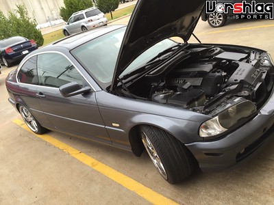

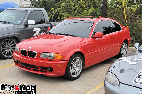

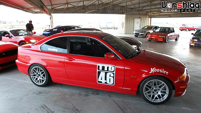

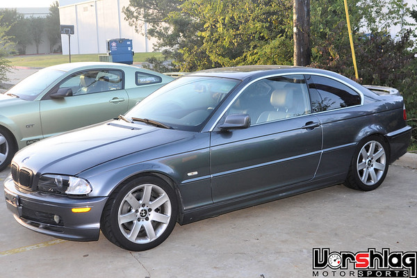

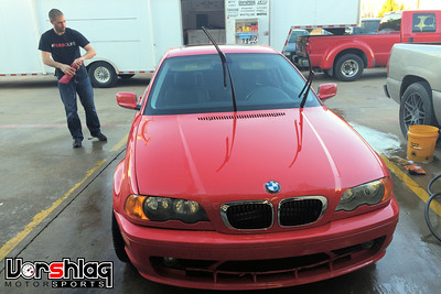

This is our cheap, 197K mile 2002 325Ci project car. Yes, we know, the Foose wheels are Fooking ugly! They will be gone soon
I put a call out on Facebook, and once again was rewarded with a diamond in the rough. A friend that worked at a used car dealer had a lead: 2002 325Ci, 5-speed, 197K miles, $1800. It needed more work than they wanted to invest, so they were willing to let it go cheap to someone who could fix it. Ding! Ding! Ding! We have a winner!
This E46 we just bought is a bit rough around the edges (read below for description of problems) but since we bought it well I'm confident we can fix whatever is wrong with it. I test drove and checked the car out personally and couldn't see any frame damage, rust (Texas car all its life), it had a clear title, and it didn't run like it had a head gasket or oiling system problem (both potential "gotchas" on these cars). Everything else that could be wrong I'm not afraid to fix. Vorshlag has serviced 100's BMWs over the years and we are well versed in most of the problems and fixes of the E46, as well as performance upgrades that help these cars perform better on track and in autocross.
whiskey dent: Dents or scratches on a vehicle due to drinking and driving or hitting an object with your vehicle while intoxicated.

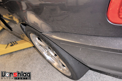

The car has a lot of "whiskey dents", small dings and bumps on the body that don't effect the function of the car, just make it a bit ugly (see the two pics above). It also had a light front end hit and another rear tap, but we will fix those issues as we go. Nothing that prevents it from being a good daily driver. The project name "Jack Daniels" comes from the Whiskey Dents, obviously. No, I don't condone drinking and driving - not hardly - but the name fits. ;)

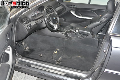

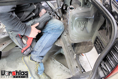

These cars can get light quickly. This car lost 434 pounds in 2 hours (interior removal) and still has all the factory glass and steel!

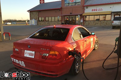

"Do as I say, not as I do." ;) Normally, I warn customers that taking their daily driver and making it ALSO work as their track car is a TERRIBLE idea. It always involves huge compromises that make it a less comfortable daily driver, a heavy/slow/less competitive race car, or both. But this is what SO many people want to do - I'd say half our customers do this! - so why don't we try this "dual purpose build" for once and document what works and what doesn't? Can we win a TT race, or even set a track record, in a REAL DEAL, full interior, air conditioned, daily driven street car? We did it with two BMWs before (below), but that was several years ago - when NASA Time Trial wasn't nearly as competitive as it is today.

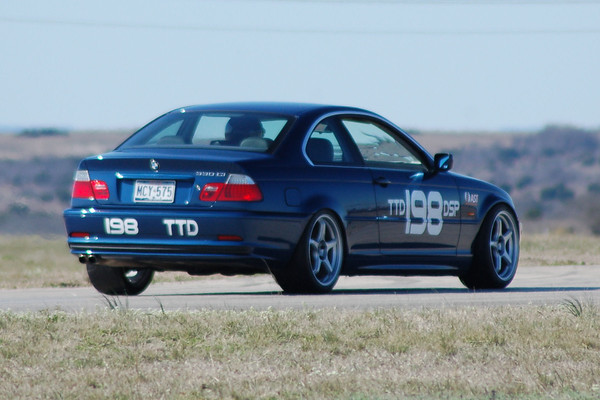

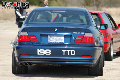

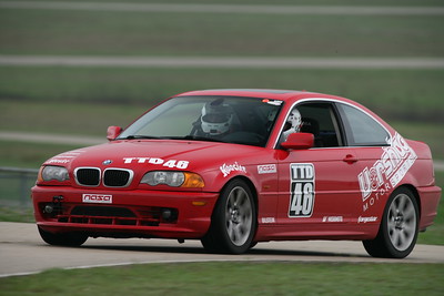

We took both the E46 330 and E36 M3 above to NASA TT wins and a track record each - when both were daily driven at the time

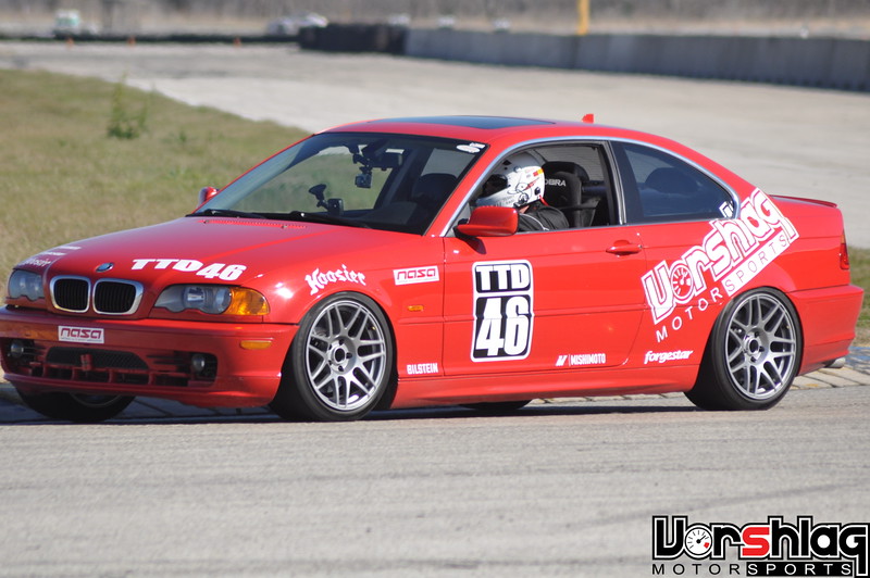

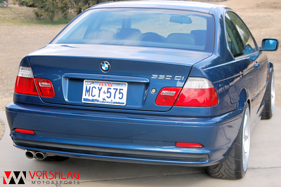

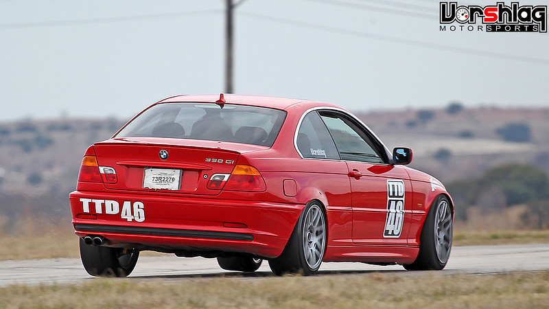

Left: Our flared 2001 E46 330 Coupe on 18x10s and 285/30/18 tires. Right: Our 1997 E36 M3 on 18x10s and 265/35/18s
The weights we've seen for E46 sedans and Coupes that we've owned were all around 3150 pounds, with low fuel and the spare tire + other "trunk junk" removed. That's how people race them so that's how we weigh them. That number isn't that much heavier (100-50 pounds) than an E36 of the same flavor, and the E46 is bigger in every dimension (wheelbase, length and width). The E46 has a more modern look than the E36 2-series, but I have to admit the E36 has a somewhat timeless look.
This 325Ci will get new wheels pretty soon to replace the chrome Foose wheels it came with. When buying a pre-owned car we often have to look past the "initial ugly" or weird mods done by previous owners, and this car had some really ugly wheels on it. They won't be here for long - we're testing some new fitments now and will post the results in the next post to this thread.

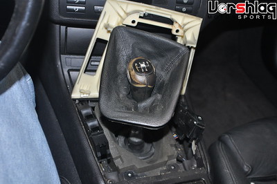

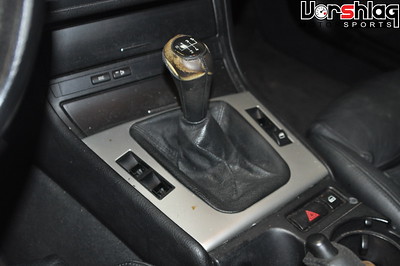

Trust me on this one - stick with the stick! The interior shot and the transmission above were from our 2001 330Ci
Obviously if you want to have fun you should AVOID the automatic transmission cars. The slushbox saps a lot of power and ALL the fun out of an E46, but there are a lot of them out there. Don't think "well I will just swap it to a 5-speed later", because that's a giant pain in the ass to do correctly. Just buy the right car, one already equipped with the manual transmission.
The 5-speed manual (some later 330's got a 6-speed, but don't pay a premium for that box) is pretty dang good, and generally reliable. The clutches have a finite life, as do all of the myriad bushings in the linkages and shifter. I already know we need to refresh all of the shifter parts on this car, but if you go with a solid metal shift handle and especially a lighter flywheel, be ready for some added "buzz" audible in the interior. We'll use some of our Vorshlag competition motor and transmission mounts on this one, too, to really up the NVH factor. ;)

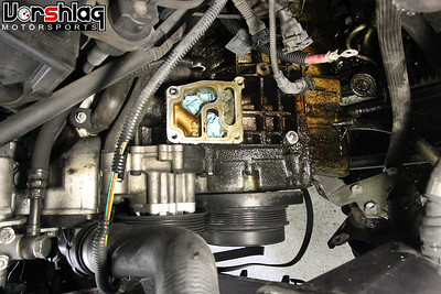

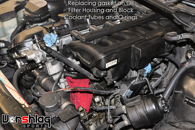

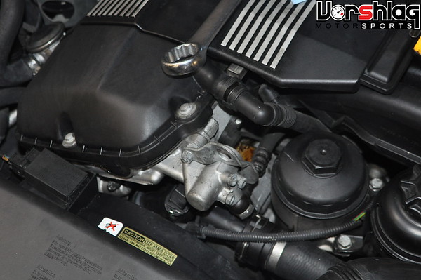

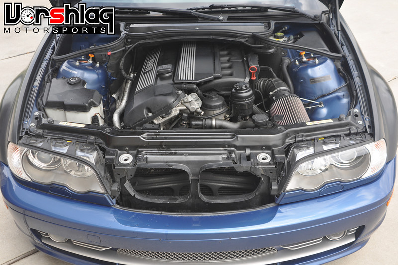

One of the first things you will see on high mileage BMWs is engine oil leaks. They will leak from all sorts of places, but almost always the oil pan and valve cover.
Left: Jack Daniels has a lot of leaks, so we have some work to do. Right: The valve cover gasket repair is pretty straightforward ('01 330Ci)
The gaskets get hard and brittle over time, then start to leak. The gasket parts aren't expensive to buy, and the valve cover gasket service on the top end is fairly easy to do at home with basic tools. Order spark plugs at the same time, as these have to come off to do the valve cover work. And make sure to get all 15 seals for every valve cover bolt. The oil pan gasket service is a REAL pain, though, and I'll show what it takes to do in a future installment on this 325Ci. When you do the oil pan gasket repair, you might want to think about: welding the oil pump driveshaft nut, replacing the oil pump/driveshaft/sprocket, and maybe even adding an oil pan baffle kit - if you plan on tracking the car, like we will.
We swapped in new seals for the dual VANOS on the 2001 330Ci (above) and it fixed some issues on that car
The VANOS units on the camshafts (variable valve timing controllers) tend to be "done" after 100-150K miles. There are seal kits (above right) and they are serviceable, but be careful. Don't forget that the VANOS bolts are LEFT hand thread. Swapping in rebuilt VANOS units is much trickier, and requires special tools and fixtures. Look for DIY write-ups online for this. There are several suppliers for seal kits and rebuilt VANOS units (Dr. Vanos is the more famous option). When the VANOS units are bad the variable cam timing doesn't work, and the motor feels more sluggish than normal.

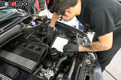

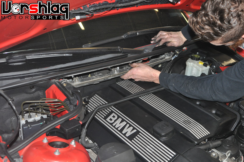

FIRST REPAIRS - COOLING SYSTEM REPLACEMENT + ENGINE BAY CLEAN
When I test drove this car it was leaking coolant from more than one spot, and the electric cooling fan wasn't working. They had the radiator cap loose and told me to keep the test drive short. It was at a dealership who had a mechanic on staff, but it looked like they threw their hands up and just wanted to dump the car. I drove it around for a couple of minutes and it felt "OK" to me. No working cooling fan means no Air Conditioning and no chance I could drive it home in traffic. It didn't look like it had a blown head gasket so I took a gamble, bought the car, and towed it to the shop with our enclosed trailer...
I was nervous about the AC and cooling system - would this be an easy fix or not?? So the day I bought the car I had Olof do an typical "track inspection" to the car and make a list of visible issues. It was a long list.
- Thoroughly inspect car (top to bottom, front to back)
- Diagnose fan problem; won't run with direct power
- Lubed upper radiator hose; now system will pressurize but leak slowly

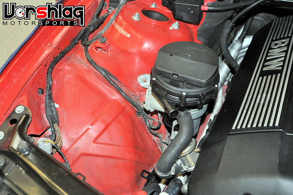

- Can hear audible sound engine bay (exhaust leak? air pump bad?)
- Perform compression test. Looks good.
- Scanned CEL : Cyl 3 misfire. Cleared code.
- New code appeared. P0365: Camshaft Position Sensor B Circuit (Bank 1)
Pressure testing the cooling system showed a myriad of leaks (above)
It took 2.08 hours to do the inspections, fan test, cooling system pressure check (leaks everywhere!), and engine compression test - all of the work listed above. The compression test was good, which let me know we probably did NOT have a bad head gasket. The coolant system had leaks from the water pump, upper hose junction at the radiator neck, and the coolant reservoir, but the radiator hoses themselves looked new.

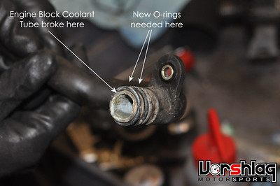

The radiator hoses are normally an instant repair item, as the "quick connect" ends on the E46 get stuck over time and can easily break trying to disconnect them. Olof soaked the junctions with WD40 before taking them off and they popped free easily, and looked perfect inside and at the ends (O-ring). No massive corrosion or deposits. The electric cooling fan was tested off the car; even though it looked pretty new, when fed 12V power at the right ports it wouldn't work. So maybe all of the cooling/AC issues really were just a bad fan and a couple of leaks? Could we get that lucky???
We ordered a new OEM radiator (which might be replaced later with a larger capacity all-aluminum unit), coolant reservoir/cap/sensor, electric fan, water pump, and plastic thermostat housing + thermostat. Shopped around a bit, so it took a couple of days to get the parts in. It was around $400 retail in parts. When they had all arrived, Olof drained the coolant, quickly removed the old parts, cleaned up the mounting surface on the block for the pump, and swapped in the new bits. It was exactly 7 days after buying the car when he did the work, and it took him an additional 2.52 hours to replace the entire cooling system, start to finish. And luckily these parts fixed ALL of the cooling issues, and the AC now worked perfectly. So my gamble paid off.
- R&R radiator, expansion tank, water pump, thermostat, and coolant (mostly water)
- All old gaskets are damaged from corrosion of aluminum and coolant
- Add coolant and water mix
- Pressure test cooling system (no leaks)
- Test drive and verify fan turns on, AC works, engine runs fine

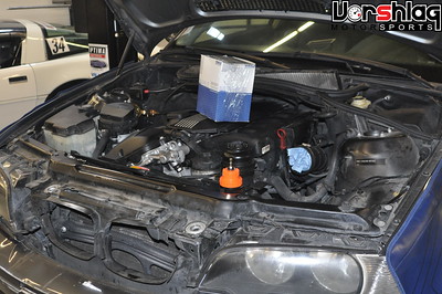

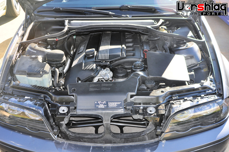

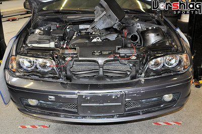

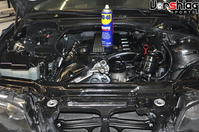

While he was removing the parts and before the new bits went in I sprayed the entire engine bay down with WD40. We let it soak while at lunch and Olof wiped all the surfaces down when we got back. This stuff is harmless to almost every material and will loosen gunk and grime, and it worked like a charm. Normally I'd pressure wash the engine bay but this car didn't need it - the dealership had done that, apparently (not the previous owner, who had really let a lot of things go). Just had some old gunk stuck to an otherwise clean-ish engine bay. The WD40 + wipe down made it look pretty darned good...
Engine bay now looks good, but did you notice the wires holding the headlights in place? And the cloudy lenses?
Now the 325 has a brand new cooling system (doesn't leak a drop of coolant) and the engine bay is pretty darned clean - doesn't look like it has 197K miles now. I love clean engine bays, and we will get the car up on all fours and power wash underneath the entire chassis soon. A clean chassis shows any leaks perfectly, and I'm sure there are plenty left to track down (engine oil, etc). But the emergency stuff - a bum cooling system - was fixed, which was a good first step.

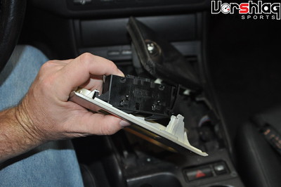

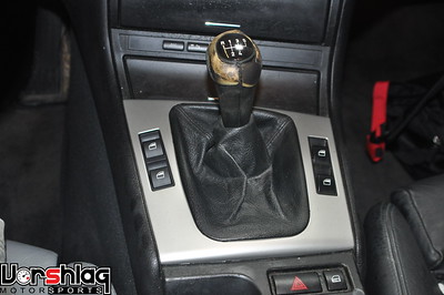

Both the left and ride side window switches (above left) had one or more broken "tabs", so the windows wouldn't go up or down. Luckily the "endurance car" ('99 328i) is getting all of the OEM door and rear glass replaced (with fixed Lexan), so I borrowed that car's console mounted window switches (below left) temporarily to test and see if this 325's window regulators even worked. This is a super easy job: pop the leather shift boot up (see above right), then unscrew two Phillips screws at the back, and the shift cover comes out for easy access.
The E46 sedan has the same passenger side window switch, which popped right into the slot in the shift cover and plugged into the wiring harness. Both the right side door and rear quarter glass power action worked, whew. The driver's side switch also plugged in and everything again worked, but the "child lock" button for the rear window control lock-outs (not included on the Coupe) makes the switch housing too long to fit the slot on the Coupe's shifter cover (below right).
Left: The switches are held in "hook" at one end and snap into the other end. Right: The left side Sedan window switch is too long
As you can see (below) the replacement window switches aren't expensive, and this is a super common thing to be broken on an E46 - the little individual window switch "paddles" snap and break off. I found some under the seat when we swapped that out (below).
After I tested that the two door windows and two rear quarter windows worked with the borrowed E46 Sedan window switches, we ordered the correct switch for the driver's side for an E46 Coupe. There's a third variation for the Convertible as well. Confused yet? Welcome to German cars. :)
The correct part (BMW p/n: 61316902175) showed up a few hours later from our BMW dealer. I then popped the cover out again and swapped in the correct switch, for a completed job with the right parts. This is a 5-10 minute job at most, and we spent less than $45 to fix it. Easy.

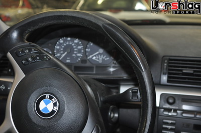

This car was a Premium car, with Harmon Kardon stereo and power leather seats on both sides - when new this was a high end car, but time takes it's toll. Both front seats were both torn/worn/ripped at a couple of leather seams, and the fore-aft power actuator on the driver's seat was broken. Luckily the seat was stuck where it fit my driving position (so Olof and I could do our initial test drives to prove the cooling system repairs) but it didn't fit Amy, so she couldn't drive it.

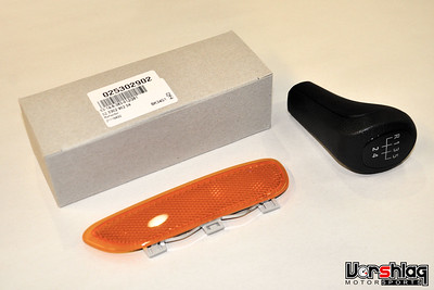

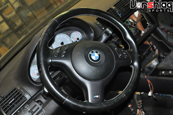

The worst part of Jack Daniel's interior are the shift handle (see pic above), front seats (torn) and the steering wheel cover (worn).

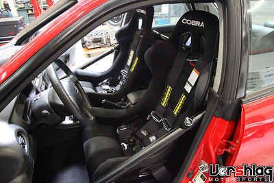

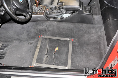

Long term plans include installing two fixed back racing seats with a driver's side slider, and make it fit Amy's driving position perfectly. The seating position really makes or breaks a track car for her. With too many unknowns left to check on this car before we go dumping expensive racing seats into it, for the short term I once again borrowed parts from the Endurance car car. The power front drivers seat from the 99 328i Sedan was pretty ugly but the power actuators all worked, so I just had hoped it would fit the Coupe...

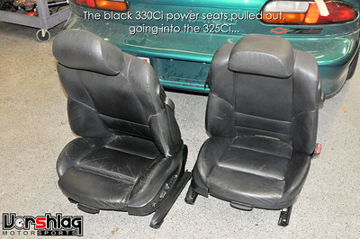

Reduce. Recycle. Re-use. We're keeping it green on Jack Daniels by "borrowing" the front seat from the 328i
The stock seats in the Sedan were in pretty rough shape but I just wanted something functional to use temporarily until I could either find some NICE black leather factory E46 seats or until I could convince Amy to just let me install some of the dozen or so racing seats sitting in our lobby... She's thinking "daily driver" while I'm always thinking "race car", heh.

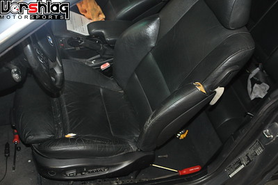

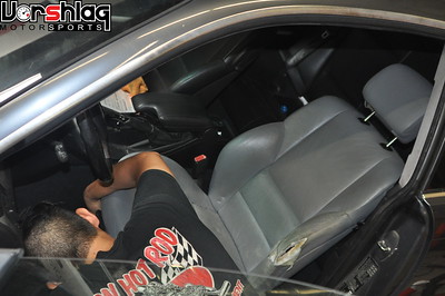

Since the 325's driver's side power seat was dead, the seat was "stuck" in a weird spot. This made access to the old seat's 4 mounting bolts tricky. The front bolts were easy to get out but the rears were half covered up, but Olof fought it and got it unbolted, then we tossed the dead seat out back. The recyclers grabbed it before I had a chance to weigh it, but its one heavy mug. We will weigh the Sedan's power seat when we take it out next time.
Oh there was some nasty junk hidden under that seat (retch!)... sticky coins, a dirty comb, fossilized french fries, plus all sorts of crumbs and soda spills. Olof got all of the left side carpets vacuumed and shampoo'd quickly and it looked 100 times better. The other side was strangely clean and Amy vacuumed that side out a few days later, when I cleaned all of the leather, vinyl and plastics on the weekend.
The 328i Sedan seat is ugly (grey) but the power functions works, so its being used for now
The '99 328i Sedan driver's power seat bolted in easily enough. The plug for the seat was correct and everything worked, but its now throwing a "seat belt" code, so there must be a wiring difference internally. It does not have the "tilt forward and up" back seat access feature of the Coupe's front seats, but oh well. The ugly gray leather Sedan seat will work for now, as all power functions operate, but its temporary. We will get race seats in here...

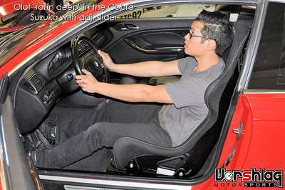

These are the Cobra seats and Momo wheel we used in the '01 330Ci, and they are what we will likely use in this 325Ci... soon?
All told this seat swap and half carpet clean-up took about 0.5 hours and cost $0 in parts (borrowed seat).

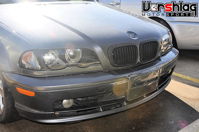

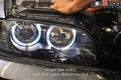

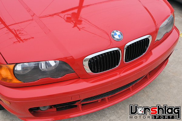

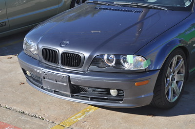

This 325Ci needs new headlights to pass inspection, as the original units were both damaged in a light front end hit at some point. The housings are all busted up, the lenses are cloudy, and they are held in with bailing wire. I have done a LOT of looking (there are a lot of variations between the Coupe/Sedan/M3, with pre-facelift and post-facelift for the coupe and sedan) and found some ~$200/pair OEM looking halogen projector style light assemblies, which I have on order. Will get those in the car pretty soon, then try to chase down the last CEL (Cam Sensor is a common flaw on the M54) so it will hopefully pass inspection.

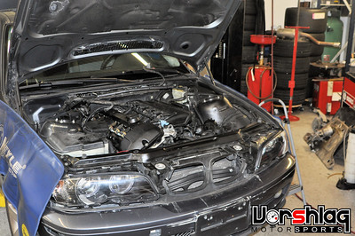

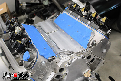

Ryan made custom full length headers for this LS3 V8 in a tick over two days... why not make a better E46 header than what eBay sells?
After that we need to tackle the exhaust, as the rear muffler hanger is gone and it has a good exhaust leak behind one catalyst in one manifold assembly. I really DO NOT want to buy $800+ worth of factory style replacement manifolds/catalysts, so we might fabricate something there. I'm most definitely NOT buying the crappy eBay header for this car, like the blue 330Ci got (two sets were purchased for that car, to get something that fit). Should we make a new, proper full length header for the M54? Is there a market for this, when the $100 eBay junk has been the standard for some time? I'm going to do a business case for this and see - it wouldn't be that hard to make, with our in-house fabricators.
Once we determine the header solution, the after-header exhaust will be custom made from 3" stainless tubing and Magnaflow mufflers and cats, when it gets replaced. We've done a system like this before (blue '01 330Ci syste, shown above) but since then we had a development break-through and have picked up BIG numbers while becoming quieter. There's a muffler from Magnaflow that made that happen, along with an unusual routing. We could see if that worked on this car, with the full length header. Very tempting, and it could make for a new product - which is why I pushed Amy towards another E46 in the first place. This car has to DO WORK FOR VORSHLAG.

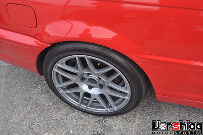

One possible track setup is this 18x10" wheel + 265/35/18, which we did to the '01 330Ci (pre-flares)
Replacing the wheels and tires are a VERY high priority, and as I mentioned above I hate the Foose wheels with a passion, and after Amy's first long test drive one of the tires got really low on air pressure. I'm looking at 17x9.5" Forgestar F14s for street wheel set first (see below), with a better offset made exclusively for the E46 non-M - with no spacers needed. We have done 18x9 and even 18x10 (above) before, but they all needed spacers and the 10's needed LOTS of fender rolling and camber to fit. Even then we were limited to 265s on the rear, until we flared the 330. We'll tackle something similar for track use (depending on which class we go to, which might limit tire choices/mod points). This car has a base NASA TT class of TTF, so we still have a lot of "mod points" to play with in TTD or TTE.

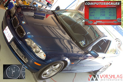

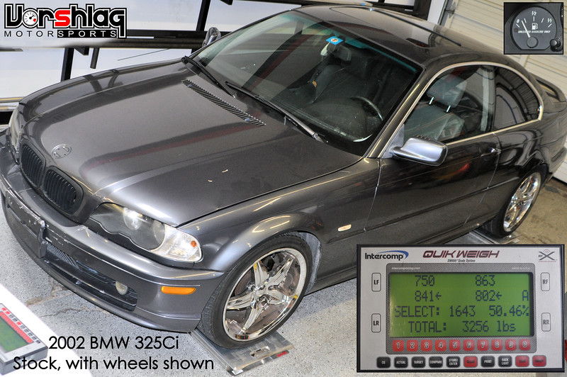

This was a weight we took with low fuel but the full sized spare, jack and other trunk junk were still in place
Last but not least, no build thread of mine would be complete without the initial weighing! We were in a hurry so we didn't take out the spare wheel/tire or the jack. This porker came in at 3256 pounds, but considering the trunk junk and what these Foose anchors weigh, I shouldn't be surprised. We will knock the weight down by around 200 pounds, I can assure you of that. (base classing: BMW 325 ('01-'06) (2.5L184 hp) = TTF**, min wt 3197 pounds w/ driver) This 325Ci one will be kept for a while, and Amy is already driving it to work, so we will have some fun with this one. Check back next time to see a few more repairs and hopefully some upgrades!

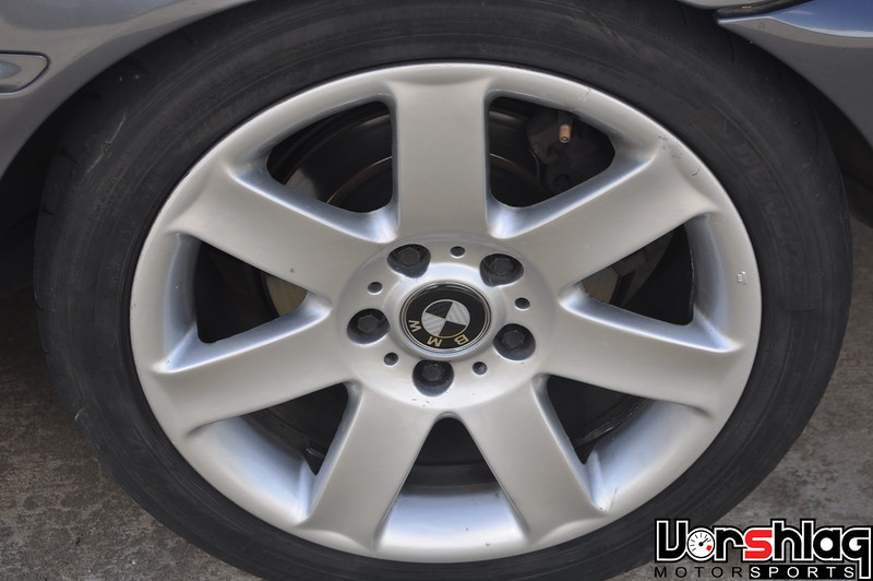

At this point I had already fixed a leaking tire by stealing two of the E46 sedan wheels/tires

The original headlights are really busted up and don't work (one was unplugged, the rest of the bulbs were burned out), the turn signals don't work up front, we found that the horn doesn't work (and I use a horn like a NYC taxi cab driver), the exhaust leak seemed to be getting worse, there was a terrible "shimmy" at highway speeds, and one of the tires kept leaking down. I couldn't stand looking at the flippin' Foose wheels any longer, too, so we found a temporary wheel and tire solution that fixed a couple of problems.

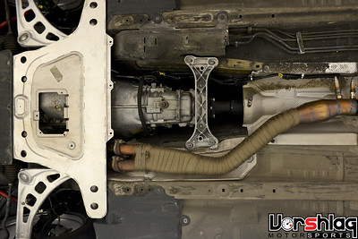

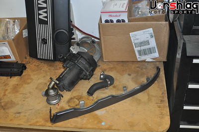

We knew there was a leak in one of the factory exhaust manifolds but it seemed to be getting louder. I drove the E46 to work a couple of times and it was beyond my level of acceptable annoyance, so I went looking for a replacement set. Problem is these manifolds also include the catalyst, and each one (there is a pair) are $300-450/each new. No way was I spending $900 on new exhaust manifolds that looked and performed as poorly as the OEM units did!
The right flange could be wiggled more than an inch once it was detached at the rear. Straight busted!
I really wanted to just get the car inspected, then get a baseline dyno pull done on the stock manifolds/stock exhaust, then try some proper racing headers. We actually have a couple of things we want to test first, but I'll get to that later. So I went looking for some used M54 manifolds, and the guys at Clown Shoe Motorsports had a pair they sold me cheap ($100 = scrap value). Thanks guys!
Left: Old exhaust manifolds were oily and one was broken in half. Right: New exhaust gasket set
After I had picked those up Steve order the gaskets, and we put the E46 back onto our shop schedule on Friday, September 4th. Olof got the car on the lift and when he pulled the aft portion of the exhaust system off, he came and got me from my office. He showed me how busted one of the manifolds really was and we laughed pretty loudly. Check the video below to see what I mean...
Click above for a short video walk-around during this round of repairs
So yea, the rear manifold was broken at the junction to the catalyst, and the only thing that was keeping the rear section of the manifold from falling out of the car was the heat shield. Good grief, that's bad. Of course the manifolds were also covered in oil, as this engine still has a wicked valve cover leak. We'll tackle ALL of the oil leaks at once, next time. I have a reason why we're waiting.
The replacement manifold set (above) was far from new, and had almost as many miles (190K), but they came off a similar car that was NOT throwing a CEL - which is a good sign. Olof got these installed with new exhaust gaskets at the cylinder head and the rear exhaust, plus added a new rear exhaust hanger we picked up from BMW. Now the car had a working, factory stock exhaust with no leaks. Yay.
4.58 hours were spent on this exhaust job, but some of the studs and nuts fought coming off - even when soaked in penetrant. 197,000 miles of use means these parts have seen a lot of heat cycles. Getting the manifolds out of the engine bay requires securing the engine at the top (hanging it from a bar), removing the passenger side motor mount and stand, removing the entire exhaust system, then fighting with the little fiddly nuts and exhaust studs on the cylinder head. Olof removed all of those studs (to be able to clean the exhaust gasket surface properly) and cleaned them up off the car, as they were pretty crusty. Should have just ordered replacement studs and nuts, oh well. At the time of this writing I hadn't driven the car yet... hopefully these used manifolds don't suck.
Exhaust system repaired with replacement factory E46 manifolds + new rear exhaust hanger

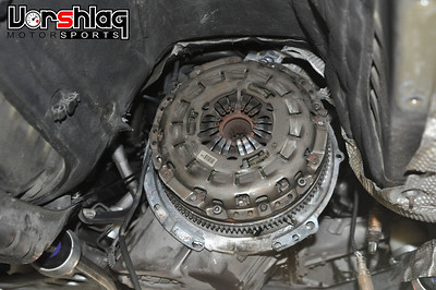

DRIVELINE REPAIRS

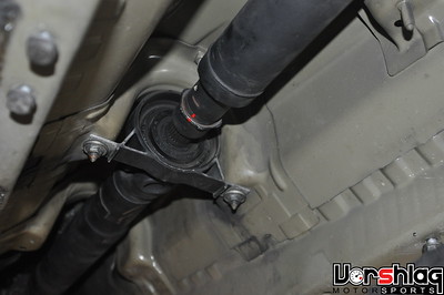

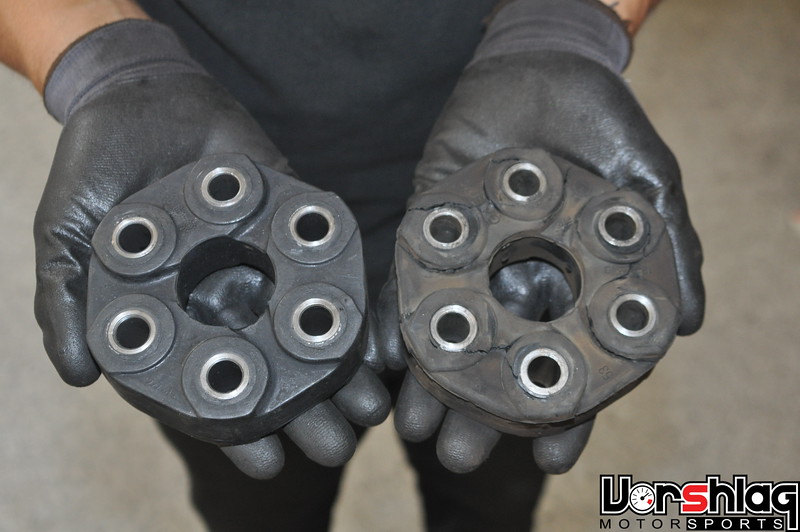

Both the guibo and the center bearing on the stock 2-piece driveshaft needed some attention, and with the exhaust off it was much easier to get to these parts this time around. Olof had noted the cracks in the "flex disc" that attaches the driveshaft to the transmission last time, and now was a good time to fix that.
These are a common failure item and virtually all BMWs have to replace these over time. As you can see below, the old unit had a lot of cracks in it, but I've seen much worse. They tend to crack, then fibers start to come apart and they slowly explode over long enough time period. It is usually very visible to any mechanic that is looking under the car before it lets go. This is a $35-60 part to buy new.
Another strange thing that he found when he was looking at the driveshaft was aft of the center support bearing. Someone had replaced the center bearing recently (another common wear item on all BMWs), as it looked new. But whoever did the work somehow left a threaded cap for the rear section of the driveshaft loose? This needed to be lock-tited and tightened to reduce the chance of it coming apart and tearing the threads of the shaft up.
Left: You can see the threaded cap that is loose in this picture. Right: It has been secured, loctite added, and a stripe paint marked
Olof got both the Guibo replaced and the center bearing screw-on cap re-attached in .59 hours, which was quicker than normal because the exhaust was already out of the way for the manifold work.

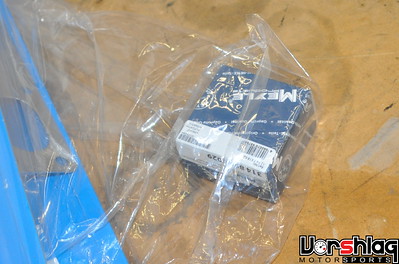

CAM SENSOR REPLACEMENT
This M54B25 has variable valve timing on both the intake and exhaust valves. This means it needs two separate cam position sensors. As I mentioned in the first post, this car kept throwing a Check Engine Light (CEL), which turned out to be the position sensor on the exhaust camshaft. This is a ~$40 part that takes very little time to replace.
Steve sourced a new Meyle cam position sensor (above left) and then Olof took .28 hours to replace it (above right). We will see if that's the last of the CEL problems on this car. The E46 is known for having some tricky to diagnose CEL issues, so I'm not holding my breath just yet. As long as it stays off long enough to pass inspection, we're good for now.
HEADLIGHT REPAIR & UPGRADE
In our first round of repairs we noted that the headlights were all jacked up (technical term). The lenses were cloudy, the housings were busted up, the mounting tabs were broken off, and they didn't work at all. This car had obviously been in a light front end collision and the headlights took the brunt of the damage. The hood is also tweaked and front bumper cover is beat up - both need to be replaced eventually.
Since most of the pictures I took last time were from my cell phone (aka: #potatocam), the crappiness of the headlights is hard to see. But trust me - they were smashed up and the lenses were cloudy, so they had to be replaced.
Click on the images above to see how cloudy the lenses were, and the right pic has a "new vs old" shot that really shows the difference
The old headlights are shown above, and after the bailing wires attaching them to the chassis (?!) were cut, they were easily removed. The corner lights were literally falling out and had been held in with tape. What a mess - these were just junk. Yes, you can buy new replacement clear lenses, and even replacement parts for some of the busted black plastic on the housings, but its easier and cheaper to just replace the entire assembly.
These replacements still have protective packing film stuck onto the headlight lenses
There are tons of OEM replacement options from the normal suppliers (Depo, Hella, etc), but I wanted something better here. Time for a slight upgrade, instead of just a boring "stock replacement" repair. I researched this a bit and found the correct pair of projector style housings shown above. And I bought them from my least favorite source - FleaBay - and they are made in Taiwan. To avoid the known reliability issues with cheap Chinese Xenon lights, I went with the basic halogen bulb assemblies.
Left: Olof needed to brush up on his Cantonese to read these instructions. Right: Some small crash damage made headlight install tricky
This pair has internal projector lenses for the (outer) low beams, and "angle eye" LED halo rings around both the high and low beam bulbs. The internal housings (the area behind the lenses and bulbs) often come in "chrome" as well as the factory style "black", but I kept it simple and went with black (the chrome was too blingy for my taste). This kit came with matching parking/turn signal housings, which have a smoked clear lens, not orange tinted lenses like some early E46 OEM options.
There are a ridiculous number of factory E46 headlight options (see above), with changes for Coupes and Sedans based on their pre- and post-facelifts (2004 for Coupe, 2002 for Sedan, the M3 was never facelifted), plus the E46 Compact (the 3-door hatchback, which we never got in the USA). Some came with Halogens others Xenons, some models had projector lights others did not, and they came with and without headlight washers. The shape of the headlight assemblies dips into the front fenders and bumper covers as well. The facelift extended out back with unique bumper covers and taillights as well. Since the 2001-06 BMW 325 is all on the same base classing line for NASA TT, we could do the facelifted fenders, hood, lights, and all of that and be legal - if we cared. Luckily we don't. If it doesn't make an impact on daily driver use or track times, we aren't doing it. If you care about this stuff, this video shows an early E46 Sedan/Wagon with the details to do the full "Facelift" upgrade.

My old blue 2001 E46 330 Coupe (above) was a Canadian car, and it came with a KPH speedometer and factory projector style lights and headlight washers, whereas this 2002 325 Coupe had regular non-projector lights and no headlight washers - and these are both pre-facelifted Coupes only one model year apart. There are lots of OEM headlight variations, and I don't know when all the changes were. Throw in the aftermarket headlight options, and you can lose hours chasing down all of the options, costs, reviews, and sources.
There was extra wiring required to power the halos, which we used a fuse tap to power from an "ignition on" source. While we were first testing the lights one of the LEDs on the LF headlight halo burned out, but hey, that's Taiwan parts for ya.
The rest of the install was fairly painless, and the low and high beam connectors plugged right into the original harness. There were some fitment problems but we traced that down to front end crash damage. Upon closer inspection (see below) it appears that the radiator support is tweaked on both sides, especially the Left Front. So that headlight mounting hole isn't used for now. We will order a new bolt-in upper radiator support soon and put that in, but since the whole damned front end has to come off to get to all the bolts for this brace, we will wait until the new harmonic balancer is here, which needs lots of access to remove it (read more about that below).
Again, these new Taiwan special angel-eye projector style headlights came with new bulbs and corner lights, ready to bolt in, for $210 delivered. Hard to beat that price, and with regular OEM headlight replacements at $240-600/pair, non-projector, and without new corner lights... I went with the cheaper Taiwan specials. I might regret this in short order - one LED burned out in the first minute of use - so I will follow up here about long term use results.
The RF headlight "lower trim panel" (above right) was also shattered in the front end hit, so we had to track one of those down. The LF trim piece was fine (above left) Again, lots of options due to the many changes in headlight shapes and headlight washers. A new RF trim piece was ordered from BMW and the unpainted part was about $35. We will repaint this piece body color and install BOTH lower trim pieces AFTER we figure out what to do with replacing the torn up front bumper cover (M3 vs 325Ci bits) and/or front fenders (M3 or leave stock). The bumper cover is sufficiently misaligned that the new headlights and lower trim pieces don't fit together, at the moment.
In full daylight you can see the front end damage - it still needs a new bumper cover, lower headlight trim and side marker light
All told Olof spent 2.94 hours replacing these headlights, wiring in the halos, and repairing the shredded horn system wiring. It would have been a much quicker install if these had been just plain jane OEM replacement lights (no halo wiring) and if the front end wasn't tweaked like it is.
TEMPORARY STREET WHEELS AND TIRES
This wasn't at all what I had envisioned for the final street wheel and tire set, but a giant bolt sticking through one of the 325 Coupe's tires forced a quick if temporary wheel and tire upgrade. And those Foose wheels... wow, they were ugly. Glad those are off the car.
Once again I went to the shop Endurance race car E46 sedan to "borrow" some parts, namely the wheels and tires. When we bought this 1999 328i from a fellow racer in Austin it had the original 17x7" 7 spoke "style 44" cast aluminum wheels, which were in decent shape. The tires were all 245/40/17 sized rubber in the Dunlop Direzza ZII Star Spec model. The rear Dunlops were B-A-L-D but the fronts had some tread left (the shoulders were worn off). The owner of that car autocrossed it in Street class and these tires were the go-to option back then. 245mm is about all you'd want on a 7" wide wheel, and the compound was good.
I found this $10 set of 7 aftermarket "carbon fibre" Roundels, including the four 68mm center caps
So I figured we could put these on the front temporarily until we decided what to do about the permanent street and race sets of wheels. But upon closer examination the remaining rear tires on the Foose wheels were 18" diameter, dry rotted, and some nasty "Nexen" (?!) brand. And they were mounted to these hideous Foose eye sores. Amy liked the Style 44s well enough so we went ahead and bought 4 new Dunlops in 245/40/17 and we will use those on this car - temporarily. They WILL go back on the Endurance race car and will likely be used on the initial track shake-down events for the team. Thanks to UPS never delivering on time, these were not here by the time I published this update (4 days late and counting, UPS).
I still want to go with a 17x9.5" Forgestar F14 for the street wheel sets, and either another set of those or 18x9.5" wheels for the final Hoosier set for TT... but we are still working out the final TT letter class build plan. The time it takes to have a set of Forgestars custom built (4-6+ weeks) is longer than we can wait for now, so these Sedan wheels will work in the short term - and remove the ugliest part of Jack Daniels, the Foostasticly chrome blingstars. Check our clearance page to see these things for sale, if you have incredibly bad taste. ;)

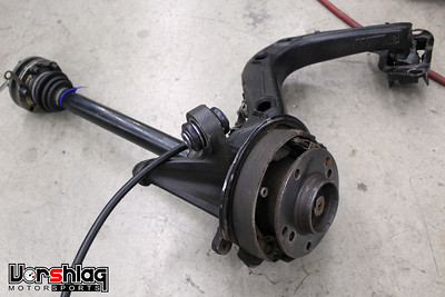

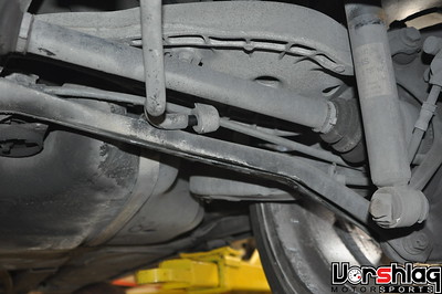

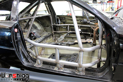

The original rear lateral lower control arms were likely bent by some wrecker driver (they reach under the car to hook their chains and these arms seem like an easy, if stupid, place to tie down a car), which is a common occurrence on BMW E36 and E46 cars. I thought briefly about an adjustable, tubular lower lateral arm, which we have used in the past on other E46 builds... but the TT mod points (+4) were just not worth it. So the bent lower arms needed to be replaced with OEM parts.
I learned a lot this past year with our TTC prepped 1992 Corvette, and when the TT rules say you can replace a suspension part with a new "stock replacement" part, it really means it needs to be the exact same part, brand, and part number as the factory installed. So I had Steve do some searching and he found the correct Lemforder (the original manufacturer for most BMW suspension parts) rear lower lateral control arms for about $45 each, shown below.
These control arms went in relatively painlessly and Olof knocked it out in .95 hours. We could have saved $90 and stolen the 2001 330 Coupe's original lateral arms, as they are identical, but with the new parts so cheap it was worth it to get the new arms. There's a bushing on the inboard side that does wear, so these new arms will refresh that. Trying to re-use old, used parts almost always turns out to be a bad idea.

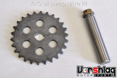

I still stand by the comment I have made many times: "The M54 has a terrible oil pump design", because it is the truth. We were also revving the stock M54B30 engine to over 7500 rpm (after a local tuner raised the redline for us), in an effort to minimize shifting to 3rd gear on typical autocross courses. Also a mistake. And we were doing this (unknowingly) with a "slipped" OEM harmonic balancer the entire time, along with a flywheel that was half the weight of the stock unit. I also knew better than to not tack weld the oil pump nut in place, but was lazy and didn't do it either.
The chain driven oil pump drive shaft retaining nut can fall off or the shaft can shear clean through, both of which makes the oil pump stop working
All of those mistakes - which were 100% on me - made for an epic fail. Yes, I killed the oil pump drive on that M54 - twice - which quickly wiped out the rod bearings both times. If you need to send some more "I told ya so's", just PM me, and but please don't crap up this thread with more of that. I won't make those same mistakes again. The first oil pump setup on my old 330 was bone stock, with the nut just screwed onto the oil pump drive shaft at the factory (the nut came loose). The second failure was after we replaced the oil pump + shaft and had tack welded the nut in place (it sheared the shaft off). Both of those failures caused the chain driven oil pump to stop working, and the clack-clack-clack of the bottom end knocks started very quickly.
After those two failures with the original M54 engine, we sourced a stock, low mileage 2005 BMW 330 M54 engine (which itself had a slipped balancer at only 54K miles) and swapped that in before we sold the car. We also lowered the rev limit back to the stock 6500 rpm level, added a brand new OEM harmonic balancer, and a VAC heavy duty oil pump driveshaft and sprocket when it was going in, and tack welded nut to that as well - which is probably why its still intact to this day.
This is what I consider to be the minimum track prep for an M54 engine: new balancer + VAC oil pump drive + tack weld the nut to the shaft. That 330 Coupe has been running smoothly since this replacement motor + new harmonic balancer + VAC oil pump drive work was done in 2011, and has been tracked several times a month by the new owner since we sold it in early 2013. Zero engine issues.
Lesson learned: M54 oil pump drives are problematic, and high RPMs tend to kill them earlier than normal.

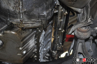

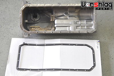

When we replace the oil pan gasket we will also add the VAC oil pan baffle kit, as shown above
The leaking oil pan gasket leads me to my next upgrade planned - a new oil pump, an upgraded VAC oil pump drive/welded nut, and adding a VAC oil pan baffle kit. These are super important for these M54 motors, and we have done these baffle installs for customers in the years since I had my "bad experiences" with my first M54 powered BMW. Maybe I'm paranoid, but I won't make the same mistakes again, and we will go overboard on oil system upgrades on this car.

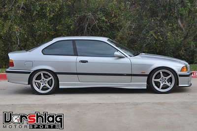

What is still strange to me is how well the S52 (above left) engine did in our 1997 M3. We ran it in at least 100+ autocrosses, often with 3 drivers per day (me, Amy, and the previous car's owner) and always touching the 7500 RPM redline, for over 6 years. All that was done was a welded stock oil pump nut to the shaft. That's it. Stock balancer, stock 100K+ mile engine, and it was tracked several times during that period as well. It has the same, goofy chain driven oil pump as the M54, too. Maybe the E36 M3 engine just had some better mojo than the non-M E46 engine? Again, I think these oil pump issues were more "old balancer failure" related than just "oil pump drive" or "too many RPMs" related. But I'm not taking any chances....

I have been alluding to prepping this car for a NASA Time Trial class, and there are a number of choices we can make now that effect the build down the road. Do we want a "BIG" tire with no aero, or a narrower tire with aero added? Our 2001 330Ci was built around a 285 tire and stock aero, and it did all right - but that was back in 2010. And the work required to fit those tires (flares) was extensive...
Do we want to stick with the 325's M54B25 engine or go to the more powerful M54B30 from the 330? What about the larger 330 brakes? We can convert this car to a real 330 fairly easily - we have a 330 in the shop that could donate the front and rear brakes, the engine is an easy internet search + a day of labor to swap, etc. But the engine swap is not likely to happen, because it would require more parts to be swapped to be considered a "base trim level" 330, and would require a new initial base classing. So let's ignore that for now and just think "E46 325".
There are a lot of ways to build a given car for a specific NASA TT class, and you can change mods down the road if you want to try a different setup and stay classed the same. Let's take a quick look at how NASA Time Trial "Letter Classes" work, because this might be new to some of you. First, you look up your car's "Initial Base Classing" starting on page 19 of the NASA TT rules. I have that broken down for the E36 and E46 BMW models in the chart below.

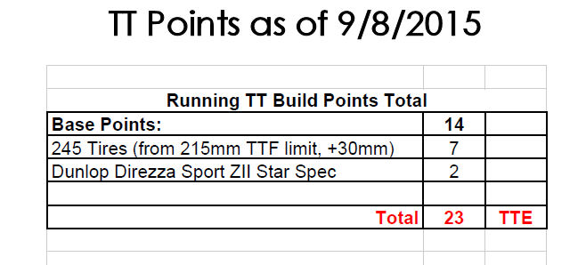

The TT rules have one giant listing for all cars that have ever been given an initial base class. If you look at the list of BMWs, they are sorted very poorly, so I took out the basic E36 and E46, M and non-M cars, resorted them, and created the graphic above. That means our 325Ci is classed in TTF with two stars (**).
Next we make a list of the modifications we want to do and tally up the points assigned to each mod, also shown in the TT rules, starting on page 29. We use a custom spreadsheet that we have created and it automatically sums all of the "mod" and "base" points. There are also a lot of "zero point mods", which are upgrades or changes allowed across all classes without any mod points. Camber plates, lightweight flywheels, upgraded brake pads, upgraded motor and transmission mounts, etc. Those are all listed on page 35 of the 2015 TT rules, and we will utilize many of these "free mods" for sure.
Next we look at the total points and see if we have "bumped up a class", which is explained below. Since we're starting with 14 penalty points in TTF, that means we only have 5 points left to stay in TTF, which isn't a lot. We will obviously be modding this car beyond that, and go to at least TTE class if not TTD for the final build.
8.3 Up-Classing System (TTB-TTF only)
Modifications and Point Assessments: If a car accrues 20 or more points it will be bumped up in Class. There is no limit—a car with a high level of modifications might move up several Classes.
20 thru 39 points - Up ONE Class
40 thru 59 points - Up TWO Classes
60 thru 79 points - Up THREE Classes
80 thru 99 points - Up FOUR Classes
100 thru 119 points - Up FIVE Classes
One (1) asterisk * on a base class assignment denotes a 7 point initial assessment, and two (2) asterisks ** denotes a 14 point initial assessment that is added to the total number of Modification Points to determine the final competition class.
We usually do this a little backwards when starting a new build. The first thing I do for any car we might prep for NASA TT is look at the base classing, base minimum weight, any penalty points (* = -7, ** = -14), and the base tires and power-to-weight ratios of the initial and final classes. I figure out what final class I want to be in, then figure out what mods I can do for the points allowed. These TT classing calculations involve many variables, and we usually make a dozen or more calculations to get to our initial "class build-up".
I think the final build will end up in TTD, so that means 59 points worth of mods. Then take out the initial two star (**) penalty of -14 points, so we have either 5 points of mods we can use and stay in TTE or 45 points worth of mods for TTD. That's a pretty good number, and we should be able to do all of the suspension, tire, exhaust, cold air, and aero mods we want for that and stay in TTD with a reasonably competitive car. I guess that's what we shall see!
We have made a pair of detailed build plans, and which one we choose will depend on the results of the early upgrades, which are in both plans. We have to know "where we will end up" because so many items that need to be repaired have to be done with either stock parts or upgraded parts depending on the final points tally, and hence the final TT class build. Here's our initial TT running points tally with the current Dunlop 245mm street tire package (Not what we have planned for the final TTD setup, but its just an example of what we've done and what points the car has accrued).
With up to 19 points we could have stayed in TTF, 20-39 points is TTE, 40-59 points is TTD. 23 points now = TTE legal
If you look at the initial classing of the 325 vs 330, the 325Ci has a better (aka: lower) base class (TTF**) than a base trim level 330Ci in (TTE) as well as a lower minimum weight (3197 pounds for the E46 325, 3285 pounds for the E46 330) but not really if you look at it's base class "base tire size" (TTF = 215mm, TTE = 235mm). Both the 330 and 325 would likely end up in the same class no matter how you build them, and the 325 Coupe will have one single, solitary point advantage over the 330, if we build them the same way. And still strapped with a smaller displacement engine (184 hp vs 225 hp), all due to the TTF** base classing. So we have some number crunching to do, to see if we should stick with the 197K mile 2.5L inline-6 and small 325 brakes or "base upclass" and make this car into a 330Ci, with the larger brakes, more powerful motor, and TTE starting class's larger starting tire size (235mm).
There are also some year-to-year upgrades that we will try to find - like the points free 1996 model brake upgrade we did on our TTC 92 Corvette, since they lump all 1992-96 LT1 Corvettes into the same base class. Again, we are using a 2002 325Ci, which is lumped in with all 2001-06 325 BMWs. So we can mix and match major parts from the Base Trim Level 325i or 325Ci models for any of those 6 years, for no points. Or if we upclass this to a 330, we can use the BTM parts from those year 330Ci or 330i cars. I doubt there's a super secret ringer part within the 2001-06 325 or 330, but we shall see (haven't found it yet).

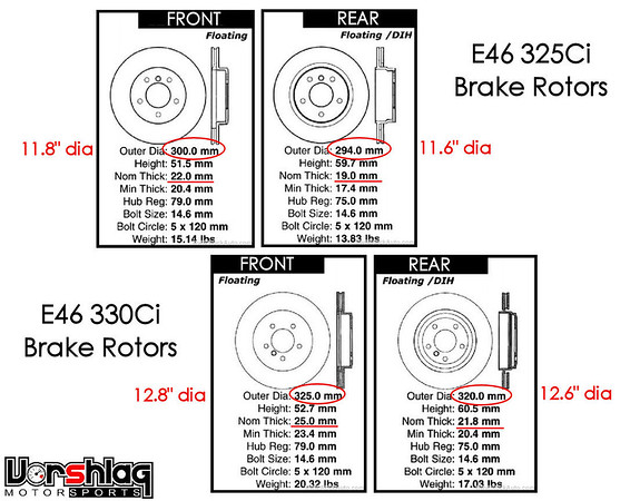

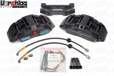

330 brakes are a cheap upgrade for the 325, but they cost +2 mod points (the same as a real BBK)

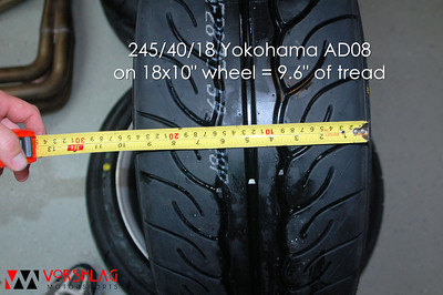

The big question is do we want to make this a small tire/aero build or a larger tire/stock aero build. I know the big tire build worked before, but we've learned a lot about aero since 2009, too. I need to figure out how many points the M3 bumper is going to cost me. The 330 ZHP has no base class, so using the ZHP bumper or 235hp engine is verboten, without taking points. I will talk a LOT more about bumpers next time - I wrote a lot about that already, but this post got too long.

There's plenty of other parts to fix: old transmission shifter feels as loose as you could imagine, the motor and trans mounts are shot, the rear diff bushings are clunking, the front strut mounts are gone, the sunroof is stuck, and it badly needs new front lower control arms and LCA bushings. Not to mention the rear subframe bushings + chassis repair it will surely need at the mounting points. Pretty much all of those "Repairs" will be taken care of during the track upgrade preparations.
So Round 3 will have some more exciting "Race parts" instead of these boring "old car problems". I wrote a bunch more but I will save it for next time, as it has to do with classing choices and such. There are a few parts I am going to order now that will dramatically change our path forward with this project, so tune in next time. Much bench racing to do... which is half the fun of building a TT car. :)

When we were looking at E46 candidates to buy we (aka: my wife) chose the cheapest one, and that isn't always the smartest plan. This car was rough and needed a LOT of work, and it keeps snowballing. Whoever owned this car "drove it hard and put it away wet". The dirty and dinged up chassis said a lot about how they cared for the car. They hit every pothole on the road for 200K miles, ignored leaks and noises, and let this car really go downhill. We can and will fix everything, of course, mostly because I'm stubborn - but it wasn't the right car to start with, I'm sure of that now.
Sadly this is how it looks AFTER some repairs and new headlights
So if you learn anything reading this, it should be the obvious: never buy the cheapest, roughest candidate for a car you are looking at. We should have purchased a 330 and we should have found one with fewer miles and/or in better condition. Something taken care of by an enthusiast who can avoid curbs and potholes. In the end we'll spend as much in repairs and fixes to get this 200K mile 325Ci to function as well as one with less miles and less damage, but oh well. Live and learn.
Also, the cheapest part is rarely the best option in the long run. The $200 headlights burned out one of the LEDs in the first 30 seconds of use. I knew better and "went cheap" anyway. Driving home one night in front of Amy in the 325 I saw her side by with another E46 that had aftermarket projector headlights with the same halo lights. The other car's owner did NOT cheap out and his lights were 3x brighter and didn't burn out the LEDs in the halos. "You get what you pay for."

Our guys ordered the Intake cam position sensor (intake and exhaust cams both have separate sensors, since this is a dual VANOS engine), because that's what the CEL said again (Code P0365). I brought it back in the next day (9/9/15) and Olof swapped that one out in less than 15 minutes.
After that replacement the engine cleared up and ran remarkably well - like it had all ~185 hp back from the factory. The CEL came back again, of course, because German cars hate me for all the crimes I have committed against them. Its the same code - Cam Sensor Bank 1 - but we'll track it down eventually. At least it runs better now.

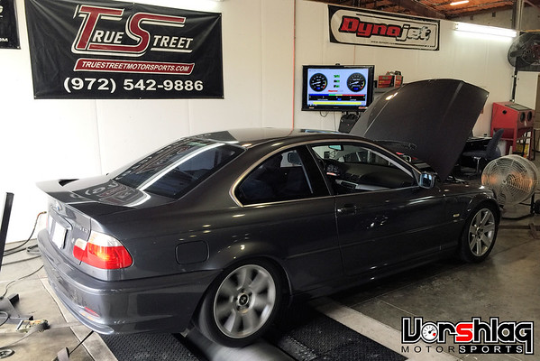

The second video for this round includes the baseline dyno pull performed at True Street Motorsports in McKinney, Texas. After scheduling the appointment about a week in advance, I went up there when they opened on Oct 1st and we strapped the E46 down on their DynoJet chassis dyno.
First Sean did a pull in 5th gear, which is 1:1 and technically the right way to do it. But it was taking a LONG time and wheel speeds were getting up there around "ludicrous speed", so that pull was aborted a tick early. He immediately made a 2nd pull in 4th gear. That worked better and wheel speeds weren't as berserk this time, so he took it to the 6500 rpm redline for that pull.
It actually made more than I predicted at 161.63 whp and 149.0 wtq. I was a bit surprised, but wasn't that far off in my "butt dyno" estimations of 150 whp. After 2 pulls I was ready to take this car off their dyno and get to work, so we unstrapped, I paid my bill and off I went.
Another Headlight Replacement?
OK this is a little embarrassing. After the new headlights and turn signal corner lights were all replaced, I noted in my last post that they didn't fit very well. This is because the entire front core support is bent and the mounting holes for the headlights are all mis-aligned. I told Olof not to worry about it and to secure the headlights in temporarily, until a new core support parts arrived.
The corner lights normally snap in place against the headlights. Of course the clips didn't line up well because the headlights are all in there janky, and eventually one of the corner lights popped off during Amy's drive home one night, smashed off the road surface, and bounced off into a ditch. It was dark and she couldn't find it, so that was lost.
I ordered another E46 corner light made by light manufacturer Depo, which was $15 shipped to my door. I thought I had ordered the correct "smoked" color to match the other side - the picture online showed it smoked - but it arrived "clear".
This was replaced in under a minute but it didn't match the other side at all. So that was a $15 mistake, but it works as a turn signal/light for now. For the short term I taped the light in place until the correct smoked unit arrives. This car just gets better and better...

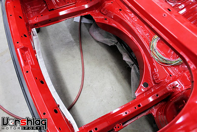

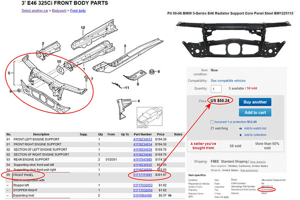

At the same time I researched the replacement core support part. The RealOEM price is $330, but the cheap fleaBay price was $54 shipped. How do they sell stuff this cheaply? Oh yea, its made in a sweatshop and the quality is poor. Well it arrived and it looked pretty good, and we even installed it on a race car E46 M3 chassis we are building for a customer (below). I took it along with that chassis to my paint guru, Shiloh at Heritage Collision Center - who does all of our paint and body work - and they said it fit perfectly.
The new front core support was delivered with this E46M3 chassis to the body shop - and it fit great
Sometimes these dead simple import parts do work, but at $54 I figured if it didn't I'd just toss it in the recycle pile and chalk that one up to experience. Since this $54 import core support worked on the other E46, I ordered another (for our car) and this will go on #JackDaniels when it's apart for the engine's harmonic balancer replacement. The radiator and a lot of other parts have to come out of the way to replace the OEM balancer, so we'll just snatch the whole front of the car off and replace the core support + front bumper cover + balancer all at the same time. Look for this in my next post.

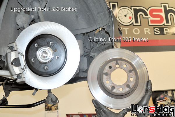

Front Suspension Repairs + 330 Big Brake Upgrade

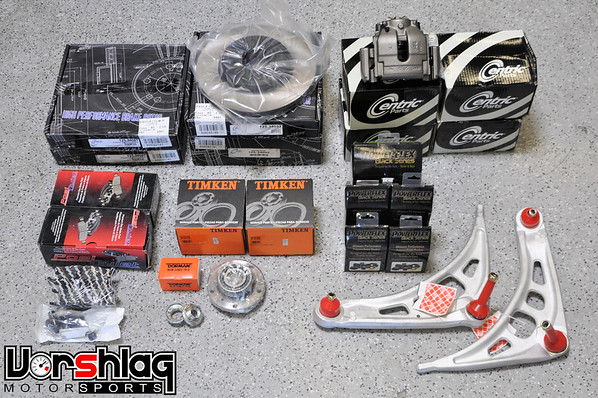

We had been amassing parts for an upcoming break in our shop schedule to get some of the biggest problems fixed on this E46 - such as the wheel bearings, bushings, and control arms - as well as an upgrade to larger 330 disc brakes front and rear.

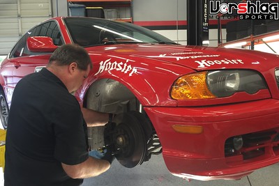

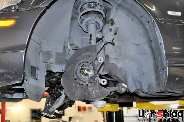

On October 21st we finally had a window of time and I brought Amy's E46 in for some front end work. We had a lot more parts on hand than we had time to install, so some of the bits shown in the big pile above (rear wheel bearings, 330 rear brake rotors/calipers/pads, valve cover gasket, oil filter gasket, and more) will be done next time.

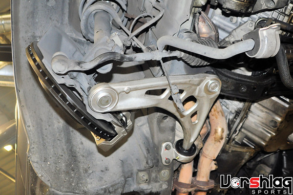

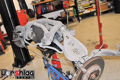

Olof got the car up on the 2-post and started yanking off the old front Lower Control Arms, LCA bushings, hubs, and brakes.
The spindles were inspected but they looked fine.
Everything else removed was nasty, worn and read for the scrap pile.
He used a 2-jaw puller to separate the LCA bushings from the control arms, but normally I just pull these off by hand. The OEM bushings on an E46 are absolute crap when new, and after 200K miles they are literally falling apart. The RF LCA bushing was already 100% separated and allowed a lot of movement between the bushing retainer and the control arm, under braking. Every bump on the road made an audible THUMP! so I couldn't wait to drive the car after these were new and improved.
continued below
Vorshlag-Fair
Official Site Vendor
Nov 12, 2010
1,592
116
Dallas, TX
continued from above
The original LCA "lollipop" housings had the old remnants pressed out and in went 2-piece Powerflex polyurethane "race" bushings. These have an inner and outer liner which rotate against each other, and if properly greased they are silent yet remove virtually all bushing deflection under bump, braking, and cornering loads.
Olof added a threaded grease zerk to the lollipop housing and modified the outer bushing, which should give us squeak free use. Per our procedures he also torqued the mounting bolts to factory spec and paint marked the bolts in red.
The new OEM replacement E46 non-M, non-ZHP, base trim model control arms went on next. The old ball joints (two per arm) were all sorts of shot, so that will tighten up the slop and reduce more noises.
Next up were new wheel hubs, which were badly needed. The old bearings was falling apart and very near a "total failure". Then 1" larger Centric Premium OEM replacement brake rotors from a 2001-06 330 were installed, as well as OEM replacement rebuilt Centric calipers and mounting bridges. In went some Centric Ceramic street pads, which are quiet and dust free - but we will swap in proper Carbotech pads for track use.

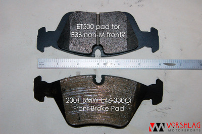

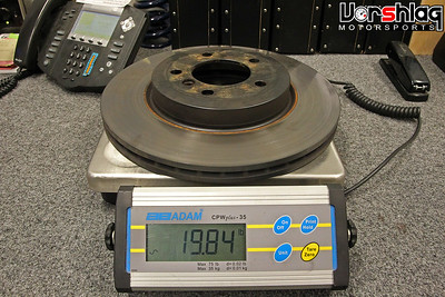

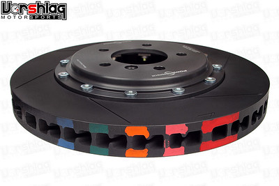

I showed more detail on the size differences between 323/325 rotors and the larger 330 rotors in my last post. These are going to be a +2 point upgrade, until and if we convert the car to a 330, at which point we will get those 2 points back. For now, we'll take the 1" larger rotors and the +2 point hit.
We didn't have time to install the rear wheel bearings, rear rotors, calipers or pads. The front brakes were shot, as were the wheel bearings, so only those were replaced. To help the car pass inspection Olof managed to get the horns working as well. He stole a pair off of a 2001 330Ci race car chassis in the shop, as the original 325Ci horns were junk. How do you break a pair of horns? The previous owner managed to! ;)

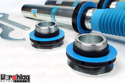

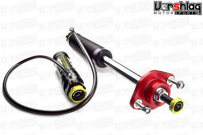

We are planning on MCS TT2 coilovers, Vorshlag camber plates, and Vorshlag spherical RSMs in the next round as well. Just gotta save my pennies and get the shocks ordered. :) This round of mods will cost us +5 points and put us squarely in TTD, but that's for another day.

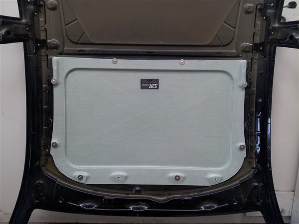

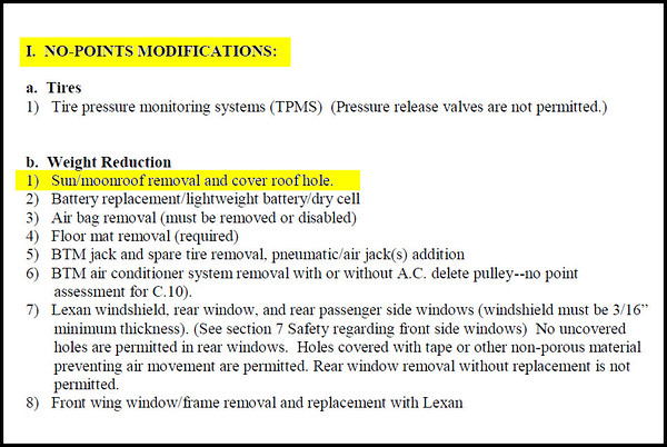

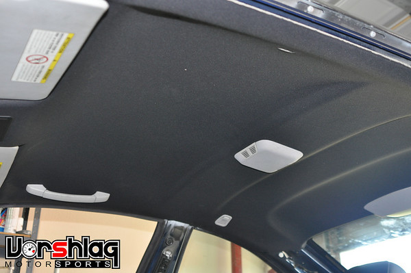

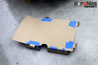

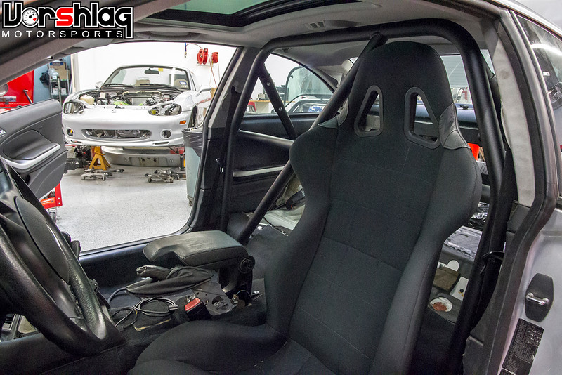

SUNROOF DELETE PANEL
The factory sunroof is busted on this car and stuck in the "almost closed" position. It hasn't leaked any water in but its just dead weight in the car right now, since it won't retract or close completely. Luckily one of the many things we can do in the "No Points Modifications" rules section within NASA TT/PT classes is a sunroof delete.
Why do this? Three reasons.
1. The sunroof in an E46 weighs about 33 pounds, and its weight up at the highest point of the chassis.
2. With a factory sunroof, the headliner sits about 1-2" lower, which makes headroom tight for me*
3. The sunroof motor is busted on this car, and the glass roof panel is sitting just slightly open...
* Yes, while this car is being built primarily for my wife Amy, who is 5'7" tall, she and I are on a registered NASA team. That means either of us can drive the same TT entry if we register as a team, which we always do. We often enter multiple cars (pay multiple entry fees) as a team, too. So either driver can drive any car paid for and entered as a team. So I might drive this car.
From previous experience, I don't well fit in an an OEM sunroof equipped E46 (or virtually any car with a factory sunroof) with a helmet on. You can see that in the images above, from our blue 2001 330Ci. I ran with the sunroof open on that car early on, but the edge of the glass panel is just about in the middle of my helmet, so I had to "slouch" down in the car, lean the seat back, etc.
I managed to fit with a 1-piece racing seat, but only when it was bolted directly to the floor (inches lower than the stock seat). When she and I both drive a car it needs a seat slider, which adds about an inch of height to the seat (and makes it easier for Amy to see out of the car). Then my head is in the sunroof/headliner again. The only SCCA class-legal fix on our old car was a complete factory roof swap. That was a giant PITA!
Pictures of the E46 roof swap: https://vorshlag.smugmug.com/Instructions/BMW-E46-Roof-Swap/

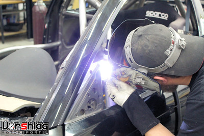

Getting the old headliner, interior panels (A-, B-, C-pillars), and the sunroof cassette out was the easy part - and for Project #JackDaniels we will have to do this same steps shown above. To make the sunroof swap legal for SCCA we had these additional steps: spend a couple thousand on a new exterior roof panel and headliner (both imported/shipped from Germany), add the extra roof cross bow, and finish the install exactly like BMW built it from the factory. This work meant we had to remove the front and rear glass, drill out every spot weld around the roof perimeter, count the number of spot welds, and use the same number of welds at the same locations to attach the new roof panel. I did this job myself, and it was a bear.
This 325 is NOT being built around SCCA Solo rules and we can just use a relatively painless-to-install "sunroof delete panel". For BMWCCA road racing, it has to be metal, but NASA don't care - so we will use a fiberglass or carbon fiber sunroof delete panel - like these options from s2r tuning (see above). This panel is a lot nicer than the eBay crap we used to have to settle for. It has a proper flange & mounting holes.
Once the panel is in place a new "no-sunroof" headliner from BMW (~$400) finishes off the interior and gives you the extra 2" of headroom. We will likely recover or replace the A-, B- and C-pillar trim at the same time, since its all falling apart. After we source the non-sunroof headliner, then we can paint or wrap the s2r panel we already have, then do the swap. Will show that next time.

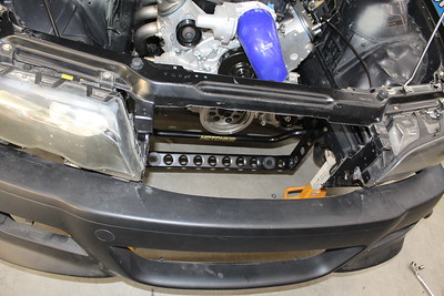

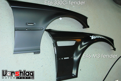

M3 FRONT BUMPER COVER + M3 FRONT FENDERS?
As I mentioned before (first image in this post) the front bumper cover is pretty beat up. It is functional but just plain ugly, and will have to be replaced at some point. Since we are thinking of NASA TT-letter class legal upgrades we have to keep those rules in mind. We could upgrade this 325Ci to 330 ZHP (M-Tech II) or E46 M3 front bumper cover, but either one would cost "points" in NASA TT letter classes. Anything other than the plain old E46 325 cover is "mod points", which we need to keep an eye on.
Various E46 front bumper cover pictures shown side by side
Why does an OEM cover from another E46 model cost points? These cars are classed as the Base Trim Models (323, 325, 328, and 330, all separately). The 330 ZHP is not even the BTM model of the 330 entry, and of course the E46 M3 is a different model altogether. There could be and likely are aerodynamic differences between the "base model" 325 front cover and these other two options, shown above.
Both the ZHP and M3 bumper covers have a longer bottom section, which is considered an "air dam" when you compare it to the "BTM" 325/330 bumper cover. Either bumper cover upgrade would be at least +3 points - see the NASA TT rule 8.3.G (see below). The ZHP has little forward facing lower spats, which could even be considered canards (+2) and/or a splitter (+3). The M3 CSL front end (not shown) could take the same hits for canard and splitter upgrades as well.
G. AERODYNAMICS:
1) Add, replace, or modify front fascia and/or air dam +3 (except as provided for in I.c.3), I.f.3), I.h.14) of the No-Points Modification list) The air dam must be vertical (5° tolerance) and must not protrude from the side of the vehicle or it will be assessed an additional +3 points. Additional points must be assessed below for any component of the added, replaced, or modified fascia or air dam that performs the functions of G.2) and G.3) below.
Don't laugh - I've seen a base S2000 upgrade to the factory S2000CR front bumper cover and get +11 points thrown at them (+3 air dam, +2 canards, +3 splitter, and +3 for added width). It retroactively cost the owner several NASA wins and track records when this ruling came down, which was all the way from the top. So we need to be smart and decide which way we want to go on this car - either a wide tire setup or a narrower tire (245mm) + alternate aero mods - before we change the front bumper cover, front fenders, etc. Decisions, decisions.
From what I can see the entire model run of the E46 M3 shares headlights with the pre-facelifted 2000-03 325/330 Coupe, so we will go with the E46 M3 front bumper cover. The M3 front bumper is also a better basis for brake cooling and splitter addition, if we "go for aero".
We might add M3 front fenders as well. Do they fit? Yes they do. We did the M3 front fender upgrade (but not front end) on our blue 330 Coupe (above left), which fit 285mm front tires. Initially we ran the blue 330 with the unmodified M3 front fenders, which were more-or-less a bolt-on (we used the M3 fender liners, which are longer, to line up with the outer fender lip). It took a little tweaking to get the 330 front bumper cover to line up, but we made it look seamless (above right). The M3 bumper cover fits even better when used with the M3 front fenders, as you would expect.
To make these legal as "flares" for the SCCA class we raced in with that car back then (also needed for zero-point TT-Letter legality), we had to make them look like an E46 Coupe fender "with flares added". To do this I covered up the M3's unique "side vents" on the upper section of the fenders, so it would be considered a "fender flare" change. Alternatively we could just cut the outer M3 flare portion off and graft that to the 325 fenders (its just more work).
More pictures of the E46 fender rolling and M3 fender conversion here: https://vorshlag.smugmug.com/Instructions/BMW-E46-fender-rolling/
The M3 front fender flares allowed the E46 non-M to swallow 285mm front tires on 18x10" wheels. We used that size for NASA TTD later in its life and it worked well, and we could do the same on the 325Ci here... but the tire size bump from a base 215mm tire (+70mm of tire = +19 points) eats up a LOT of our class modification points, and pretty much precludes any aero work. And, well, as much as I like "big tires on everything" we have lately had great luck with adding "all the downforces!", too.

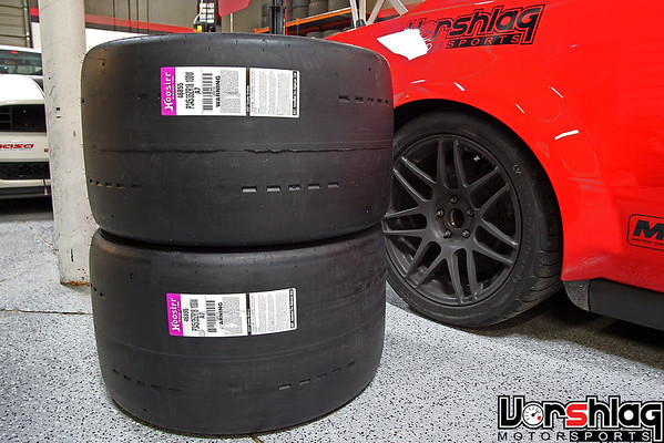

Full aero upgrade or massive tire upgrade? That's the big question
Its an expensive thing to "just do both and test", of course. Adding massive tires will take extensive body mods. Adding a splitter/airdam + rear wing will also take a lot of time and money. Which will work better? We will have to see....

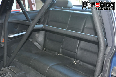

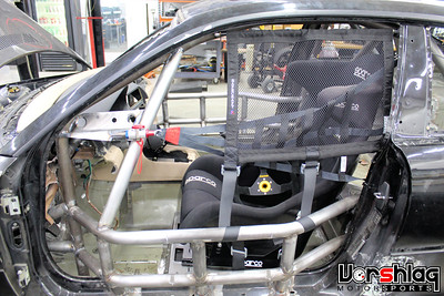

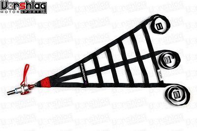

One safety upgrade we have in mind is the seats + harnesses + a 4-point roll bar. The two Cobra seats above were used in a previous project, so those will go in the E46 when the timing works with our shop. The driver's side needs a slider and custom brackets to fit Amy and me both. We will likely wait until the roll bar is built before installing these, to get them all to line up together.
The old steering wheel is nasty and has a massive hole in the leather cover. Getting a steering wheel "re-wrapped" is an expensive affair ($375+) and all of the places found only have patterns for the E46 M3 wheel. So an easier solution would be to take this E46 M3 steering wheel above and slip that onto the column of #JackDaniels. The wheel rim is a different shape and has a slightly different airbag, but the steering wheel controls are identical and the leather cover is perfect. Maybe it will just bolt right up? I've seen it on the interwebs so it must be true.
We still have plenty of safety, reliability, and car prep tasks before this car takes to the track, but hopefully before the end of 2015 we can take the 325 onto a road course and get some initial lap times. Fingers crossed...

Project Update for November 17th, 2015: It has been an interesting few weeks and this E46 Daily Driver / NASA TT project has made a dramatic turn.... for the better! We've switched horses mid-stream, as it were: there's a shiny Hellrot red 2001 330Ci now in our driveway and the little gray 325Ci is getting replaced.
Why the chassis change? For one, the 330 ends up being classed in NASA TT better than the 325 - I will explain that below in excruciating detail. Secondly, this 330 is cleaner and has more power than the 325 ever will. We have already started some initial repairs on the 330 and we are finishing up a few loose ends on the 325 before it gets sold. All of this is covered in this post, and at the end I will discuss some changes to the NASA TT rules for 2016 that effect TT1/2/3, but which will probably impact the TT-letter classes in a year or two.
Sadly, the red car doesn't even have a name yet.

Going from the M54B25 to the M54B30 made for a 25% increase in power, stock for stock

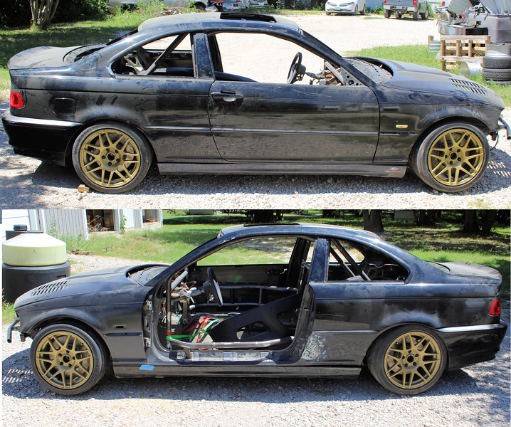

I had talked about converting the 325 to a 330, but upon closer examination it looked like more work than it would be worth - plus there are some unknowns that could make for "Protest Bait" at NASA events. Right after purchasing this 325 I had quietly been searching for a cleaner, lower mileage 330 5-speed, hopefully a coupe, and hopefully something painted Hellrot red.
Damn if if this exact set of "wants" didn't pop up in my local Craigslist searches a couple of weeks ago! Amy and I went and looked at this car on a rainy day and test drove it, and the 25% power increase over the 325 was very apparent. The body was straighter, the paint was in better shape, and the interior was nicer. It wasn't perfect - the brakes were worn, it had some suspension clunks I could hear in the test drive, and of course it flashed a CEL within seconds of starting it up - E46s love to light up that Check Engine Light!
I had a friend run the VIN while we discussed the purchase and that showed not one but two insurance claims in its past, both apparently front end hits (with one of them also tagging the rear bumper cover, which has also been repainted). The damage and repairs were very apparent, and not bad work for the most part. The frame rails were straight and the unibody had no damage, just superficial stuff. Most of its life was in Texas (not a rust belt state), so that's good. The two wrecks and the odometer's 160K miles logged impacted the price, but snagging this 2001 330Ci 5-spd for $3500 made it all worth it.
This red E46 isn't perfect, but overall it clean and in nice shape, especially considering what we paid for it. The exterior, interior, wheels and power are a big step up from what we started with on the 325. It was also the only 330 5-spd coupe I've found for under $6000 in many weeks of looking locally. Sure, there are often deals 5 states away, but this car was only 8 minutes away, so going to look at it didn't gobble up hours of driving.
Upon closer examination I saw something during the negotiations with the seller: this E46 also needs a front core support assembly. I detailed in a previous post where I found them for $54 shipped, so another is on order. This one is torn more than bent, probably happened during the recent front end hit (hooked a trailer hitch on a truck or something), and you can see the issue in the image above. The hood is straight, the headlights work and are even aimed well, which is all good.

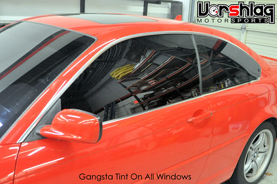

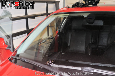

The 330 has super dark "limo tint" on all of the windows, even a big strip along the top of the windshield. Not only is this illegal, it is so dark you cannot drive the car at night with the side windows up, so that's all coming off. Track Cars should not have tinted windows - anything that limits your 360° visibility on track is unnecessarily dangerous.
The interior is nice enough except for the A-, B- and C-pillar covers and headliner). The sunroof is - you guessed it - also broken. We will use the S2R Tuning sourced fiberglass E46 sunroof delete panel on this car, to gain headroom and to remove that 33 pounds up top. The stock black leather power seats are in nicer shape than the 325's, so those will go into JackDaniels before it sells (and the pair of COBRA race seats into this 330). The 330's factory steering wheel and shifter will also be swapped into the 325, too.
I might even swap the 5-spoke wheels from the 330 to the 325 to help it sell. These are factory 17x7.5" front, 17x8.5" rear and are in excellent shape. Whatever we don't plan to keep on the red car long term and would help sell the 325 gets swapped.
330 REPAIRS BEGIN
Some small issues made this 330 "slow to sell" and also helped me push the seller's numbers down $1000 from the asking price (they wanted $4500). I pointed out the front end damage and the VIN history to the seller, noted the CEL, and discussed the suspension clunks and bent rear control arms that I could see. We got a decent deal but didn't exactly steal the car - as it had a few things we needed to repair straight away.
I've said it before but I will say it again - tow truck drivers are the worst. Why do they always want to put their tie-down hooks right in the middle of BMW rear lateral control arms?? These arms cannot take any fore-aft forces, especially hooked right in the middle, as they are made for lateral suspension loading only. When these guys strap chains on these arms they get bent quickly, like this...

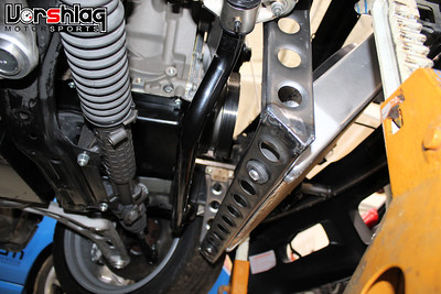

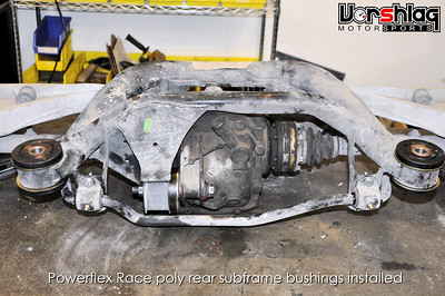

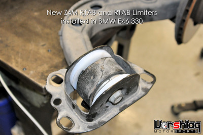

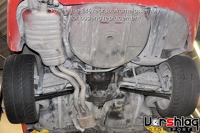

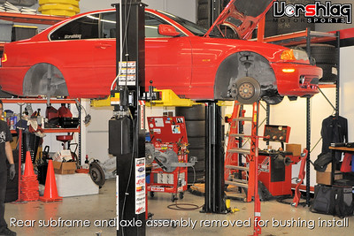

Another new pair of OEM replacement Lemforder lateral arms were sourced and Olof once again installed these onto the red 330, just like he did on the 325. It is bound to happen on a used E46, but at least they aren't expensive.
The bent arms probably tweaked the rear alignment, no? The inboard lower bushings are replaced when you do these arms, by the way. To replace these you have to remove the inner mounting bolts. To gain access for this you have to unbolt the differential housing and move it out of the way a bit (see below).
During my test drive, our inspections up on the lift, and during the LCA install, we all noted "worn differential mount bushings". These were clunking away during quick shifts on my test drive, and Olof could put a pry bar on the diff and move it against the bushings a lot. Another very common failing of an older E46.

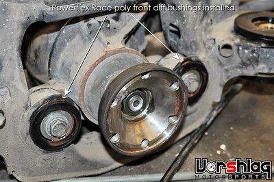

Luckily the 325's diff bushings aren't all that bad, so the new Powerflex Race polyurethane differential mount bushings we sourced for that car will go into this 330. We will also take the Powerflex Race subframe bushings allocated for that car and install them on the 330 as well. Now that these lower arms are back to stock and straight we can focus on other immediate fixes.

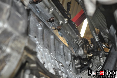

The CEL codes pointed to a non-functional air pump, so Brad dug around for a bit to find the issue. Solenoid could be jumped and it would come on, the wiring was good, just wasn't getting a strong signal from the DME. This pump is supposed to come on after start-up and run, injecting air into the manifolds to "light-off" the catalysts.
Cold start emissions get borked when this doesn't work. Normally just the pump is bad, or the air valve at the manifold, but those seemed to work.
I took the 330 by briefly to see my friends at Autobahn Service Center in Plano for a second set of eyes to diagnose the CEL issue. They have the right computer equipment to cycle things through the DME and they found that the secondary air pump wasn't cycling. They also noted that one of the idler pulleys was howling, which we also heard. First step was to replace ALL of the idler pulleys, tensioners and both serpentine belts.
The air pump had 160K miles on it so we went ahead and purchased a new one, just to be safe (this will remain an emissions legal street car, after all). All three rubber bushing mounts for the pump were hard and broken, so there were also replaced. The air hose shown above was badly cracked so it was replaced, as were some of the small vacuum hoses that trigger this system. We are waiting on the vacuum switch that is on the back of the cylinder head to arrive, then it will be installed, hopefully fixing this system and thus the CEL. Then we can get it inspected!
Like virtually all BMW models that are 14 years old, this one has some seals and gaskets underhood that have hardened, cracked, and are now leaking fluid. There's some oil residue underneath, but not nearly as bad as the 325.
Next week we will replace the valve cover gaskets and remote oil filter housing gaskets on both E46 cars, to remove the cracked gaskets that each car has and hopefully stop the fluid leaks. The 330 will also get new spark plugs, cabin air filter, and the air pump vacuum switch. I will detail all of the costs for parts and hours spent on the initial 330 repairs in my next update, since we're sort of in the middle of those.
325 VS 330 - NASA TT CLASSING
If you have no interest in NASA Time Trial classing, feel free to skip down past this entire section. NASA TT-Letter classing is somewhat complicated and a bit confusing, which is partly how I made the mistake of purchasing the wrong car initially (325) for a TTD build. Initially when we thought about this E46 project I was looking for another E46 330, because we built that model into a TTD and ran it in NASA TT events twice, and set TTD track records at both events. The funniest part was that car wasn't really built for TTD, it was supposed to be an autocross car. It was only accidentally a decent TTD car (but a relatively poor autocross car).

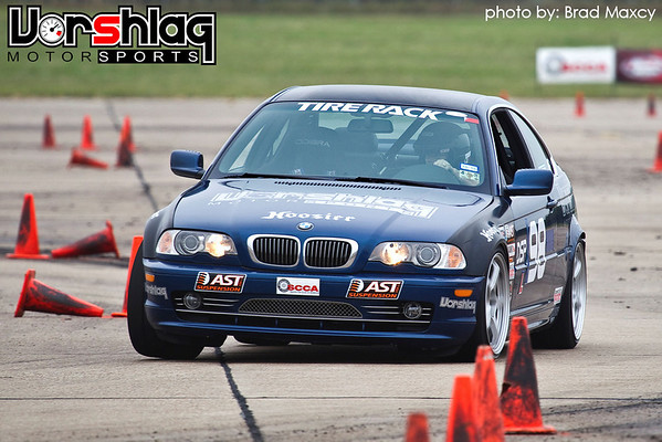

One thing we did differently on that blue 330 was run all stock aero. That saved a lot of "mod points" for tire width, which we spent almost entirely in 285 mm Hoosier R6 tires. Again, this was really because our autocross set-up was much more dependent on tire width, and the TTD setup was more of an afterthought (all we did was switch from 285 mm Hoosier A6 to 285 mm R6). That car was built back in 2009 and since then I've come to appreciate reducing drag and making downforce a lot more, so we're building the current E46 330 around a 245mm R7 tire and a wing + splitter + vented hood.

This time around we started off with the goal to build a TTD car, so priorities are also different. I will explain "the holy trinity" of road course priorities in a section below.
One of the two times we ran this autocross car in TTD it was done on 265 street tires, as shown above
Still, I rushed the purchase of the E46 this time around and we initially settled for the 325 we found for less $$. Impatience costs money because now we are starting over with the "right" E46. I talked briefly about my NASA TT classing concerns with the 325 in my last (September 8th) thread update. It wasn't until after we bought the 325 that I ran all of the TTD classing calculations and permutations, then I figured out the mistake I had made - the 330 is actually classed better for the end goal of TTD than the 325. It has more points to play with AND a lot more power.

  • E46 325, base TTF** jumping to TTD = 45 points (A two class jump yields 59 points, minus 14 base class "penalty points")
  • E46 330, base TTE jumping to TTD = 39 points (39 points yields for a single class jump)
  • This gives an extra 6 points of modifications to get from their respective base classes up to TTD, in favor of the 325...
So 45 points to work with on mods for the 325 is better than 39 points on the 330, right? Wrong. There are still two differences on the TTF** classed 325 that gobble up points we have to account for. First is that the base tire size is different for each base class - doesn't matter what the factory tire sizes are, it is what the initial base Letter class is assigned with.
The following tire sizes will be used as the base tire size for each Base Class for all vehicles regardless of their OEM tire size(s) or their Final Competition Class. All vehicles in a given base class may use this tire size (or smaller) without a points assessment:
TTB: 265mm
TTC: 255mm
TTD: 245mm
TTE: 235mm
TTF: 215mm
TTG: 195mm
TTH: 175mm
So the E46 330, which has a base class in TTE, starts with a 235mm base tire. The E46 325 is classed in TTF, so it starts with a 215mm tire. I have run the numbers and we think that a 245mm tire is ideal once we end up in TTD (which I will explain later, see "the holy trinity of road course prep"), but that tire size costs points on each car differently.
Not to mention that not all 245 tires are the same width, but that's not the point here. Let's just look at why the same 245mm width tire for a TTD build costs 6 more points for the E46 325 than the E46 330...
Tire width points assessed or points credited are determined by the difference between the width of the largest tire on the vehicle and the assigned base tire size as follows:
Equal to or greater than: 10mm +1, 20mm +4, 30mm +7, 40mm +10, 50mm +13, 60mm +16, 70mm +19, 80mm +22, 90mm +25, 100mm +28, 110mm +31
  • E46 325, 215mm to 245mm needs +30mm in width = 7 points
  • E46 330, 235mm to 245mm needs +10mm in width = 1 point
  • E46 330 in TTD on 245mm tire has a net gain of 6 points

Since I've already tracked a 330 with the OEM sized rotors extensively I know that they can work well, and with good pads and cooling I'm fairly certain we can run this TTD build on the 330 brakes. The base e46 330 has larger brakes than even the M3 version of the E36. The smaller E46 325's rotors, however, are fully 1" smaller in diameter than the E46 330 at both ends, which means they might be marginal. We had already upgraded the JackDaniels 325 to use the larger 330 front brakes as a "cheap big brake upgrade", which costs +2 class points (same as going to any BBK). But now with the E46 330 using the same 330 rotors and calipers get's to keep those 2 points because they are the factory Base Trim Level brakes for all 330s.
So if we add up the relative points advantages from the starting tire size (+6) and now the "free" big brakes (+2), then subtract out the 6 point difference in the 325 and 330 points (45 - 39) to get to TTD, we still have a net gain of 2 points for the 330 over the 325 to get to TTD prep.
Baseline dyno of the 325 (at left) and my former 2001 330 (at right) with a cheap eBay header
Then we look at the fact that the E46 330 has a 225hp engine (M54B30) vs the 325's 184 hp engine (M54B25), so that's a gain of 41 hp. The chassis dyno charts above are from our 325 at left and my old blue 2001 BMW 330 at right. The E46 330 dyno'd (my blue 2001 33) had a very crappy eBay header and an even worse tune, but you can still see the relative differences: 211 whp for the 330 and 162 whp for the stock 325 (49 whp diff).
So the 330 is ahead on points and has a 25% head start on horsepower. Win-Win.... right? And yes, this difference did come with a financial cost, as most 330s are going to sell for more than 325s, like this one did ($3500 for the 330 vs $1800 for the 325, a $1700 bump), but this 330 has fewer miles and fewer problems. And look how much fixing problems has cost on the 325.

And the "weight modifier" portion of Appendix B (see below) reminded me that the 325 run at minimum listed weight of 3197 (3 pounds below 3200) would have to take a -0.05 hit. Obviously it makes sense to run 3 pounds heavier than that minimum to avoid a weight modifier.
This is why "running lighter than minimum" can hit you THREE ways.... First, with a lighter given weight you have to make less power at the same P-to-W ratio. Then if you run under minimum you have to take points for every 15 pound increment under the listed weight. Thirdly, you take a modifier hit for all weights below 3200 pounds. Yes, even if your car's assigned Minimum Weight is below 3200, you still take the modifier hit. So before you think about running lighter than Base Class number, or any car lighter than 3200 pounds, DO THE MATH.

B. WEIGHT REDUCTION:
Weight reduction points are based on the actual vehicle minimum competition weight (with driver). Removal and lightening of nonessential parts is permitted unless stated otherwise in the rules. Modification of the OEM frame, sub-frame, and floor pan are not permitted (see 5.2.2) Removal or lightening of engine parts is permitted only as listed elsewhere in the TT rules. The exterior surface of the roof, hood, body panels, and doors must remain their BTM size and shape unless listed otherwise in these rules. If the base weight used for base classing purposes (section 5.2.2) minus minimum competition weight (with driver*) is greater than:
5 lbs +1, 20 lbs +2, 35 lbs +3, 50 lbs +4, 65 lbs +5, 80 lbs +6, 95 lbs +7, 110 lbs +8, 125 lbs +9, 140 lbs +10, 155 lbs +11, 170 lbs +12, 185 lbs +13, 200 lbs +14, 215 lbs +15, 230 lbs +16, 245 lbs +17, 260 lbs +18, 275 lbs +19, 290 lbs +20, 305 lbs +21, 320 lbs +22, 335 lbs +23, 350 lbs +24, 365 lbs +25, 380 lbs +26, 395 lbs +27, 410 lbs +28, 425 lbs +29, 440 lbs +30, 455 lbs +31, 470 lbs +32, 485 lbs +33, 500 lbs +34, 515 lbs +35, etc…
So while TT-Letter classes allows pretty liberal weight removal mods without burning "mod points", any time TT-Letter cars are raced BELOW their Base Class stated minimum weight (shown in the base classing list), they have to take POINTS for every 15 pound increment below minimum weights (see chart above). Which means you again miss your P-to-W limit and/or run out of points for proper suspension, aero, power or tire mods.

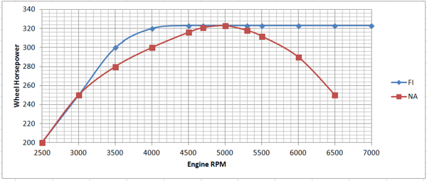

This is one of the "dyno tricks" that turbo cars are doing in P-to-W classes

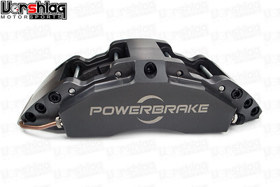

While I had not planned on Big Brakes with the 330, after some meetings at PRI show in December we had strategic reasons for doing this upgrade on this 330 now - to test a BBK from a new manufacturer we want to work with. So aftermarket 4-piston calipers with 2-piece rotors were added to the list (+2). Again, we had the points to spare and still another 4 more after that. This plan was solid.
Until the 7 point 2016 rules change for the 330. I had to back to the drawing board and re-plan this build. We have only 32 mod points to play with on this 330 now, but still the same "wants and needs". We can keep the stock swaybars (2) and the 330 brakes (2) and meet the 32 point goal, but there were marketing and performance reasons to modify both. We'll keep looking at the points and post the classing sheets after our first event (which will have a lot of things missing, due to time constraints).

One of the "ugly" bits on the 325 were the seats. The leather on both front seats was trashed and the motors on the driver's seat were gone. We have race seats on hand for the red car so we robbed the 330's front seats for the 325, which are in better shape (no rips/tears) and in the matching black.
That car's driver's seat didn't work right when we got it - the power controls wouldn't move the left seat fore-aft. Brad and Olof took the seat out for a closer look, and lo and behold - one of the power seat motors was MISSING. I stressed about getting the right replacement unit, and there were dozens of BMW part numbers for different year E46 power seat models and different locations in the seat (all expensive), but what the heck? I had the guys yank the motor out of the up-down action, put it in the fore-aft spot, and it worked like a champ. So Amy can finally get the seat close enough to be able to drive in this seat, they look 100% better in the 325, and they put the old 328 gray driver's seat and the raggedy old 325 black passenger seat in the 330 - for now.

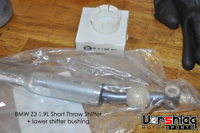

The shifter was so worn out that we replaced it with a Z3 1.9L shift handle, new lower bushing, and new shift knob. The shift knob was cheesy but in better shape the the 325's old knob, and the new piece is shown in the big interior image of the 325, above. A missing corner light was replaced on the front cover at the same time.
When the worn out shifter was replaced we went back with a Z3 1.9L handle, which shortens the shift throws dramatically by moving the pivot point at the lower mount (see image above - which shows the old 330 shifter and the OEM Z3 "short shifter" part). With a "fresh" handle (not a wobbly noodle), a fresh lower bushing, and a new shift knob ... WOW. That makes a night and day difference driving the car for only about an hour of work. No more missed shifts just driving around on the street, like before.
As I mentioned in previous posts the 325 was dropping fluids at multiple locations. The pool of oil and coolant below was from a typical overnight parking.
So the leak fixes were dealt with a couple of months back. Repairs included new valve cover gaskets, spark plugs, and oil filter housing gasket.
The valve cover gaskets and remote oil filter housing gaskets are super common places for these engines to develop leaks over time.
The entire cooling system had been replaced already but the remaining leaks were from a pair of plastic coolant lines that went from the head to the firewall/heater core, and specifically the O-rings in the ends.
The coolant lines break when you remove them, after they are this old, so those were replaced along with the leaky O-rings. After this round of repairs the 325 was finally leak free. The guys covered up all openings then pressure washed the block and oil pan when it was all apart, so its squeaky clean. This way we can see any additional leaks - so far, over a month later, not a drop is visible.
While all of these systems were apart the cabin filter and engine air filters were replaced, as were the oil filter (Wix) and oil (Mobil1).

We did some cosmetic fizes to the 325 also. I found the right paint code in the engine bay (Stahlgrau Metallic, #400) and ordered a pre-mixed paint kit that had spray cans of this base color and a clear coat. Brad took the replacement lower headlight trim piece and painted it to match the rest of the car and then we installed those.
Olof tried to install another set of corner lights, but I not only ordered the wrong color (clear) they were the wrong mounting type, too. There are SO many different corner lights but this 2002 should normally use an '02-03 Coupe replacement style (certain shape and mounting tabs), which can come in clear, orange, or smoked.
I kept ordering 02-03 coupe lights and they never fit, so I took over and dug further. Turns out we used an E46 coupe 99-01 style headlight kit, which all M3s use. So the headlights didn't have the right slots or tabs to hold the later corner lights... eventually I found the Khoalty website (not amazon or ebay, which are terrible places to shop for lights, as I have found!) that had the RIGHT details listed for the various E46 models: I could choose the year (there were changes for many E46 year models) and body style (coupe/convert, sedan, estate) and color (smoke, clear, orange) and I got the right corner lights... on only my 3rd try! Looks like they have better quality headlights as well. Wish I would have found Khoalty.com sooner!
Not only do these finally fit the body and headlight styles, they are the right color to match the smoked lens headlights, and they don't need tape to hold them in place. Yea, its the small victories in life like this that are worthwhile. :)
We had already replaced and upgraded the front brakes on the 325, which I showed last time. Now that we switched cars for race prep and are making this 325 "ready to sell", I'm making sure it leaves the shop with all maintenance issues addresses. So the rear rotor and brake pads still needed replacement. So we ordered up new rear 325 sized Centric rotors and street pads and those were installed, shown above.
Last but not least, the front core support was replaced. We could have left the old tweaked unit in there but then the headlights would not have lined up. So I went ahead and had our crew pull the front bumper + cover off and replace the entire structure. Again, these are always black from the factory so it doesn't need to be painted body color, and the $54 replacement structure was already painted black. Sure enough as soon as that straight/new piece was in place the headlights finally fit right, Olof aligned the beams, and driving at night was no longer dangerous.

We tend to look at the manufacturer's recommended wheel width range for a given tire and go to the widest wheel shown, or even a little bit more. Hoosier states that am 8-9.5" wide wheel is optimal for this 245/40/17 R7. But another 1/2" of width is even better! :) For a 245mm tire I'd use up to a 10" wide wheel, which we're going to do once again. I've run 205s on 8.5" wheels, 275s on 11" wheels, and 315s on 12" wide wheels - when race classing tire limits were being built around.
Technically this NASA TTD build doesn't have a "max limit", but any tire we use wider than 235mm costs us points. A 245mm is +1, a 255mm would be +4, a 265mm would be +7, and on and on. Sure, I know for a fact that we could fit up to a 265mm wide tire on an 18x10" wheel under stock E46 fender contours with just some fender rolling. Been there, done that (see below).
18x10" wheel with 265/35/18 tire on 2001 BMW 330Ci - with camber and fender rolling only
Again, sometimes "bigger is better" has drawbacks. Not only does the 245mm tire cost less points than a 255 or 265, we get also get a big P-to-W ratio break (+0.8!) for using 245mm or smaller DOT tires. There's a particular 245 in the Hoosier catalog we like and have used on our TTC Corvette: the Hoosier 245/40/17. This tire comes in a number of compounds from Hoosier, but for competitive reasons we chose the R7 compound (+10 points). The R6 (+8 points) is being phased out, the A6 (+17) compound jumped up a lot of points last year, and the A7 (+22) has a horrendously expensive cost for this compound in TT Letter classes.

After I had this mess all cleaned up I went ahead and got an initial weight on the 330. With virtually no fuel and no trunk junk it weighed in at 3180 pounds. That's only 14 pounds heavier than my blue 2001 330Ci, which was identical to this except it had manual seats (and was weighed with a tick more fuel, as shown).
With a target TTD race weight of 3285 pounds with driver and fuel we still need to knock out about 125-150 pounds. Between the sunroof delete (-30 pounds), race wheels (larger but lighter), racing seats (probably -40 pounds per side), lightweight flywheel and clutch (-15 pounds) and race header + exhaust (-50+ pounds) I know we can get there. We might even have to add ballast, but that's part of the plan.

What I thought were typical top end oil leaks turned out to be some residue from power steering fluid spill and these repairs have been held off for now. The coolant system replacement is waiting on a lot of new E46 330 cooling system parts to be released (almost out) and that will happen soon. The heater isn't working due to a broken center vent/actuator that we'll attack. The ambient air temp sensor is gone and flashing high/low temps. Of course the stock shifter... ugh. Its shot and has to be fixed.

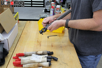

We used the same low cost Shifter Upgrade parts as shown on the 325Ci in a previous installment in this thread. A fresh Z3 1.9L shift handle (shorter throw), new bushings and clips, and all of the slop in the worn out 330 shift lever and old bushings is gone. This makes such a huge difference for so little money. Like most E46 manuals, the shifter doesn't "self center" well (align with the 3-4 gate), but that's inherent to the design. The driveshaft bushing (guibo) was also cracked, so it was replaced while the shifter was being serviced.

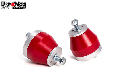

One of the major deficiencies of all modern BMWs are the fluid filled motor mounts and wear prone transmission mounts. The body-mounted shifter is already sloppy enough with a rubber bushing in the middle of the shift handle, but when the motor + transmission are flopping around under engine torque it is easy to have the shifter mis-align during spirited driving or track use.
As expected, these 162K mile motor mounts came out of the car in pieces, then leaked their goo all over the place. The OEM transmission mounts were cracked and very mushy, so they were removed as well.
The shifter fix involves not only the freshened shifter parts but also our firmer Motor and Transmission Mounts. I chose the Nylon version of our motor mounts and stiffer red poly version of our trans mounts, and they really make a big difference in throttle response and shift feel. These are the stiffest of two options we offer, and they definitely add significant NVH under 1500 rpms, but the shift feel with the drivetrain locked down is like nothing else. We would have less NVH with our red poly motor mounts and orange poly trans mounts, which are still stiffer than stock but don't have as much buzz at idle.
To help slow the car down on track we installed all new brake parts, with Carbotech XP12 pads front and rear, Motul RBF600 brake fluid, as well as fresh Centric Premium 330-sized rotors. We also added our 90mm wheel studs, lug nuts, and AP caliper temp strips were applied to the calipers (which we looked at during and after both track events). Even though these brakes worked well as-is we still might burn 2 points for a BBK upgrade in the future.
Rear Subframe Bushings + Rear Diff Bushings + new RTAB bushings and Limiters was a big chunk of time. The correct rear chassis reinforcement kit wasn't in stock here the day Olof yanked the rear subframe, so just the bushings were added and we took a look at the crack-prone E46 rear floor area where the subframe mounts.
Of course as soon as the subframe was out and the sheet metal cleaned off, a big 5" long crack was found in the trunk floor near one mount. The percentage of E46 chassis we've seen with cracks in the floor, once the subframe is removed, is nearly 100%. Olof cleaned and TIG welded this crack then primed the area. When the exhaust is out later this season for upgrades we will yank the subframe out once again, weld in the Turner subframe repair kit (the only one that is legal for the E46), and get this area properly reinforced.
After the stock bushings were removed from the rear subframe, new Powerflex Black Race polyurethane bushings were pressed in. This included 4 subframe bushings and 3 differential bushings (2 in front, one in the rear).
Getting the stock bushings out is a bit of a job, and beyond the capabilities of many DIYers, due to the special tools required. We have a BMW-specific bushing service kit and massive C-clamp mobile pressing tool, a 30 ton air-hydraulic press, and it still took another custom tool to get some of these out. Most of the BMW bushing tool kits are specific to the M3 cars, but one of the non-M E46 subframe bushing pairs is so different that Olof built this tool. It fits inside a pair of cavities and allows the press to line up better. Cutting or burning these out is the other option, when you don't have the right tools. That is a stinky, messy, time consuming way to do this work.
In these fixed mounts (diff, subframe) and in single-axis of movement suspension mounts, polyurethane can and does work well in place of the soft rubber the OEMs always use. The front LCA has a bit of a twist and turning angle to it, but the 2-piece poly bushing is a good solution there. The Rear Trailing Arm Bushing (RTAB), however, has a LOT of movement in 2 opposing axis, and going polyurethane here is a bad idea for most end uses. It can add a lot of bind in the rear suspension.
We used our Z4M Lemforder bushings (that we had Sachs/ZF/Lem bring to the US market outside of the dealership channels, years ago) and our UMHW RTAB Limiters to sandwich this bushing, which allows for enough movement but not excessive toe change out back. The Z4M (above right - with the bigger gap) is the same durometer rubber as the E46 M3 version (shown on the left of that image), but the Z4M unit is made larger so that it is pre-loaded more when it is compressed and installed into the trailing arm. The old stock RTAB bushings were all cracked and shot, of course. You can feel the difference when driving with fresh RTABs.

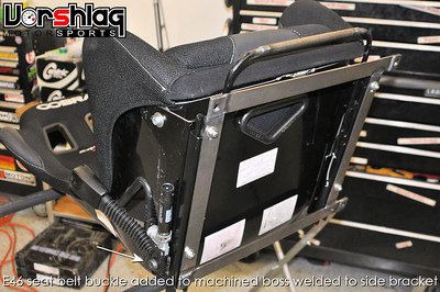

I talked about the Cobra Seat Install last time and installing this took a lot of measuring, test fitting, and fabrication - but its done, and fits Amy and I both. Olof started by taking a set of steel OMP side brackets and cutting, drilling, and modifying them to fit this seat with the lowest possible height and still leave room for a slider underneath.
I don't know who they are making these side brackets to fit, but we've tried all of the brands and they NEVER fit into cars with adult humans without modification. We tend to chop 1-3" of height out of the brackets, drilling new thru-holes lower in the sides and cutting away unused upper portions. Painfully common, otherwise your head is above the roof.
And by the same reasoning, the "normal" width Cobra seats are also painfully too narrow - we tend to go with the "under 130 pounds only" rule on the regular width, and insist customers test sit in these before we will order this size. The "GT" width (+30 mm wider in the butt) is what fits most adult humans for Cobra seats. I've got a pair of the "regular" (narrow) width Cobra Suzukas I'm stuck with right now, due to a sizing mistake when ordering, ugh. Don't make the same mistake - always test sit in the exact model and size seat you want before ordering. That's why we keep several race seats in our lobby.
The modified side brackets were fitted to the seat and a custom threaded bung was machined on the lathe, a hole was cut in the bracket, and this was welded to the inboard side down low. This is where the BMW lower seat belt buckle was bolted, which came off the OEM front seat. There's some wiring that goes to this and it also has some sort of crash sensor pre-tensioning tricks. It moves with the seat, just like it did from the factory, for better alignment to your hip.
The chassis adapter brackets were also laid out and designed, then fabricated from flat steel plate and some square tubing. These are super low profile to keep the seat as low as possible, to fit my torso under the upholstered sunroof headliner with a helmet on. We were trying to lower the seating position about 3 inches, which is tough. The square tubing was added for two anti-submarine mounts. These are threaded ring mounts (G-Force) and have anti-crush sleeves welded into the holes through this tube.
Many racers and internet experts frown on seat sliders, but it is a necessary evil in many race cars that have more than one driver (we've seen this done in most endurance cars, shy of pro racing). Amy and I have very different heights so the driver's seat needs to be low for me at the rear setting, but taller for her up and closer to the front. This means the seat slides forward and moves up at an angle. We used Cobra dual locking sliders, which are low profile and strong. The sliders bolt to the modified OMP side brackets and the bottom of the sliders bolt to our chassis bracket.

FENDER ROLLING THE E46 NON-M
Quick side note during the race coverage...
After the 1st and 2nd track sessions at this Club Trials event, Olof and Brad leapt on the 330 to try to remedy the rear tire rub. Track side fender rolling sucks - this should always be done in the shop! - but parts delays & C4 prep ruined our schedule on the E46 the week before. It was "do it here" to keep from ruining the day (and the tires) or "head home".
Normally this would have been done at the shop, with the car on the lift and better access to power tools. With decent skills you can do this job in about 3-4 hours for the rear fenders of an E46 and not crack the paint. The goal is to roll the square rear lips flat against the outer sheet metal, then to push the entire fender out for even more room. These pictures are from when I rolled the fenders on my blue 2001 330 back in 2009 to clear 265/35/18 tires on an 18x10" wheel - which is almost the same width as this 17x10" wheel and 245 Hoosier.
Before you can even start with the fender rolling tool itself you have to grind and cut a bunch of hard epoxy sealer out from the inner lip of the rear fenders. Three layers of sheet metal are joined here and BMW seals it all up with this thick yellow goop that turns to a concrete like consistency. At the track Brad and Olof had to painstakingly cut this stuff out with box cutters, knives and screwdrivers. In the shop it goes faster with cut off wheels and wire wheels on 90° die grinders. It still makes a total mess, even in the shop.
Once the goop is all cleared out the horizontal lip on the inner rear fenders can be heated up (a pair of 500 watt lights, heat lamps, or a friend with a heat gun), the paint softens up a bit, then you go to town with the fender roller. There are a lot of adjustments that need to be made to slowly roll roll roll that lip vertical. Pressure is applied to the bottom of the control arm to push the roller into the arc you want. And it takes more clearance than you think - we like to install the rear wheel and tire, remove the rear springs, and push the tire up all the way to the suspension bump limit of the rear shocks. Then still add a little more... if you can fit your hand in between the tire and the fender at Full Bump then it just might clear. Only hard track testing on the actual competition tire can tell you for sure!
On the front the procedure is much easier and you can usually roll the E46 fenders in under an hour. The sheet metal is only one layer think, as the fender is a simple stamped piece and not a multi-sheet thick part of the unibody. For just a bit more room I like using a plastic faced hammer on the inner lip then slowly work it up and flat to the outer face. I use a flat faced body dolly on the outside of the fender, wrapped in heavy leather to protect the paint. Of course the paint needs to be warmed up to prevent cracking, but you can never guarantee that. On this day, with Amy driving, she wasn't seeing any front tire rub so we left that end of the car alone.

We entered two Team Vorshlag entries, which allows all team members to drive either car during competition. The plan was for Amy to drive the 330 most of the TT sessions and I would hop in if we needed, then I'd drive the C4 in all other TT sessions.
Well, to put it nicely, Amy was "off her game" all weekend and not competitive in TTD. At the same time my Corvette was a big hot mess at this track (the stock shocks could NOT handle the grip from the 345mm Hoosiers with the bumps of this track), and I only put in one session in the C4 each day, just to get a few points for TT2. Due to these circumstances I ended up taking two TT sessions in the TTD car E46 both days, to try to wring out some times and score points for this Team entry in TTD. This was my first time to drive this 330 on track and I quickly realized how much work we had left to do.
For whatever reason, Amy was 5-7 seconds per lap off my pace in the E46 - she just didn't feel comfortable with the car or confident in the setup. Strangely, in the TT3 Mustang she was often in the same second as me - a much faster car with much higher grip limits. I did ride along with her in the E46 during an HPDE 3/4 session and coached her from the right seat. In that extremely busy session she dropped 2.5 seconds, when I helped her push the braking zones and pick lines, in even more dense traffic - but then couldn't replicate these times in later sessions. We've got some work to do to get her confidence back, for sure.
Due to some logistical issues I missed most of the first TT session on Saturday, which is the TT Warm-up. These times don't count for competition but are used to grid cars in the subsequent TT session, then grid is continually adjusted after each session based on the fastest time of the weekend for a given car.
Moving "up the grid" tends to help drivers get clear track, as theoretically all entrants will be gridded in order of their lap times and thus, nobody impedes anyone else. This does not always work. Let me explain. Let's say you have a guy in a TTE Miata that has maxed out the P-to-W for it's class, is on fresh race tires, and has a really good driver. But ahead of him is say a Porsche Cayman in TTB that is on crap tires, but has a better P-to-W so he can pull away from the TTE Miata on the straights. What happens here? The TTE Miata gets blocked in the turns but doesn't have the beans underhood to pass the Cayman on the straights - especially if the TTB Porsche driver has an ego and won't let the quicker TTE Miata by. This happened continually to the me (and others) when I was driving the E46 all weekend... 40 cars in TT made for some serious traffic.
Honestly this is the first time I've ever competed in a Time Trial car that was this slow. The only slower track car I've ever built was the E30 318is above, but it was fully 1000 pounds lighter. I've almost always run in cars that were in the top 20% of the grid, and in something with horsepower or that was more fully prepped for the class - all of which makes it easier to get clear track. Having the 330 with only a 18:1 P-to-W was frustrating as HELL when stuck behind cars with much more power but that crawled through turns. I made a couple of late (but still safe) passes under braking to get by some guys, but it shouldn't be this way. Again, I just haven't experienced this as much in the past - it is a real challenge to get a good lap in a slow car.
Staggering amount of bodyroll with the PSS kit and spring rates doubled. We need bigger sway bars + a lot more spring rate!
