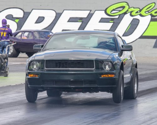

As far as ABS and revolutions per mile, width plays no part. You are looking at the wrong measurement. What matters is tire height so the revolutions per mile are about the same. If you do some digging on Tire Rack's website looking at the specs on different tires, you will find the spec chart which lists, among other things, revolutions per mile for every single tire size for that tire. With a little time and effort you can find the appropriate front and rear tire sizes that have very similar height, and therefore similar revolutions per mile. I ran drag tires on my Bullitt and never had an issue with the ABS because I matched the overall tire diameter between front and rear.

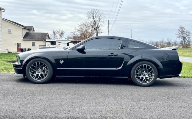

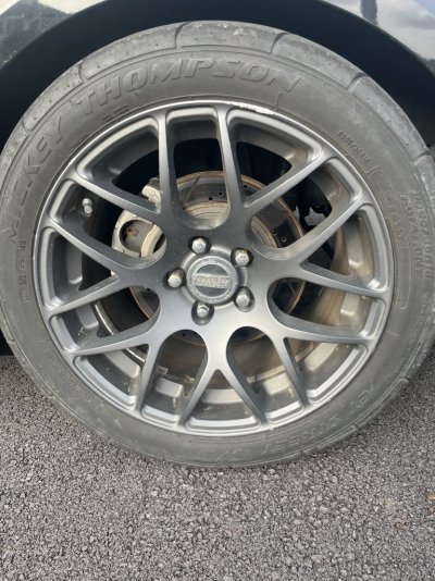

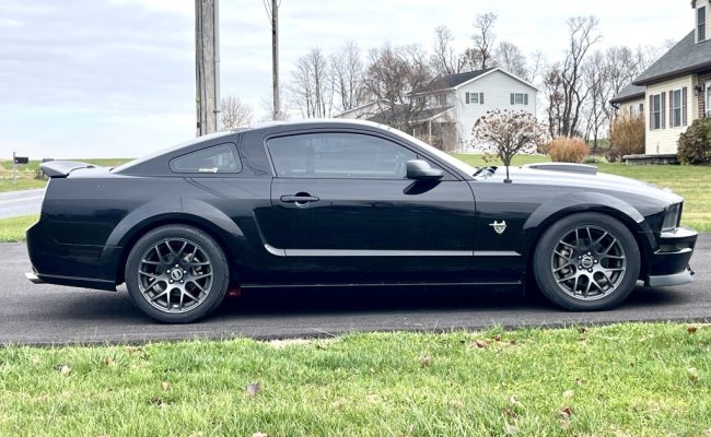

So just had my car in for inspection garage said front tires need replacing to pass. 245/50/18 Nitto in front and 305/35/18 Mickey Thompson SS in back. Looked it up actually front tires are larger than rear diameter wise… what do you guys suggest I go with? I bought the car this way BTW
AdamBorz
Oct 31, 2025
55
39
Bernville, PA
No thoughts on going smaller diameter in front or larger in rear? I can go to a 19” wheel/tire 305/35/19 in the rear which will fill in the wheel well more? Or just leave well enough alone and replace front tires with the same thing??

Nice and shiny… I ended up ordering the 245/50/18 Nittos for the front and am switching to 305/35/19 in the rear. Same width, 1” bigger…

Bernville, PA
Would love to see pics when mounted... :)
I don’t know if I could fit your tire size which are roughly 1.5 inches taller than what I have now. But that would have been another option as your tires are like .5” wider. My fronts are pretty slammed in the wheel wells, don’t rub either.
