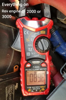

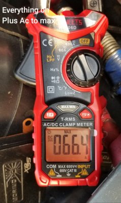

I would like to know if I am doing this right. I went to test my alternator to see if it is outputting the proper amps.
These are the results. The workshop book says that it's supposed to be 80amps @ idle and 135 amps anything over 1800 rmp.
The clamp is on the power wire to the alt.

What you're doing looks correct to me. Just keep in mind that what you're reading is not necessarily the maximum the alternator is capable of, even at high RPMs. You are measuring the draw, how much your lights/accessories/fan blowers require to operate.
The alternator could be capable of supplying much more current, but your vehicle takes what it needs given what the electrical needs are (which could be much less than the alternator is capable of). If you are looking to test the max capability of the alternator, charge up a dead battery while the alternator is running.
Conversely if you want to reduce the load, switch to some LED headlamps / fogs. That will reduce the max load by 10 Amps or so...

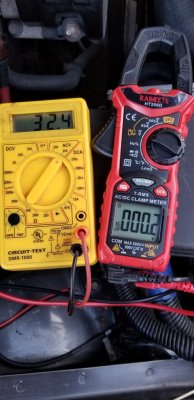

Alright guys. I was able to test it out today and here are the results.
This is a short video of me testing the DCV.
https://youtube.com/shorts/Mmi5TA-eH0I?feature=share
Seems to be jumping around. :/
This is a video of testing the ACV.
https://youtube.com/shorts/uykHEaztP7E?feature=share
Seems to have a lot! :/

32 Vac = alternator is toast. A good alternator will read just a few Mvolts of AC. Like .010 Vac
It's a 3 phase alternator, which uses a total of 6 x diodes. If any of the 6 x diodes fails shorted, what happens is, you end up pumping raw AC into the battery..and also the ECU, radio, and everything else.
Re-run the AC Voltage test, but this time, increase the rpm a bit, like up to 2-3 krpm, just long enough to take a reading.
Raw AC will fry a battery pretty quick.

I only measure a few millivolts of AC on both my 2010 stang GT..and also my 2011 Fusion. IE: .001 = 1 Millivolt. .010 = 10 millivolts.
With 32 vac across the battery terminals, stop right there, ALTERNATOR IS DOA, done, finished, toast, fucked !
As per running an alternator with no load, the alternator comes with a DC regulator built into it already, non issue. You will fuck the regulator up too, if you pump raw AC into it, from excess AC ripple.
32 Vac ripple will screw up the ECU, which is my concern. ( If it's not fried already).
Want some advice. Stop, don't drive the car anywhere, park it. Buy a new alternator. They will probably give you something for the core (old one).
That 32 vac will also fry your battery in short order.

You guys have convinced me to get a new atl (something I was leading towards) but I'm not so convinced that my car is putting out 32VAC. I think the yellow multimeter is not functioning properly when it comes to VAC.
I did the same test on my mom's Pontiac G5 and it too said it was putting out 32VAC.
So I think only the red multimeter is actually accurate?
Either way I'm getting a new alt. I was at a stop light and you can see my headlights and dash pusle bright and low slightly. The faster I go it goes away.
