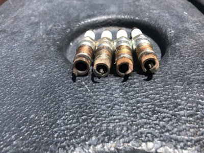

I personally wouldn't pull the head until I ran a borescope into cylinder to verify that needs to be done. By you verifying the upper valve train is still intact just pretty much ruled out any piston-to-valve contact (you've seen upper valvetrain damage if piston-to-valve contact had occurred) thus also pretty much ruled out any valve head contact w\ spark plug electrodes (valve heads would have to essentially detach from valve stems for that to happen) so for those electrodes to have gotten sheared off something else had to have gone thru engine to do that. Here is a picture of what detonation\pre-ignition will do to spark plugs below:
Now I won't definatively say that your plug damage wasn't caused by detonation, but from my standpoint your plug damage looks to be far more mechanical, not chemical.....but I also highly doubt it was caused by internal valve contact as that damage would've shown up in the upper valve train area too......your picture shows that you don't have any upper valve train damage (also why you should've pulled valve covers & physically barred engine over to verify upper valve train integrity). This is why I recommended to pull intake manifold & physically inspect all intake ports in cyl heads for trash & intake manifold for any internal damage (a piece of it's internal plastic can break off & go thru cyl\CMCV pieces if these are still installed & CAN shear off a spark plug's electrodes) then use borescope as Racer47 suggested in cyl to inspect internal cyl area (including valve heads for physical damage....if a piece of valve head did separate from the rest striking the spark plug) for any damage BEFORE pulling head off (may find that all is now clear thus head doesn't need to be pulled).
This why I also typed that from my experiences\knowledge of this engine design, you don't assume things even if you're "sure".......physically put eyes on as much as you feasibly can to verify this stuff......from you pulling another plug from another cyl & finding electrode damage you might want to reconsider........

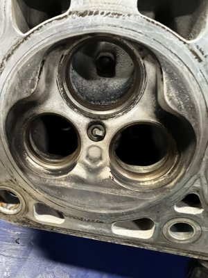

Ya. Seams like the best answer is something inside the cylinder. Wouldn’t a borescope be handy! Can the stock piston even reach the spark plug without hitting the head first?
Probably not. Here is the head and the piston. The spark plug barely sticks out and the center of the piston is recessed.

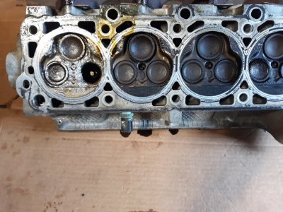

the valve sheared off clean,,, dropped into cylinder and this is the end result,,,
i had parts of the valve in the intake,,,,

Holy guacamole I didn't expect that. With a borescope there's no way you could miss a holed piston. That totally sucks.
On the positive side there's a wide availability of used 4.6 3V engines since they were also installed in 06-10 Explorers, 06-10 Mercury Mountaineers, and 09-10 F-150s so it shouldn't take long to get up and running again.

Broken intake valve, was most likely a cam timing issue. It can be hitting the piston for some time before it snaps off. Had it happen on a motorcycle engine, chain was off a tooth. Ran for a long time before self destructed.
".........truth be told i did just put new cams........" hmmmm.
