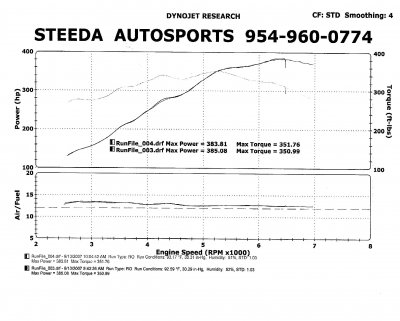

Here is that dyno sheet I was talking about. I assume that everybody is familiar with Steeda. I figured a nice outside source for dyno numbers would be helpful.
This car has the following mods
Stock Shortblock
Livernois Stage 3 heads
Comp Cams 127350 (Stage 4) cams
Kooks longtubes
CAI
Steeda Tune
I can't remember the exhaust system right off hand. I will have to look for that.
If there are any questions or anything just let me know.
Thanks
Mike

So the conclusion is that 451hp peak is roughly accurate for the stripped accessory engine?
Not just that, but with no drivetrain loss! 450hp (as tested in the article) is possible when no drivetrain loss is factored in (15%) and no accessories are present. The article holds water. The numbers could be slightly inflated, but not by much.

It's not BS... Livernois just proved that the numbers could be slightly inflated, but not by more than 10-15whp. JIMIII's car is a good example of NA power potential, as is other cars Livernois has put together.
Just because it's a 4.6 doesn't mean it can't produce big numbers. Same as NA LS1s that put down 475whp NA. I don't think 380whp is that far fetched.
No, they didn't. All Mike really said was that some of the numbers might have been flipped around. That just doesn't explain how EVERY FREAKING HP NUMBER IS WRONG (except for 4!). These are NOT close. hp = torque * rpm / 5252. It's a law, not a suggestion (actually, it is a DEFINITION which is even better than a "law of nature" or such crap). So if someone tells you that they made 300 lb-ft of torque at 5000 rpm and 600 hp at the same rpm, you KNOW they are full of shit. Assuming the torque as correct, they only made 286 hp. If the hp was actually correct, then they HAD to make 630 lb-ft of torque to produce 600 hp at 5000 rpm.

451 x .85 = 383.35. That right there figures the 15% drivetrain loss. 380whp CAN and HAS been done. There's members on here with 350whp that run heads and cam packages that are much milder than Livernois stage 4 heads and those comps.
I'm not arguing about the torque and hp curve intersecting at 5250, nor am I arguing about numbers being flipped and what have you. I'm arguing that 451 before drivetrain and accessory loss is completely plausible.
