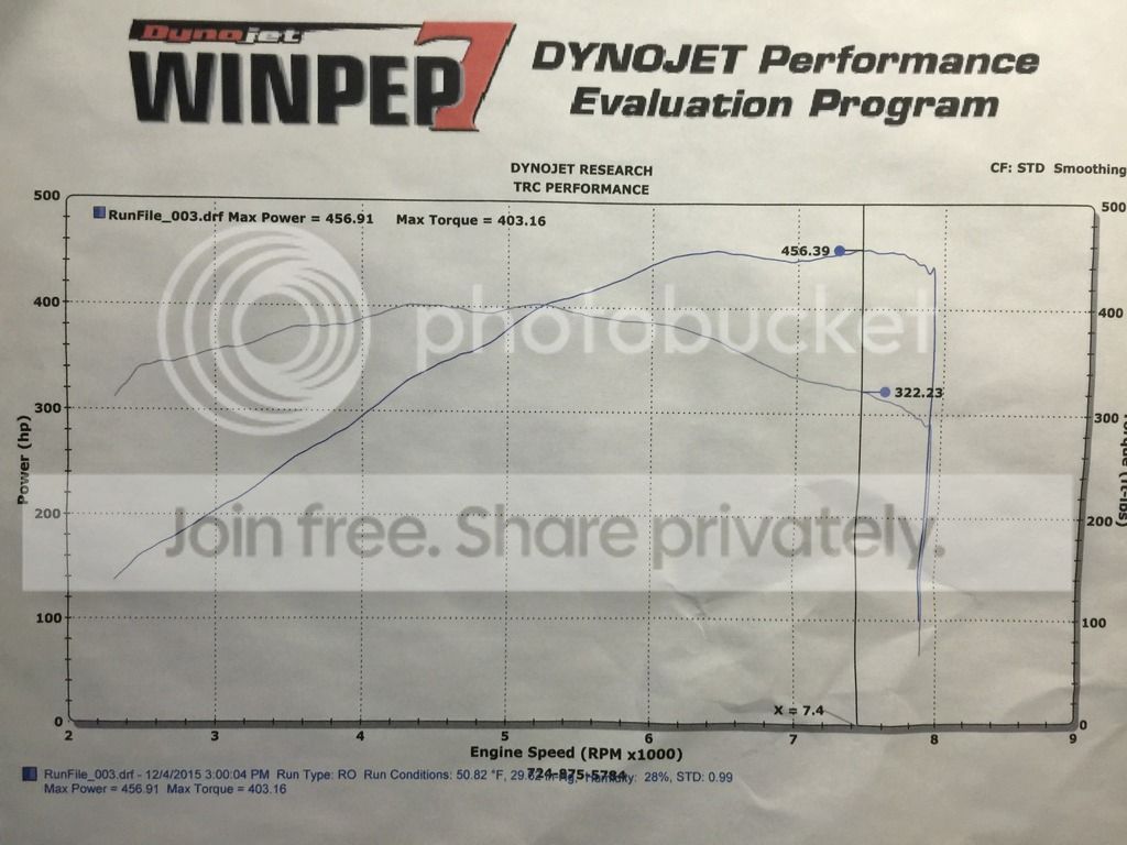

Driven with the CobraJet intake yet? Wondering how the street manners are in the low-mid rpm range with the long runners. Have any before/after dyno runs for torque and hp band comparisons?
Just put the car on the dyno yesterday. Pump E85, tested at 83%, switched it over day before dyno so the mix was a bit low, after looking at logs Shaun said the ethanol content was a little low, but he didn't think it affected numbers much. Ran car hot all three pulls within 5 mins, difference in numbers between the three could be considered noise, within 1hp/1tq. Shocked to see the kind of low end torque the car makes. Was making 350 at 2500. Definitely a slight loss in low end torque compared to the stock manifold/airbox combo, but this setup makes usable power from 3500-8000. This is an AED tune with only one datalog sent in for the CJ setup. Drivability is excellent, only thing I miss over the stock setup is the throttle can't be made as progressive so it is much touchier than it was with the previous setup, although I am sure we will work that out. Will likely have an extended dyno session to find a bit more power in the combo, and I will likely have the manifold ported.

Don't happen to have a baseline stock motor pull on that same dyno in similar atmospheric conditions do you?
That is a broad torque and hp curve. I'm surprised to not see a dip or bottom end of the curve loss of torque with that tunnel ram manifold.
Nice fat usable power from ~4250 to ~6500 with a thousand+ rpm of 450hp.

Good lord.
