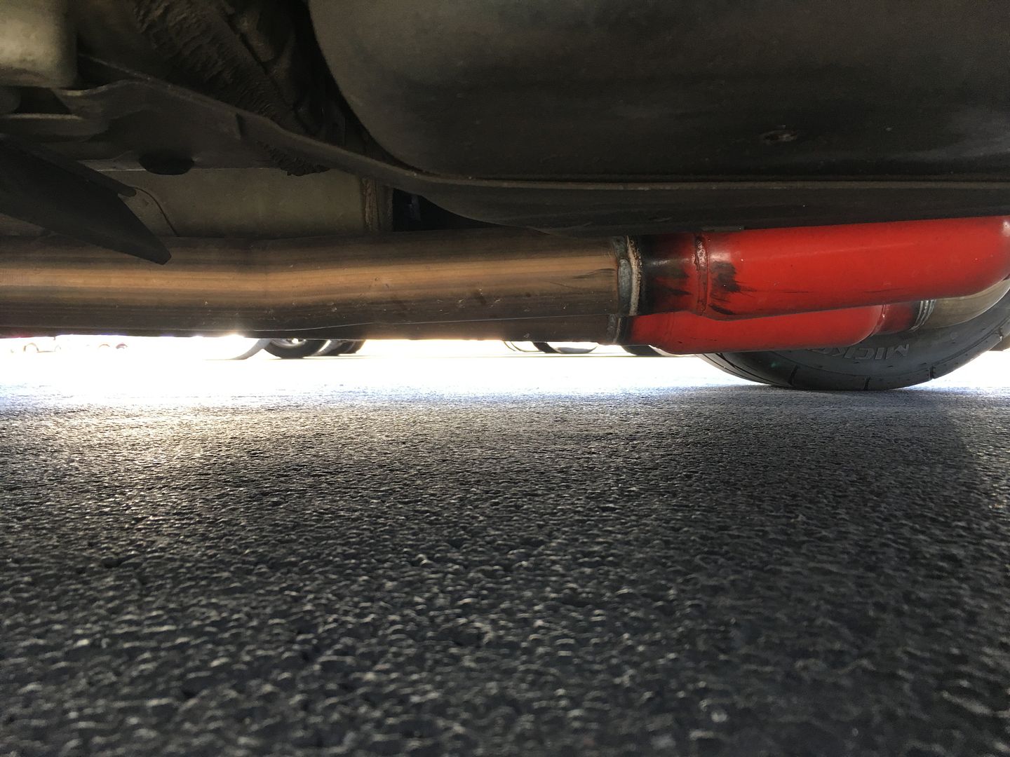

Beat me to it. My 17 gt has a set near the tail pipes and they definitely work. I have a Bassani catback (no longer produced) that replaces the mid mounted resonator and deletes the axle backs. In videos I’ve seen its pretty loud even with cats but mine is pretty tame. Even on the interstate I get little drone. Actually I’ve been wanting to experiment and get muffler deletes to delete the j tubes to see how much of an effect it has on tone while recording it back to back.
