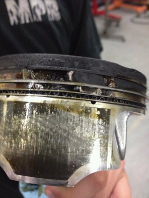

Speaking of BBR. Procharged 5.0. Couldn't get into another shop right away so went bbr. uploadfromtaptalk1367452356221.jpg
