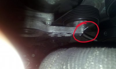

Anyone have suggestions as to how to remove a belt tensioner assembly that broke in the area where the 1/2 drive fits in while trying to replace a belt?
I'm a little perplexed. I don't know if it was a bad casting or what but I barely put any effort into turning it just shattered like it was plastic.

See the circled area where the 1/2 drive goes when you are trying to release tension. As I started to turn it clockwise as per the manual, the circled end here broke off.
I do not know if it is safe to simply unbolt the tensioner when it is under tension.

If you have a pipe wrench you can grab the end of the tensioner arm and pull it back enough to slide the belt off.
edit- just realized you need to push it instead of pull it. Might still work, although if you can approach it from underneath and pull with the wrench it will work better.

Mission Accomplished!
Skwerl- Pushing from up top did the trick! Everything is working again- I don't have to set it on fire..... Went and picked up a new Tensioner and pulley. Got that in, man that is a tight squeeze with the turbo piping

See if you can jam a 3/8" ratchet in one of the other holes, or wedge a long screw driver or pry bar lengthwise between the pulley and arm and then under the mounting base, then push down and slip the belt off a different pulley. If that makes sense.
