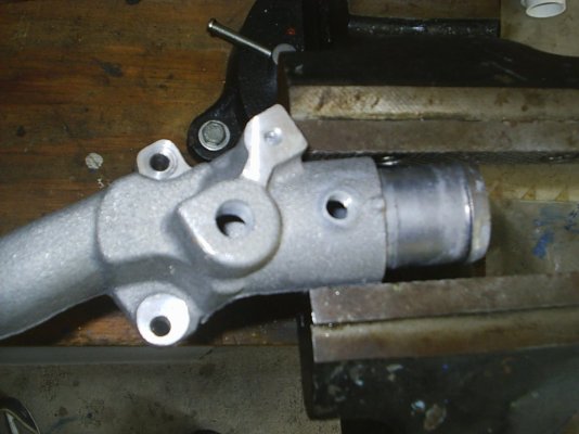

I have a 05/06 crossove I drilled/tapped, and used for quite a few years; removed and listed in parts for sale on here, but here's what it looks like:
one hole used for temp sensor (1/8" npt), another with 1/4" npt.

My car is a 2009 GT. The crossover manifold does not have a hose outlet per se; the thermostat drops in on the driver side, covered by the thermostat housing, and the upper radiator hose attaches to the housing. I can tap into the passenger side pad as Dino Dino Bambino and BamBam06 suggested. I can't figure out how to avoid metal drill or tap filings getting into the coolant passages (or removing them) without disassembling the intake and crossover and drilling the tap on the bench--something I would prefer to avoid. Also, I have Mishi's pricey radiator hoses and don't relish the thought of cutting them up. So, I guess the driver side block plug is my remaining choice?
