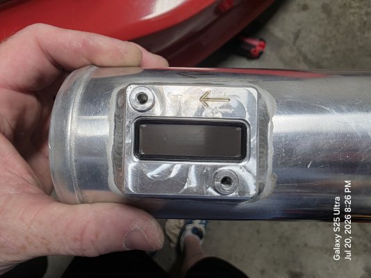

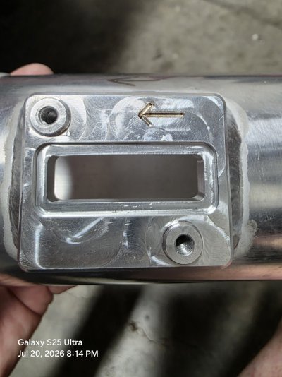

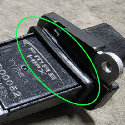

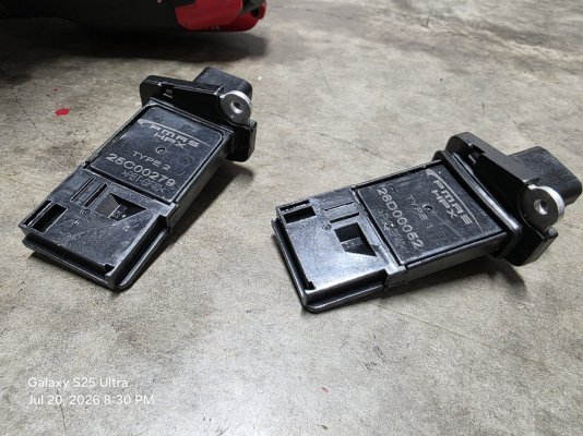

I couldn't find the original maf, but did have a second pmas that was damaged in a freak cleaning incident. Story for another, but certainly worth hearing lmao. You can see in the attached pictures that flange is clean. Both maf's appear to be setting flush. I swapped out the gasket I used previously with the one from the damaged maf. Actually appears to leaking worse that last time though

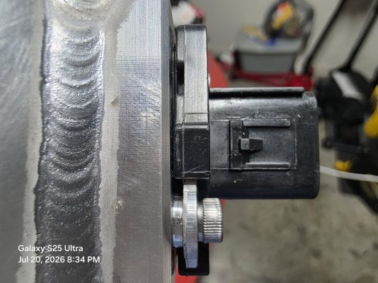

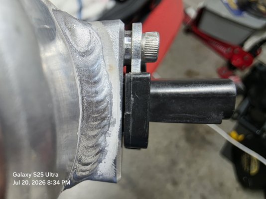

Yea the maf does touch the studs when it snugged down. The maf flange came On3. I have another flange somewhere, but I'm pretty sure it looks exactly like that one.

That thing is just not seating. How odd that you added rtv and it still leaked.

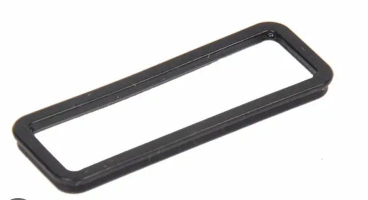

I'm pretty sure my mega maf or the weld-on bung came with that gasket. I'll take a picture for you tomorrow.

File the studs flush with the flange and do not over tighten the bolts.
another thing to test is the welds around the maf,,
if you got a pinhole crack in one ,, that will cause it .,.
i only say that because it should seal with what you've done ,
unless the studs are too big and not letting the gasket compress , but it still looked like it was..
that is of course, if a thicker gasket dont solve the problem
