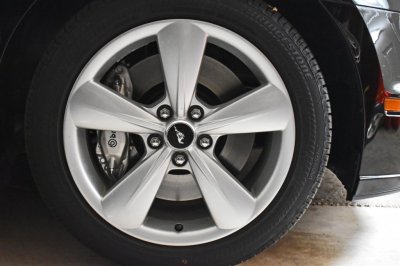

Just for reference. S550's stick out another 1/4 inch over S197's. But everything is bigger, so they don't fit well where the S197's might (as far as rims are concerned, especially 18")
S550's
S197's

That would be 17mm plus 6.5mm. The S550 will need at least a 1 inch spacer.
