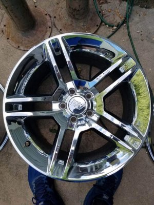

Does anyone know if there is full brembo brake kit available for a 2009 mustang GT running with 18”s. I know ford/American muscle offer one but you need 19” to fit and I really like my 2010 GT500 wheels but I desperately need a brake upgrade. Stock brakes are terrible, now running 30% more power so upgrading is a must!
any help is greatly appreciated
stkjock
---- Madmin ----
Jul 10, 2007
40,248
3,166
Long Island NY
what 18s? 18s will work with Brembos if the wheels are manufactured properly, IE - all GT500 OEM or fitment wheels

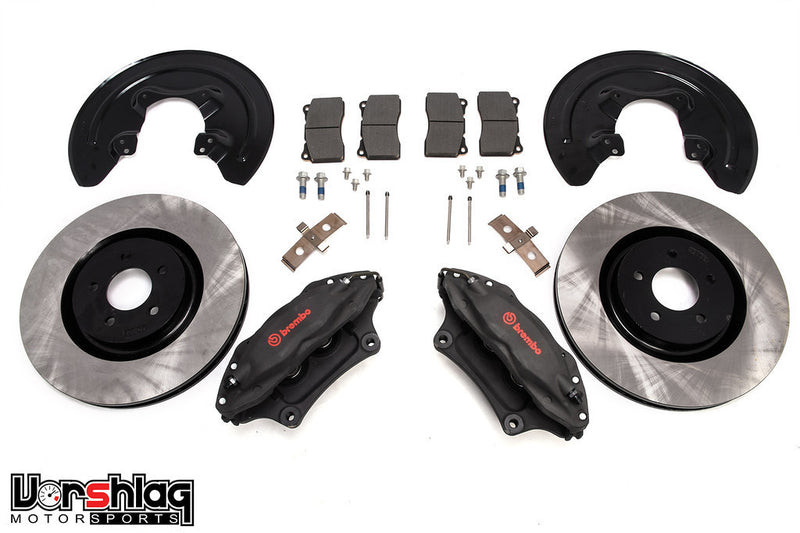

We sell an S197 Brembo front brake upgrade kit with 100% new, Ford sourced parts. No eBay, no junkyard, no China, no rebuilt anything.
https://vorshlag-store.com/collecti...197-mustang-14-brembo-front-brake-upgrade-kit
We offer brake pad options, backing plate options, and even brake line options.

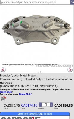

What do you think is the sweet spot for 14" front rotors? They range from $25 each at rockauto up to $400 each for Girodiscs.
Juice
Aug 24, 2017
4,622
1,905
OEM Ford. Anything cheaper is junk, anything better is more expensive.

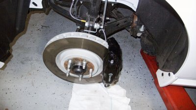

One last question. I bought the 4piston front brembo kit and the rear rotor kit 13.8 rotor, my question is about the rear calipers. Don’t see anyone selling kits with the rear calipers. Is it unnecessary or should I buy like a 2007 Shelby 500 ones or aftermarket ones?
AHaze
Dec 31, 2019
313
173
Edmonton, AB
I assume those are the '13-'14 GT500 rear rotors? Those cars used the same rear caliper as every other S197 with a different bracket to make it work with the larger caliper.

Yes the 2013 GT500’s ones. Kit came with the caliper brackets too
You should be set then. Just mount your existing calipers to the new brackets. I painted my rears black after installing the front Brembos. Makes it less obvious that it's a lame-o single piston slider back there.
