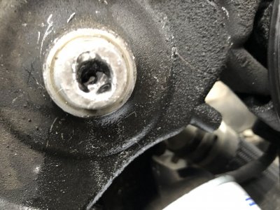

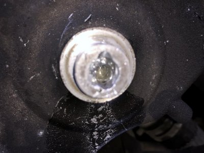

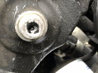

Hello everyone, new to the forums.
i just recently purchased a 2008 gt, been replacing old parts and just performing overall maintenance, went to change idler pulley i had a bad whine. While i was removing the idler pulley bolt it snapped, was able to drill it out no big deal, went to hardware store got a new bolt, this time steel bolt, bad idea... well i almost had everything in and tight then bolt head snapped.. now i have been trying to drill it out for 2 days, no success. not enough room for my more powerful dewalt drill. not sure what to do? here are some pictures.

If you can't get a good angle and a good bit in there you will be replacing the timing cover

im gonna try to remove fan shroud so i can get better angle, hoping to not have to replace timing cover very $$$

okay, so today i removed cooling fan from radiator and was able to drill out bolt, but now threads are ruined gonna have to use tap and die kit...

Glad you got it out!
Next time try a tap to remove it.
And also when you rethread the hole you need to make sure its square. If it isn't, your pulley will be off and cause issues.

Update ** finally got new threads tapped.. started right up running like a champ no issues.
