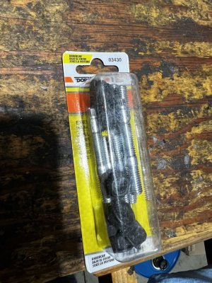

@skwerl has you covered. Pretty common issue, when working on semi-older motors. Now you'll have fresh anchors f/ the project. :D

These are labeled as 62mm long. They also list some for fords that are 72mm long, but the longer ones interfere with installing the oxygen sensors. I just went through this replacing a cracked exhaust manifold on my 5.4 in my F350.
