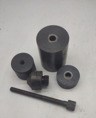

I would buy a tool kit and sell it again.
Not sure if this is the right one (biggest problem I would have is to tighten the bolts on ride height)

Check your local auto parts or tool rental shop.
