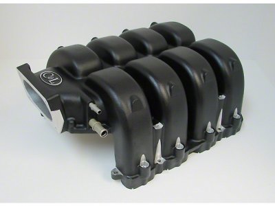

Hi, The C&L in the image came off my 05 just before the Whipple went on. The car had about 5000 miles on it at that point. Figure $375 + shipping if you're interested. I also have a Diablo tuner and a manual transmission Tri-Ax shifter if your looking for the total package.

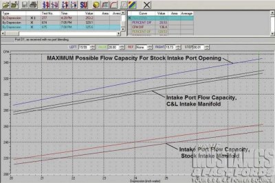

Some place in my extensive inventory of saved pictures I have info about the flow of the stock intake manifold compared to the C&L unit. The C&L unit definitely out flows the OEM, but the OEM is no slouch. The OEM flows around 260cfm as I recall. Which is more than any 3V head ported or otherwise that I've seen.
EDIT: Amazingly I found it.

Yeah the stock intake manifold with CMCV delete flows 255-260cfm per runner @ 28in H2O depression, while stock unported heads flow 225-235cfm per intake port.
The C&L intake manifold flows 325-330cfm per runner while most 3V CNC ported heads are in the 270-290cfm range per intake port. Therefore the C&L IM far outflows even the CNC ported heads and is way overkill on stock heads.
