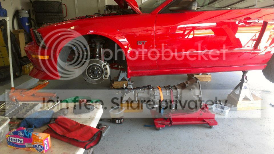

Though this wasn't a clutch replacement, you can see in the picture that the principle is the same. Car is on *elevated* jackstands since I needed to remove the transmission from under the car and there just isn't enough room to slide it out while in a transmission jack.
Note: Removed the transmission to rebuild it myself awhile back.
As others have said, a transmission jack is IMHO a necessity. I also found that tilting the engine back slightly helps quite a bit with getting everything lined up. Even better is when you remove the upper intake and tilt it back even more. Oh yea, you hold the downward "tilt" in place with a small ratchet strap either way.
If you don't want to slide the transmission out from underneath the car, and don't mind a tight space, you can move it towards the back of the car until you run out of room in the tunnel.
Notice you can leave the shifter on the car. Even better (and a damn much easier) if you leave the boot in place on the shifter so when you reinstall you just push the boot up from the bottom and it pops into place.
