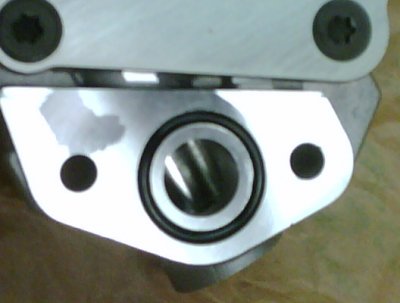

This "O" ring special" is cut in the back of pumps by MMR (and now JDM)
I wouldn't compare MMR's machine work to JDM's o-ring machining process. Here is one of JDM's GT 500 oil pumps that has been machined for an o-ring groove. Notice JDM's o-ring is centered on the housing
I would not either..
looks like they leave more material also,by using a bigger o-ring
