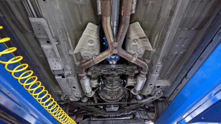

PS--here's a picture of my setup where I had 2 Magnaflow #5461336 CARB-cert EO#D-193-140 TWC aftermarket cats welded in after getting the Kooks Hi Flow Race cats cut out in the very place I'm talking about..........no issues w\ cats working at all........even w\ LTH's, aftermarket non EPA-legal cams, aftermarket non EPA-legal TB, OEM IM w\ CMDP's installed & an OEM Ford Bullitt 83mm CAI that didn't come OEM on a GT thus is "non EPA-legal" & now w\ me doing all the tuning on it. Check out my last copy of a Forscan Mode 6 scan w\ IM Readiness report to see what I'm talking about (EVAP didn't complete due to gas tank being full when I pulled this out of my ECU after doing a KAM reset to put ECU into learning mode to run this check test just to see where all is at currently)................
