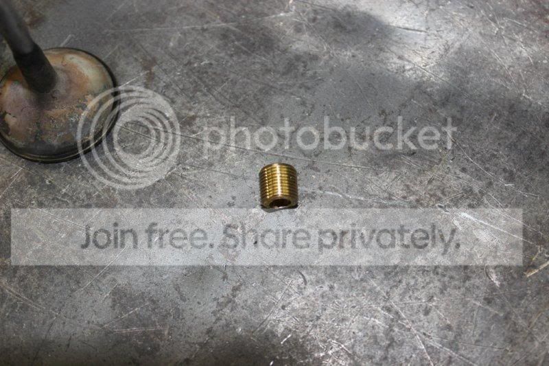

First off this is not a post to bash Livernois or those that work there. The purpose of this post is to outline my problems and to let you decide.

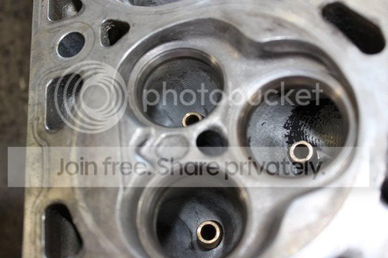

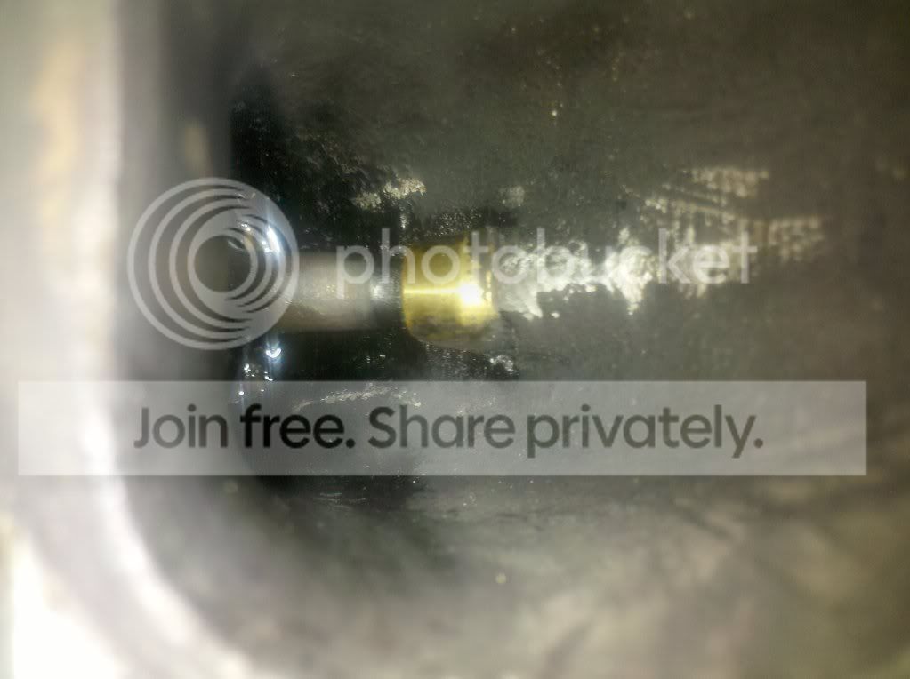

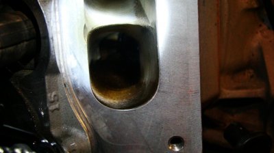

My problem first started about a year and a half ago when I had a guide failure on my passenger side Livernois Stage II head while driving 15 mph. The car had/has not ever been raced. The guide in the #1 cylinder pass head got stuck. This caused the valve stem, rocker and follower to break. Fortunately I shut down the motor as soon as I heard the problem. Still the broken valve tapped the cylinder but no catastrophic motor issues resulted. Here are some pics (notice that the guides are bronze, you'll see why later)
Now you see it.............
Now you don't....

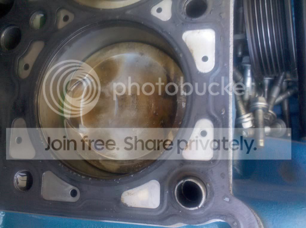

This is the top of the #1 passenger side piston. Notice the coolant on top

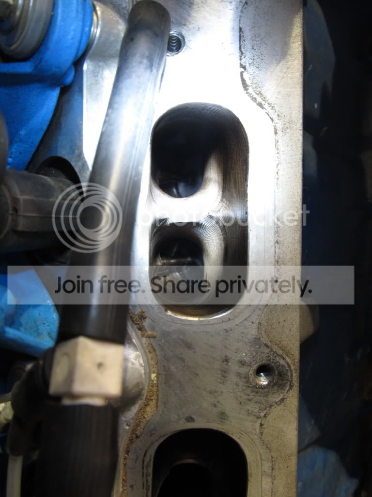

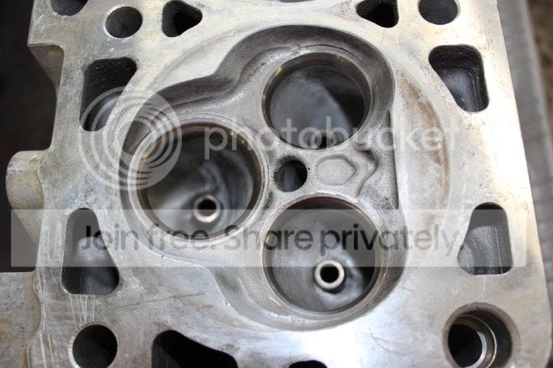

After the initial problem I talked to Dave Ameduri at Livernois. Eventually he told me that Livernois got some bad guides and had changed suppliers. He insured me that this was an "isolated" case and it wouldn't happen again....
Livernois swapped the heads and I put them on the car. This happened while I was on leave for deployment. I came back, took my car to Phoenix to get retuned and issues devolped.. The car wont pull past 6500 rpm. Pull the intake off and this is what is found in the passenger side intake runners:

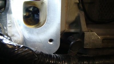

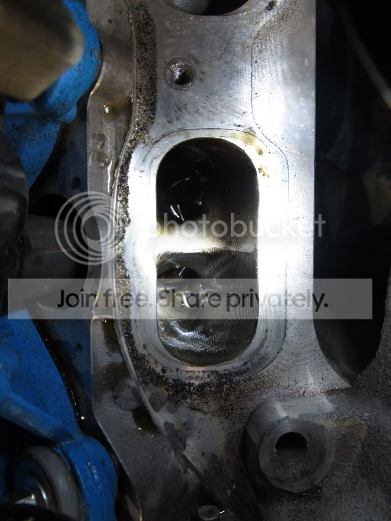

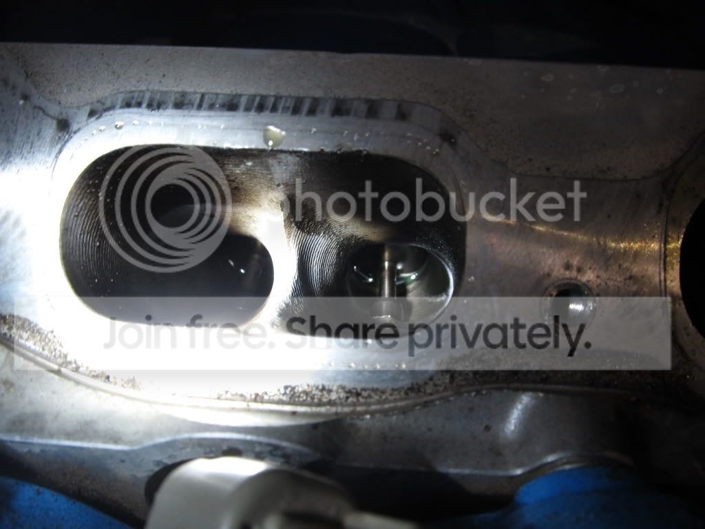

These are pics of the passenger side intake runners, notice the water and coolant sitting on top of the valves:

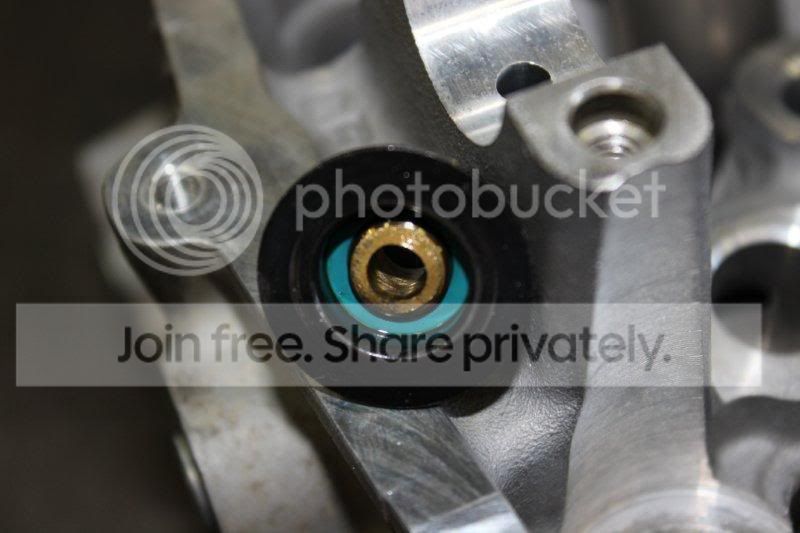

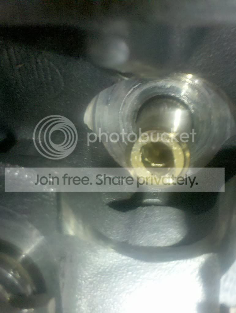

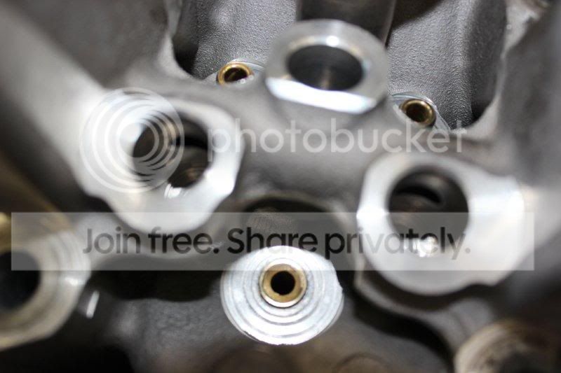

Now these are pics of the PASSENGER SIDE head. Notice the guides???? If not refer to post #1

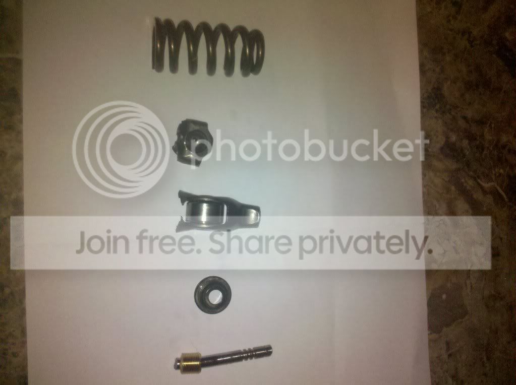

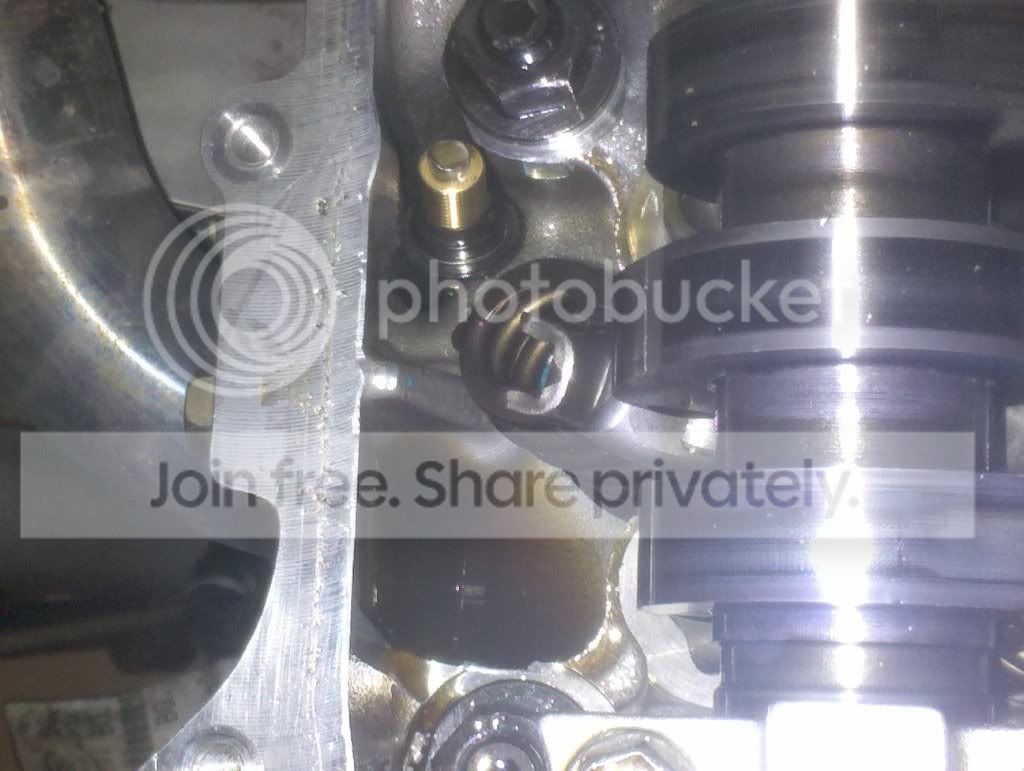

As soon as I see the problem I tell the tuner to stop touching the car. We talk and we decide to send the longblock to an independent builder to let him look at it.
I sent the long block to L and R engines in California. I did not tell him the problems I was having but asked him to tear it down and give me his unbiased opinion. Mind you I have never meet this guy, Ive only researched his shop through the internet and other sources.

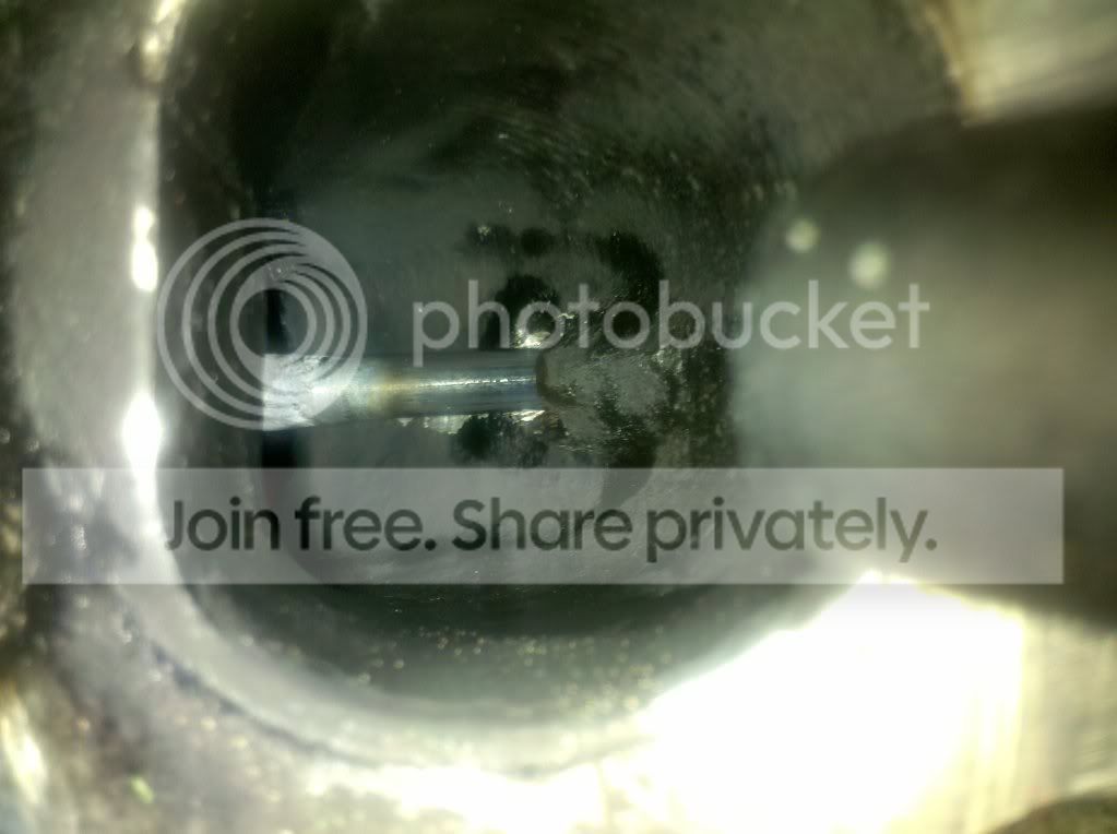

After pressure testing the heads, he told me that the passenger side guides were leaking slightly and he sent me these pictures of the drivers side head:

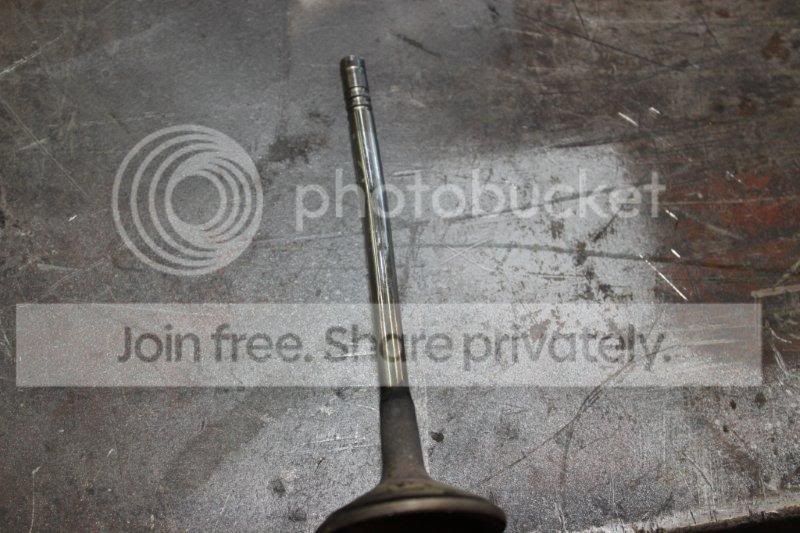

Two exhaust valve guides were broken and all 4 exhaust valves on the drivers side were bent and stuck in the guides. This caused the exhaust valves to stop functioning as designed.

To back track a bit. Remember the bronze guides???? Dave tells me that only Stage III heads have bronze guides. I tell him that I ordered and paid for stage II's.
I tell him that the first issue I had, that the heads (They saw the pics) had bronze guides. They sent me back a passenger side head that had iron OEM guides in it.
I being naive trusted Livernois and put the head back on the car without inspecting it. Turns out the Drivers side head and the passenger side head were different.

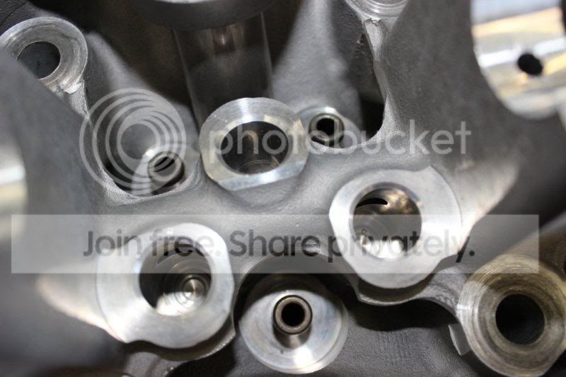

I can completely sympathize with you right now. I made the decision to have Livernois build and tune my engine a couple years ago based on this "reputation" also. In addition, I only wanted one shop doing the work so if something went wrong I knew who to hold accountable. The build took way longer than originally quoted. Hold up was the new head castings, core shift, etc. Dan Millen personally told me the new castings and CNC program were going to be worth the wait so that is what I did.
Finally got the car finished and back. Immediately I knew there was a problem. Big oil loss and blue puffs at start up. Livernois encouraged me to drive the car for the season and they would fix it over the winter. While they were "fixing" it I went to the shop to inspect the work. I didn't get to see the cylinder heads for whatever reason but I did ask to look at the cams. Good thing I did because they had been damaged on the mechanics cart (as it was explained to me).
Again after a long wait I got the car back. I was told the same story about the valve guide problem with their supplier and it was now corrected. I put a few miles on it and went to drop a borescope into the combustion chamber through the spark plug. Went to remove the spark plugs and the socket was the wrong size. Changed sockets, pulled the plug and found Livernois had swapped my highly touted new castings back for the old with out ever discussing this with me which in the end has now cost me more time and money.
Didn't really drive the car this summer because the thing just gets too hot. It drove better and more consistent before building the engine. To address the heat, this winter I took the blower off. While off, I peaked down into the intake ports. All looked good but the very last intake valve in the number 8. I was also surprised by the impressions left around the intake port by the OEM o-ring. The intake port had been CNC'd so long it was cutting into the cross section of the o-ring leaving a stepped transition and half the cross section of the o-ring to try and make a seal.
I mic'd the intake ports and OEM o-rings trying to make sure I got as straight as possible across but there may be a little variance. What I saw was th long end of the intake port measured 2.655" with the short being 1.164". The measurements I got on the inner diameter of the OEM o-ring were 2.654" (L) x 1.489" (W) with a cross section of .0575". Again these might be off by a couple thousands here or there but should be pretty accurate. At my request, another engine builder/performance shop, who has had problems with Livernois heads and now uses RGR, measured the intake ports on a set of RGR heads for me. They came out 2.5xx" (L) X 1.2xx" (W) (sorry I couldnt find the email with the numbers to be more exact).
Off to Livernois again to discuss this issue and they conveniently have a set of StageIII heads on display. Pulled out my micrometer while waiting and the length of the port was 2.5xx". I ended up speaking with Andy Ricketts who thought the oil might be due to a poor spray pattern from one of the injectors. We placed the injectors on the flow bench and nothing really stood out but one injector had a suspect pattern. While there Dan Millen also threw out the idea that there might be a leak around the manifold on that cyclinder. (With only half the o-ring trying to make the seal I bet that is a good guess.)
I also discussed the port size with Andy Ricketts and the impact it has. This discussion lead to the manifold being blamed as the culprit for any problems...makes sense right:wtf: I agreed to run the car this coming up season with the cleaned injectors and make sure there were no leaks. At the end of the season the cylinder heads will be inspected again. According to Andy, Livernois stands behind their product!
OP, I hope you get this resolved in an amicable manner. You are probably much better off just moving on and having another shop repair them. My stomach turns over everytime I think about my car and dealing with Livernois at this point. I just wonder how many "bad batch" cylinder heads are out there waiting for other unsuspecting owners to discover.

I was asked to have a look at this and see if I could offer any information. Read through the thread and issues with the head. I'm not normally very involved with cylinder head matters so I'm not really too abreast of this situation but I did try and get some info and get filled in.
I spoke with Dave and am sorry if there were previous issues with the product or service in any way, being that I'm not directly involved I don't feel like an apology coming from me means much to the OP, but for what its worth, nobody likes to see somebody struggle with a product or service or anything like that, so sorry that's taken place.
By looking at the pictures of the head and the resulting breakage and going off the fact that this has happened twice now, with the same head, and the same exhaust bank of valves I'm very inclined to think that something is wrong with that casting. The guide bores are drilled at the factory and are an exact angle and placement in relation to the the rest of the components in the head. If the bores are not aligned properly in relation to the camshaft follower then a scrubbing effect will happen which will bend the valve and eventually cause a failure. Just taking a guess based on what I see.
I bring this up because if you use that same casting and put a bronze guide back in it and hone the guide and cut a new valvejob it won't fix the geometry. On top of that you won't really have any good way to catch it or know if its wrong. The only way to check it would be to indicate in the guide bores between that head and a known good head, or a factory print. But just redoing the work using the same casting again could result in the same problem.
After talking with Dave he said that Livernois does want to work with the OP and get the head back to see if it can be checked and verified as defective in the guide bore.
