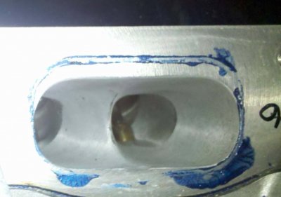

Maybe if pictures don't work, how about some numbers
I went out and measured the distance between the edge of the intake port and the oring groove on my stock ford manifold, which turned out to be 1.677mm (.066 in). I measured 7.82 mm for the hole diameter, and it is a 6mm bolt. The factory intakes have .83mm thick o-rings (which center the bolt in the hole, so lets assume an bolt o-ring could be compressed half the thickness of the o-ring, .83/2= .417mm (.016in) If one assumes the location is controlled by the oring squish, the location could be off by .016 in. If one assumes the o-ring is totally squished, there would be a maximum of 1.82 mm (or .072 in.) offset. Lets be optimistic, and assume it's controlled by the o-ring squish. I measured a stock head at a width of 61.45mm (2.419 in), and a stock intake at a width of 60.8mm (2.394 in), a difference of .65mm (.025 in). Subtract from that the o-ring squish, and there is .65-.417=.233mm (.009 in) of margin with a stock head / manifold of exposing the o-ring groove. So if one could control the cnc fixturing to within +/-.005in, there would only be .004in of available material to port in the head width before have a risk of exposing the o-ring groove. So a maximum port width woithout or-ring exposure would be 2.419+2*.004 = 2.427 in. or 61.65mm. The Livernois port width has been documented at 2.6605 in. 2.6605-2.427=.23 inches beyond o-ring exposure.
All the math above, is for just exposing the o-ring groove. How far do you have to go, considering the flexibility of the o-ring before it actually can get underneath the o-ring and cause a leak? I also measured the o-ring groove width at .12 in. So if one adds the two oring groove withs (one per side) to the stock port 2.427+2*.12 = 2.67in to completly expose the o-ring. the 2.66 in wide livernois port is only .010 inches less. I would say, by the numbers, that there is a high probablity of blowing out an o-ring.
In regards to the casting changes and variables in the intakes:
All of the intakes, whether it be Whipple, Roush, KB, Edelbrock, C&L all have the CNC'd o-ring grooves. As such, they are reasonably controlled, and highly repeatable, regardless of who's intake it is. These grooves aren't controlled by the casting, they are controlled by a CNC mill, and CNC program, and are likely all cut with the same program based off of one single set of datums for the intake. They will have very repeatable groove profiles, and very repeatable locations for both side to side and back and forth locations. Any intake where the casting is off so bad as to go into the o-ring groove would be scrapped right at the point of machining. The biggest tolerance would likely be in the clearance between the bolt holes and the bolts which attach the intake to the heads. To go a little way into the o-ring groove may be o.k., but to make the port so damn wide that i't's potentially only .010 inches from completely exposing the entire o-ring groove is beyond risky. If the math doesn't work, I guess I'll post more pictures.

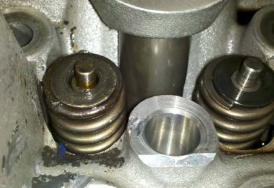

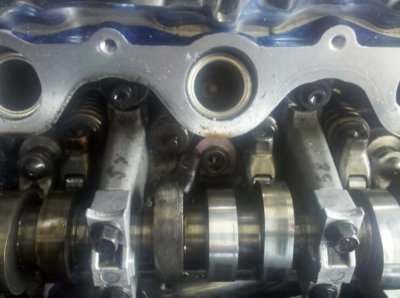

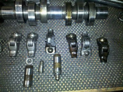

I bought Ford Racing heads from a Ford Racing dealer, which turned out to be $1869.00 a piece repackaged Livernois stage 3 heads. So I'm three levels seperated from Livernois on these heads. (The Ford Racing dealer, then Ford Racing, and then Livernois). Due to this, and also wanting to know what the issue was that damn near caused me to destroy a $20,000.00 motor when I was one keeper away from sucking an intake into a cylinder, I decided to deal with these issues externally, believing that the time, effort, and money involved wouldn't be worth the effort in trying to handle this thru Ford Racing / Livernois.
It turned out to be a loose guide, and upon further investigation, it turned out that every guide except one was loose in the passenger side head. The place I took the heads to also said that they had never seen seals so tight before as well. So there was likely guide oil starvation issues involved along with the loose guide. The pictures of the damage of the valve train are shown below. The secondary issue of the porting only came about after looking at other threads and doing some detective work.
I don't care if these heads are on the fastest 3 valve in the world, or that hundreds have been sold without issues. There are at least 7 that have had issues with guides, seals, or/and CNC porting issues with these heads. Amoung those seven, the ones who have dealt with Livernois have had months (if not years) of going back and forth, and in some case have had multiple sets of heads and multiple engine rebuilds. Welding up the o-ring grooves on an intake that came with a $7200.00 supercharger kit is not an acceptable option for me, and I suspect it is not an acceptable option for the others as well.
Because I handled the issue outside, I don't expect any compensation from Ford Racing or Livernois. But I do expect that Livernois step up to the plate, make a statement about what they are going to do to resolve guide issues, the seal issues, and the CNC porting issues in the future. It would also be nice to see a direct response instead of being passed back and fourth in a third party fashion.
Belinda
See below for pics of my damaged valve train, port imprints showing definite o-ring exposure, and a re-post of an o-ring showing evidence of blow by.

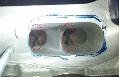

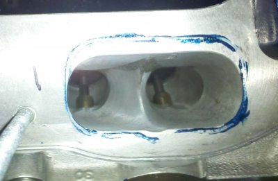

I originally saved the attached picture from Belinda's post to open with MS Paint and simply cirlce the valve stems to pose a question. When I did it opened at full magnification and I can see from Belinda's imprint, the port job looks exactly like mine. It tends to be deeper into one edge of the gasket than the other. So now my one question has turned into a couple questions...
First, to address my reason for the circles, do these valve stems have different wear patterns on them or am I missing something (see attached photo "port 1")?
Do you still have some of your old gaskets? Do they look like mine (the one you previously attached is only completely blown through on one edge. The other edge is only partially encroached upon. I think I posted a picture of one earlier in this thread)?
Is your Kenne Bell intake manifold cast or CNC'd? Seems odd that manifolds from two different manufacturers would leave very similar impressions on cylinder heads from the same manufacturer?
One last question for you Belinda. Working under the belief that what I am seeing is in fact correct, what did you do to get these "special" CNC'd cylinder heads from FRPP of all places?
Since I am here I also wanted to address what appears to be the ascertain that OEM parts do not suffer from core shift and all of this is therefore a problem with the manifold production (Which is still an invalid point since the gasket is exposed to the port on both ends. Over cut is over cut. Does not matter if it is shifted one way or the other)....
I did not notice different wear patterns on the stems. What you may be seeing is oil residue, as I was having issues pulling huge amounts of oil into the supercharger. I believe is a result of pulling more vaccum on the inlet side of the throttle body than the engine did origanally with the stock heads / cams. I resolved that issue by plugging the vaccum port on the SC intake tube and installing a catch can / breather. I can tell you that the oil was a pain in the butt to get off the pistons, valves, intake ports, and combustion chambers. I think what you might be seeing is some of that residual on the valve stems.
Unfortunetly, by making the imprints, the o-rings were covered in half dried blue automotive paint, and were pretty useless afterwards, so I trashed them. They also only had 1100 miles on them, so I doubt they would have had much discoloration. They were sacraficed in making the imprints.
The intake is cast, the o-ring grooves are CNC'd. The stock intake has an even thinner cross section than the KB intake. I would expect every intake from just about every 3v intake manufacturer to look about the same on the port size. Because Ford just didn't leave much wiggle room, they all have to be close.
Ford Racing didn't have the "Hi-Flow" CNC ported heads untill sometime in 2010. I looked at the flow numbers, and they were pretty much a match to the MMR and Livernois Stage 3 heads. (Now I know why they were similar). Having read oodles of head nightmare posts, I thought to myself: Ford Racing wouldn't put their' name on it if it wasn't thoroughly proven? I'll never make that assumption again. I had no idea they were farming the heads out. I bought the heads in Mid March of 2011. (roughly a year ago.)
