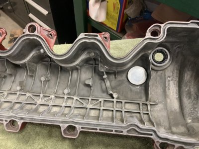

This is the setup that works for me. Remove the PCV tube from the valve cover. I ground the rivets flush to remove the baffle then pulled the tube out. I found fittings at Summit Racing to install in the valve covers. The right side simply replaces the oil fill cap.

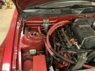

You can see the 3/4” hose adapters on the #12 AN fittings on each cover and ultimately, the Moroso vented catch can on the firewall. This system has no connection to the engine intake. It freely vents the crankcase and no oil is forced out through the seals or gaskets.
