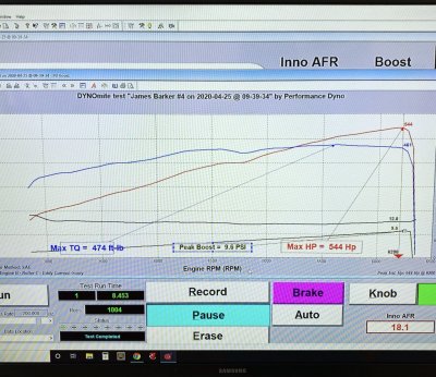

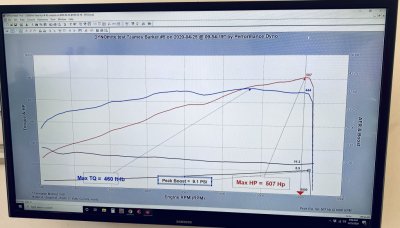

Jbarker83
Aug 1, 2018
33
You have a nice spread of torque with the curve being virtually flat from 4300-6200rpm. The stock cams & CMCV delete will fatten the curve below ~5000rpm. You'll probably see a small increase in peak TQ and with the peak shifted lower in the rpm range. At 6200rpm you should still have over 500rwhp.
did the delete plates and stock cams ended up going from 544whp was the max tune with my cams but tuned down to 507 now stock cams back in and delete plates and got 483whp w/ boostane 507 and went from 430wtq to 420 dyno graphs across the board untill 5k was the same as with the cms cams and stock cmcv :( needed boostane to get my current set up back to 507whp
tuner said i should have kept my cms cams they didnt lose anything and sounded better they only gained so i took the stock cams back out and kept the delete plates in and im even thinking the stock cmcv don't affect performance as the plates lost peak torque and my tuner is a well respected mustang tuner in the north east
