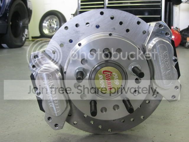

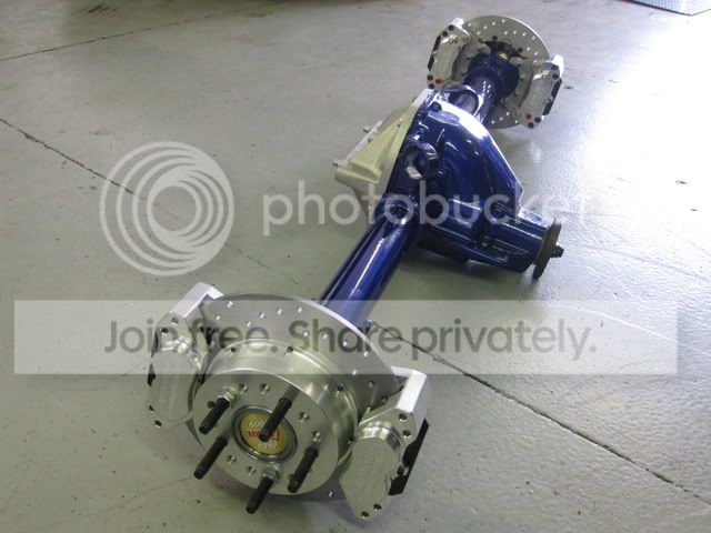

Mark, you need a brake set-up like the one Greg's is putting on his car, we are installing it on his TT car now.
US-1
Banned
Apr 8, 2007
12,808
183
The ShadowLands
The only problem is getting Aerospace to do the brackets for dual calipers on an S197 application. They don't really want to do it. I'm going to stay on their ass about it though.
Or I'll just put a damn 9" in the car and order an off-the-shelf setup they have.
