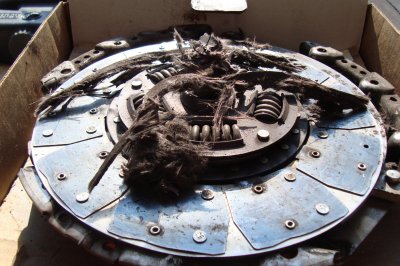

Well I figured I would follow up and post these pic's for all just in case some one was in the market for a new clutch that they think was track worthy.
Evidentally this one couldn't pass the test. Centerforce DFC-
1. Stock clutch easy 100 passes with 6-8 75rwhp shots.
2. Centerforce DFC ~20 Passes no N2O.
3. Spec 2 up to bat, we'll see how this one works out.

wondering if i should get a new one now, or wait til my stocker gives out
only 3k miles on the car
1fastpony
Jul 23, 2009
828
Guess it would depend on your power level and application. N/A, I bet you would be good for awhile. If KONABLUE hasn't killed his yet I bet your chances would be good it will hold.
