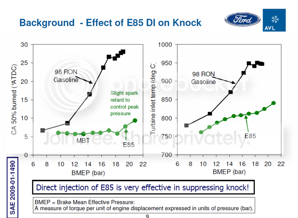

Ethanol/gasoline mixtures aren't supposed to detonate once the ethanol content is over 50%. I'll bet you won't need meth with e85.

Billy,
That is a BIG if. I would love to loose the meth, but 21 psi 12.0:1 CR and 150+* intake temps in Texas heat scares me.
