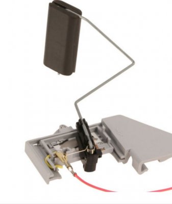

The best sender design is the revised gray plastic body design that ford went to in 07. It has a double shear pivoting black plastic holder for the metal arm and has dual pickups with inner and outer boards on the card.

I would highly recommend picking up oem 07-09 hats for each side with the gray plastic senders. New can be pricey but you can also find used from online salvage yards on ebay.
Then depending on your fuel needs put the pump you need to support your setup in the oem hat. That's how I build all mine be it 400lph, 430lph, or 525lph pump.

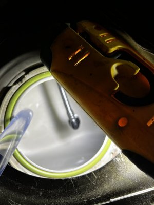

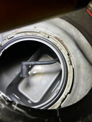

FYI, 9D649B44-4EB4-4320-8C1F-BB4AC6581035.jpeg Here is a photo of the “ bucket” that JeremyH referred to. I took this a couple of months ago when I installed the larger fuel line. It acts like a curb to contain the last bit of fuel in the tank so the pump can pump it out. You can see the hole in the bottom corner that lets in the fuel. You have to make sure the float doesn’t get hung up on that, and the filter doesn’t get folded over. And for those who haven’t opened the tank, here is what the passenger side looks like with a good view of the crossover line.
