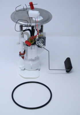

ohh bro! I got the solutions for you cause it cost me 3 hours to figure out this bullshit Walbro did.
Pull your pump out.
Look at the ground wire from the pump to the hat.
I Bet you the idiots grounded it to the body of the pump where that spring is!
Chop that off and you are good to go!

Thanks guys! Lito got back to me with the same solution! Will tackle it when I get the chance.

Yep same ground on my bosch pump. Drove me nuts troubleshooting. Even ordered another pump and had the same problem again ofcourse.

Just an update, got it sorted!
It was as mentioned, there was a ground wire to be removed, once that was done it ran fine =D

I’m pulling up a old thread because I just ordered this pump because it was recommended by Lito. I see the fix above. But once that wire is cut, does it have to be reattached somewhere else? I haven’t even received the pump yet, so I might not have this problem.

No need to connect to anything else, just cut it off
