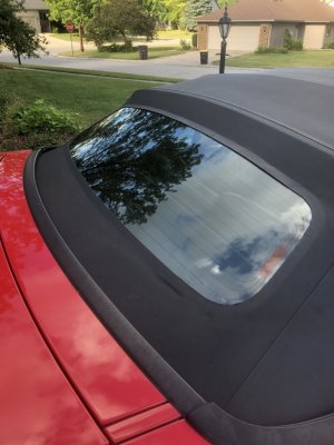

Hi all!
My 06 convertible is suffering a Delamination of the rear window from the top.
Is there any type of adhesive or glue that can fix this short term or longer?
The rest of the top is in great condition.
If not, does anyone have a top for an 05 to 09 v6 in black? Best place to get a replacement?
Thanks !

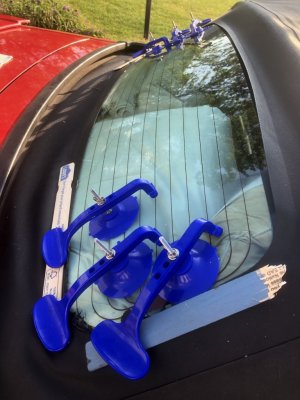

Same thing happened to my 07 convertible. I followed some of the YouTube videos and used the 3M 08609 Window-Weld Super Fast Urethane, 3M Single Step primer (08681), and suction clamps (suck-n-clamps), all of which I bought on Amazon. (see YouTube video "Reglue convertible glass - 2005 Chrysler Crossfire" for the basic process). I did the repair 2 years ago and it's still perfect. Raised the roof slightly during the repair/curing process to reduce the tension on the roof fabric.

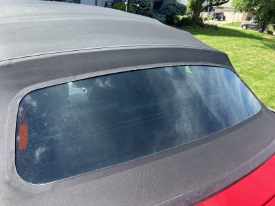

It sounds like my ‘07 had the same issue & fix as LaserMan’s. By the time I actually started the repair, my rear window had all but come completely separated from the fabric. As you can see in the pics, I worked my way around the window (with my son helping) and used old paint 25D4CF33-0E4F-4891-B857-683169980557.jpeg 9D5E9042-D4ED-450F-AF76-2399CF94C89C.jpeg B8308FF1-9F5B-448E-BAC7-3BA9C167572A.jpeg sticks to spread the load at the glue seam. Not 100% perfect but really good and hasn’t changed a bit or come loose since I did it a year ago… As I recall, it was all pretty straightforward but I took extra care going around the corners and applying a consistent bead of glue.

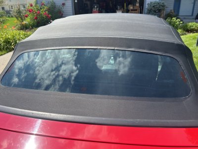

Here are current pics. It rained yesterday so you can see where the dirt has settled into the spots where I put the glue bead on too thick. The pics really magnify the rookie application but overall I’m pleased with the effort… not very noticeable when it’s clean and it was a pretty cheap fix. CD61FC47-363A-4014-ABF9-96E7118B196B.jpeg 76A7A90F-9D1C-4046-A5BA-049B10560239.jpeg
