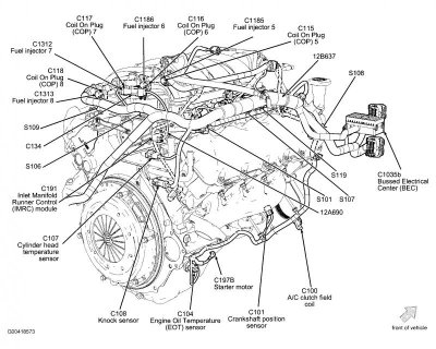

You are correct. Here is a good write up I found about the Cylinder Head Temp Sensor!
http://www.allfordmustangs.com/foru...ech/121152-there-no-water-temp-sensor-gt.html
