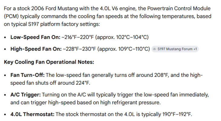

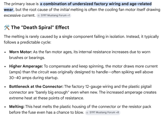

AS mentioned by StockishS197, there can be relay issues, wiring issues, and fan issues.
1. The fact that it appears your high-speed fan comes on when your CHT hits 230 tells me your low-speed fan isn't working at all. You should not be seeing CHT that high. You should rarely even need a high-speed fan, since the low-speed fan and its preset on/off temps take care of that. When was the last time you replaced your cooling fan assembly?
Once the fan assembly begins to fail, it "Tries" to run like it used to but draws much more current to operate, overheating relays and possibly some wiring, and if it gets hot enough, it shuts off or outright quits. This would also explain the voltage issues with charging. If a component is failing and drawing so much current to operate, your alternator won't keep up, and that would show the drops you are getting. You are overloading your charging system due to a simple fan assembly replacement.
The first step is to ensure nothing is melted or burnt. If you're lucky in that regard, check/replace the low and high-speed fan relays. Then you really need to replace that old fan assembly. A few of these troubleshooting items will get you narrowed down, if not completely fix your issue, but when you let a car go a long time without proper maintenance, the issue can manifest.
Also, to prevent any issue in the future, as StockishS197 stated, you need to look into the fix to prevent future issues. That is where the:
Dual Relay Harness Upgrade

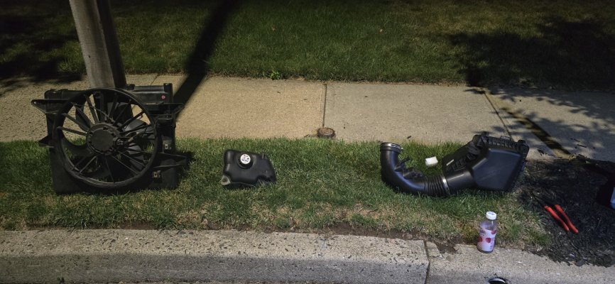

Ok,
A lot of this has been very educational for me. I had no idea replacing the fan assembly was considered preventative maintenance. I checked the plug on the fan assembly and it didn't have the burn marks. I will check the relays tonight.
I looked into the wire everything harness. I am very familiar with the electronics and design elements and will be making the harness myself. It's just not worth $199.

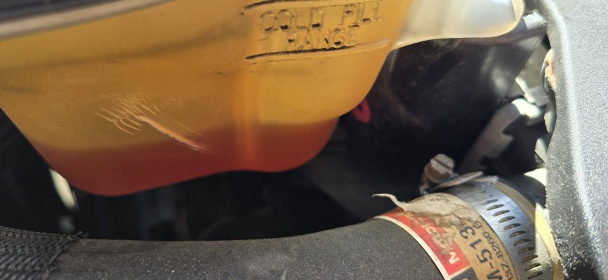

But before I do anything I am replacing the coolant reservoir. Evidently mine has a stress crack.
I'll be ordering the fan tonight. And checking out the relays. I'm hoping my A/C compressor hasn't gone the way of the dodo. Could this fan issue be resulting in no AC?

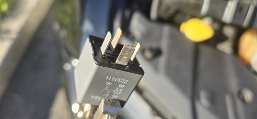

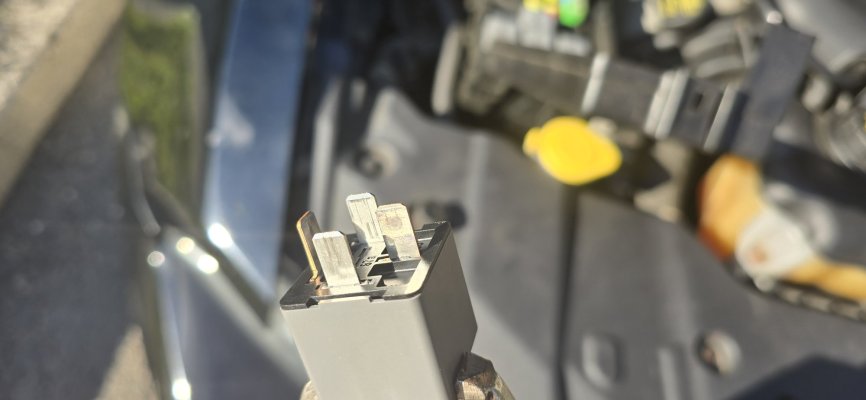

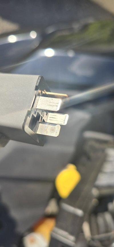

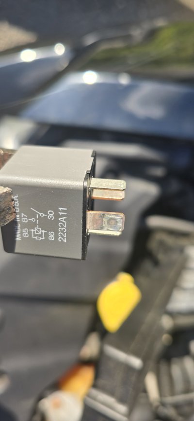

Here's 50 and 55. They appear to be fine.
When I turn the A/C on, the fan turns on for 3 second then turns off. It sits idle for 30 seconds. Then kicks back on for 3 seconds. And the cycle continues indefinitely.
I'm not sure what I'm looking for regarding the A/C compressor.
MrBhp
Sep 12, 2013
1,803
1,513
The part that melts is below what that relay plugs in to. The box separates into two pieces. That's where the damage is.

I wanted to share with everyone who helps point me in the direction. Replacing the fan fixed everything. I now have ice cold AC, and I no longer head CHT high temps. Nor does the car bog down when the fan kicks on. All is right in the world again.
Thank you guys for pointing me in this direction. In 12 years, I will replace the fan again.
