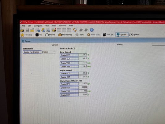

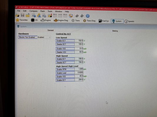

Hi brasil,
Been following this thread..........provided below are 2 pictures.......1 of the Spanish Oak ECU OEM 05-10 MY GT & 07-10 MY GT500 calibration cooling fan profile & 1 of the popular aftermarket tuner used Spanish Oak ECU 05-10 MY calibration cooling fan profile.
A summary of how the Spanish Oak ECU OS's are programmed to use these settings:
With HVAC off:
The ECU will follow the settings shown for Low Speed Fan enable, Low Speed Fan disable.....until the vehicle MPH speed read off the VSS sensor exceeds the VSS disable setting.......the fan is turned off thus will be freewheeling until the MPH speed goes below the VSS enable setting then the fan will be returned to the Low Speed Fan enable, disable settings.
With HVAC on:
The ECU will turn fan on at Low Speed continuously until the MPH settings override as previously described & return back to continuously on.
Hi Speed Fan:
The ECU will only go here if the inferred ECT from the CHT temp (not the CHT temp.......) exceeds the HI Fan enable settings & will only turn off when the ECT drops below the Hi Fan disable setting. This setting will override ALL Low Speed Fan settings thus the fan will run at Hi Speed regardless of MPH speeds & will not turn off.............this is what is burning up the fan wiring in BEC, fan connectors & relays when this is kept active for excessive amounts of time..........because it was never intended to be ran for extended time, in reality it is never intended to be run at all as if all is in good working order in the entire cooling system & these settings are left intact, the Hi Speed Fan settings should never be reached.
Hi Load, Hi Speed Fan:
These settings are exactly what the title means.......these will come into play if the engine enters low RPM, hi engine load criteria (think low RPM towing or low RPM lugging up a steep hill\incline for examples..........)......for this to become active, ALL of the settings have to be satisfied at the same time then will shut down & revert back to the reg Low Speed Fan settings when just 1 of the settings here drops back below\above its trigger setting.
The testing method you just did is showing you which fan cooling profile is being used in your car's ECU..............it isn't the OEM stock cooling fan profile thus someone else has been in there outside of Ford.
I put this here w\ the pictures below so you will know going forward exactly what\how this Ford Spanish Oak ECU was programmed from the factory to operate vs the popular cooling fan profile used by the majority of aftermarket\DIY tuners.
Hope this helps.

Hi Glass Top 09
the numbers in the second picture..are exactly the numbers I have here with my 2010 GT..
So someone used a aftermarket Tune-
