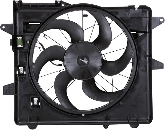

I saw the video and you need a new fan and shroud. Your low speed fan is not working. You verified that by having no fan when you pulled the #50 relay. . The AC compressor doesn't work without a fan because the AC gas pressure is too high and it shuts off. I think that is happening to you when it cycles but you can't hear it because of the fan. There are several good aftermarket fan/shroud on Amazon for under $100 and they all include the resistor that will fix your low speed fan. It is an easy to do replacement and I have done it for the same reason. Meanwhile do not run your AC as that high pressure is bad for the compressor and you may burn it out. You old fan has had many years of workouts and it is a good idea to replace it now anyway.
This is the link to the one I bought in 2021 and is still working perfectly. You can see the ceramic resistor about 1/3 down the left side. It is better than the OEM one. I see you have a Pony Package Mustang like mine. It's a beauty. Hang on to it.

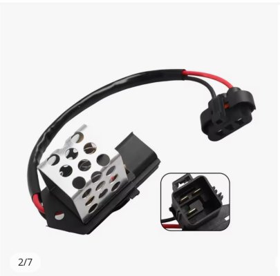

Great!!! Thank you so much for all your help. Do I understand that the fault is in the fan resistor or in the fan motor? The problem I have is that to bring any spare part to Spain, I have to invest triple what it costs in the USA, for shipping and customs... so I want to be completely sure of the fault. I've seen on AliExpress that they sell the fan resistor for very little money. I think I'm going to buy it just to check if it's really the resistor that's at fault and then order the complete fan from the USA. Do you think I could run any other tests to diagnose the fault? Thank you very much. The reference for the resistor is 7R3Z8L603A?
May 23, 2019
457
130
Your high speed fan works so it is not the fan motor. The resistor should fix your fan but you should check your original one with a meter too. Are you sure that resistor is for 2011 to 2014? S197's from 2005 to 2010 use a different one. I don't know what the difference is and it may not matter. I believe the one you are looking at is a Chinese made aftermarket part. It may work fine or it might not. I know when I look here in the US for the 2011 up resistor it's $100+ That is why I bought the entire fan assembly with the resistor in it. It was cheaper. It is just a dumb resistor so your Aliexpress one will probably be fine at least until you get a new fan. Keep me informed how it goes. The Ford part number for the 2011-2014 fan resistor is #BR3Z8L603A and I just noticed that the plug is different. I think you can just swap in your old plug and make it work. The rest of it is the same.
https://ford.oempartsonline.com/oem-parts/ford-resistor-br3z8l603a
https://www.fordpartsgiant.com/parts/ford-resistor-asy_br3z-8l603-a.html

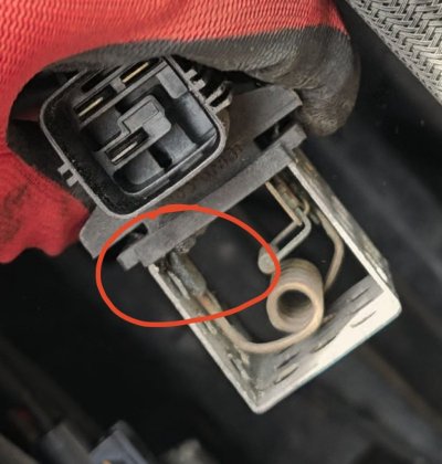

Hey @Breik, if you haven't fixed the issue yet... just recently I had an exact same problem with my Stang. I was also unsure about the exact issue, it turned out that one of my fan resistor legs was fried but still maintained some contact.
I bought an OEM used fan & shroud assy with the resistor from the junkyard here in Europe. Ended up being cheaper than getting the new OEM resistor separately - around EUR 120 shipping included. I swapped only the resistor, 15 min job, works like a charm.
Mind the correct connector to the fan motor itself, as Robert correctly noticed. The one in your picture is 2005-2009.
