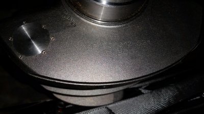

it has stamping KC B07012 521 with 3.800 below that. is that correct crank?

Is it B07012, not B07102? That appears to be the right one. It uses the 3.8 stroke vs the more popular 3.75.

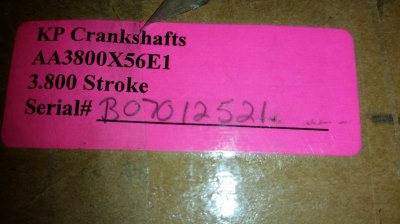

correct my typing is terrible it is B07012 521 .
Also box has a factory kc box with a red/pink label part number AA3800x56E1 on it

I don't know for sure. I was thinking it was a serial number or lot number.

Think I figured it out its added for a serial number.
Just glad I finally found a new one...only cost $515 as I don't think the seller knew prices had gone up
