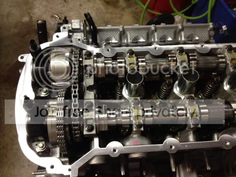

I am not real excited about the "machine" work in the pics either.
with the tivct, theres no real need to do cams in these cars unless you're going for some radical NA build.
Umm I think this is a joke but I'm a little lost lol. Powerhouse had the exhaust cams there when he fixed the head. Mike put the exhaust cams in the head and torqued the caps down then rotated the camshaft around to open the exhaust valves all the way, that's how he checked to make sure that the roller on the follower didn't hit/rub/scrub on the head. I don't know how much clearance is required, it could be "as long as it doesn't touch" or maybe there's some minimum distance to allow for expansion and shit. That's one of the reasons I am glad I had someone who knows what they are doing take care of that part, Mike@powerhouse did consult Mike@L&M on this...so I feel like I can trust his work.

Yeah..It was a joke, just waiting for all the "machine work" comments...LOL.. It's going to work just fine!
It's all nuts and bolts...Nothing to be alarmed about...![]()
