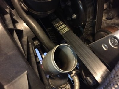

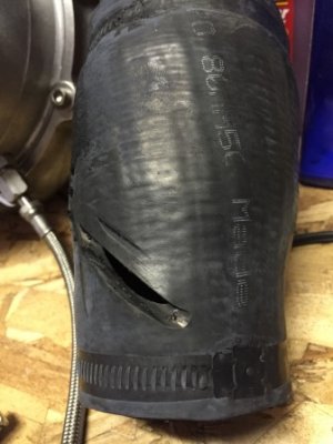

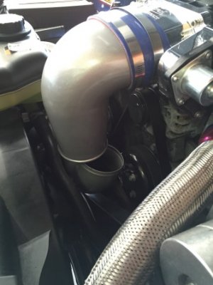

I have searched and searched to find if others were having to cut and weld on their Procharger piping. I have found a lot of bitching about it being a PITA but not anything about having to cut and weld it to make it fit. I am starting to think it's me and I'm just not trying hard enough......Can't be that. This pipe was in a bind and would not line up. So much so that it got into the blower belt and cut into the 3" x 2-1/2" rubber reducer. I can't leave it all bound up and hoping it don't rub another hole in the new reducer. I was just asking if others had similar issues.

Do NOT cut tubing the rubber will blow off , it fits , take your time and it will fit .
start @ bottom on both sides and work up , loose fit everything then when happy
tighten your t bolts .
P.S. that right picture your metal tube is in the wrong position , looks
like in needs a 180* counter clockwise spin .

OK guys, I don't have the patience to keep messing with something that is flawed to this extent. I agree with you about the pic on the right the pipe needs to be turned 180 degrees but then the 90 on the bottom would be 180 degrees out. I have cut it and I will weld it back together. It will still have the beads on the end and look factory so the rubber fittings shouldn't blow off. I also have a Steeda radiator support coming that should give me just a little more room. The Procharger seems to be pointing up higher than the picture in the Procharger brochure. I tried to clock it down but it hits the valve cover. Now that I put the Ford Racing Intake on, my Seibon Carbon Fiber TS-Style heat extractor hood hits the intake. I guess the next thing I will need is a new hood.

OK boys, I got both pieces cut and welded back together. I got to get some paint on them and I will try them out this weekend and see where I'm at. Better - Worse? We will see.

OK Boys, I got the Steeda radiator support in this weekend and if you don't have one and you are bitching about not having room then it is the answer to the issue. I couldn't get over how much it opens up the area I needed for the procharger piping. The pipe was so loose that I had to zip tie it in a couple of spots to hold it in place. (The BMR may have given the same amount of room.) The modifications on the pipe where I welded it were perfect. OK......nothings perfect but DANG I am happy with it. Best 2 decisions for installing the pipe. I still say that they should have sent another elbow and coupler just like the Stage 2 kit has but it works.
