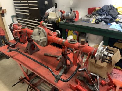

2009 GT with lots of welded/ bolted on chassis and suspension mods. Just bought Ford Racing LSD and 4.10 gears. There are several aftermarket differential covers for sale from $150 and up. My question is this: What is the benefit? Is a $200 cover a necessary item? Maybe most important, will it make my car faster?
As always, thanks in advance to the wise old heads on this list.
