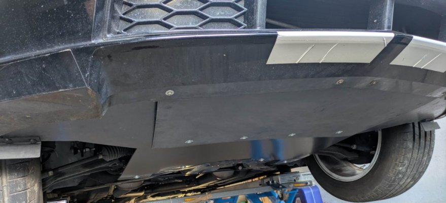

On the driver side my CAI is getting all the air through this gap to the hood. So, your deflectors are not directing the air to the ground only to the side? Not easy to see on the pictures.

Car is much more stable at high speed now with the front panels.

How has this effected your low speed cooling?
On my prior 06 GT, I did the 2010 belly pan and similar mods and the amount of air that got trapped in the engine bay was significant at the detriment of higher IATs and ECT.
That hasn't been a problem for me. If anything sealing off the underside of the engine bay prevents air stacking up under the hood, allows the cooling fan to work more efficiently because it doesn't have to work against pressurized air in the engine bay, and reduces the chance of hot under hood air getting into the CAI. When you also have the benefits of improved gas mileage, improved high speed stability, and a higher top speed due to a lower drag coefficient, it's a win win all round.

Coolant temp is the same as before, I have an CAI, the car doesn't have a coolant temp sensor, so I guess the engine temp is roughly the same. Maybe the fan kicks in a bit earlier than before?

Maybe some of the panels can be retro fitted. Would be nice to know what kind of material it is, looks like a fiber composite.

Results 300 miles trip: Speed most of the time 70-75 mph, 27 mpg (3.73 gear), no cooling issues (72F outside, global boiling.... )
Update: I noticed that the exhaust tone is more emphasized than before, that could be a side effect that the air at the front is smoother and do not produce so many turbulences anymore (?)

not sure if I will add strikes. It is more difficult than I thought, starting with the material, must be light and stable at 140 MPH and look "professional". Was thinking of 8 mm PE, but was way to heavy, plywood lot of work to make waterproof, ABS looks like home build .....
