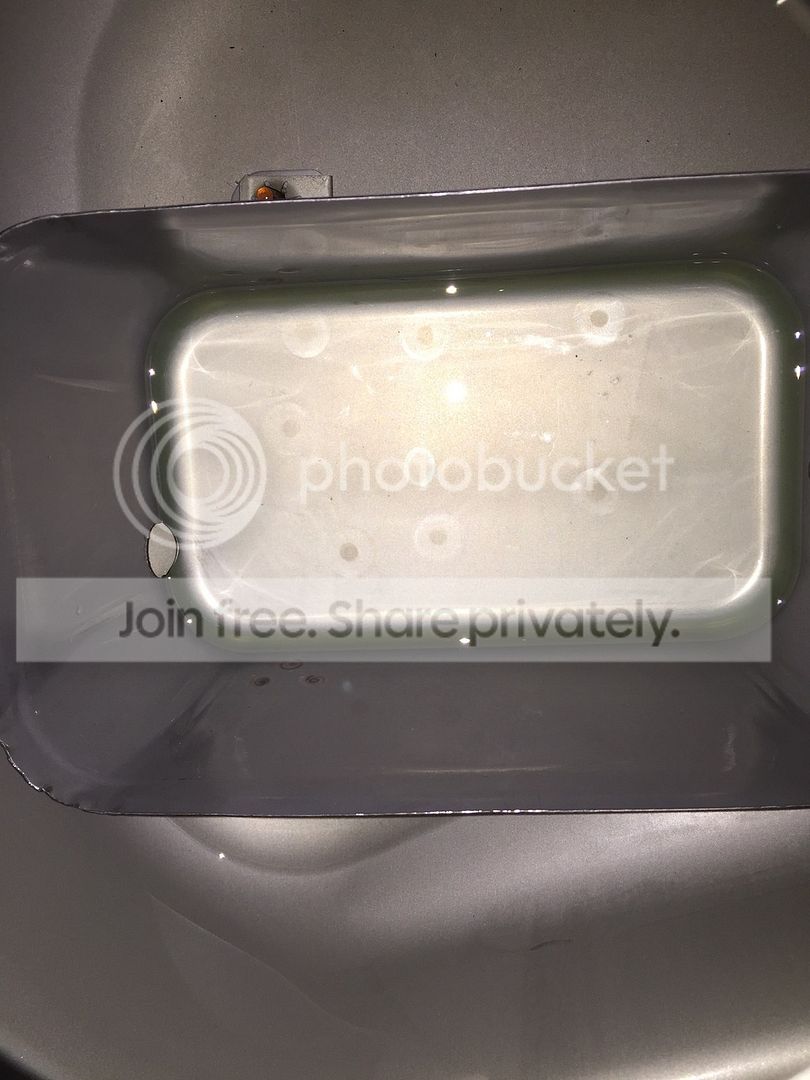

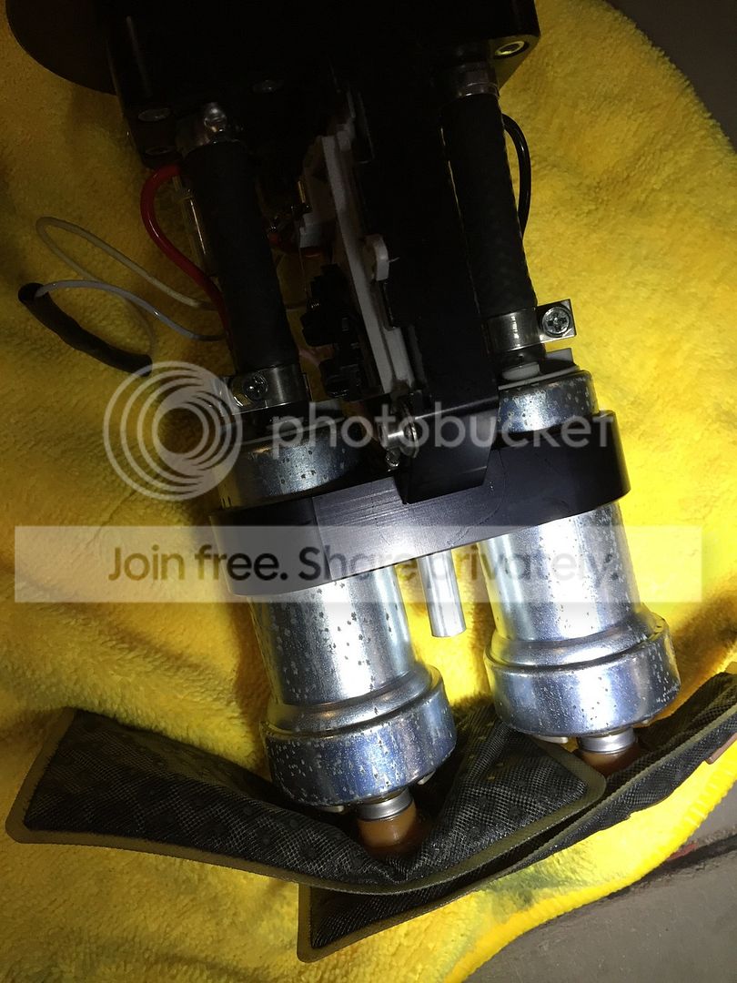

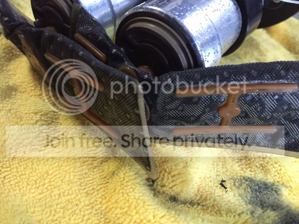

So I pulled the hat and found this

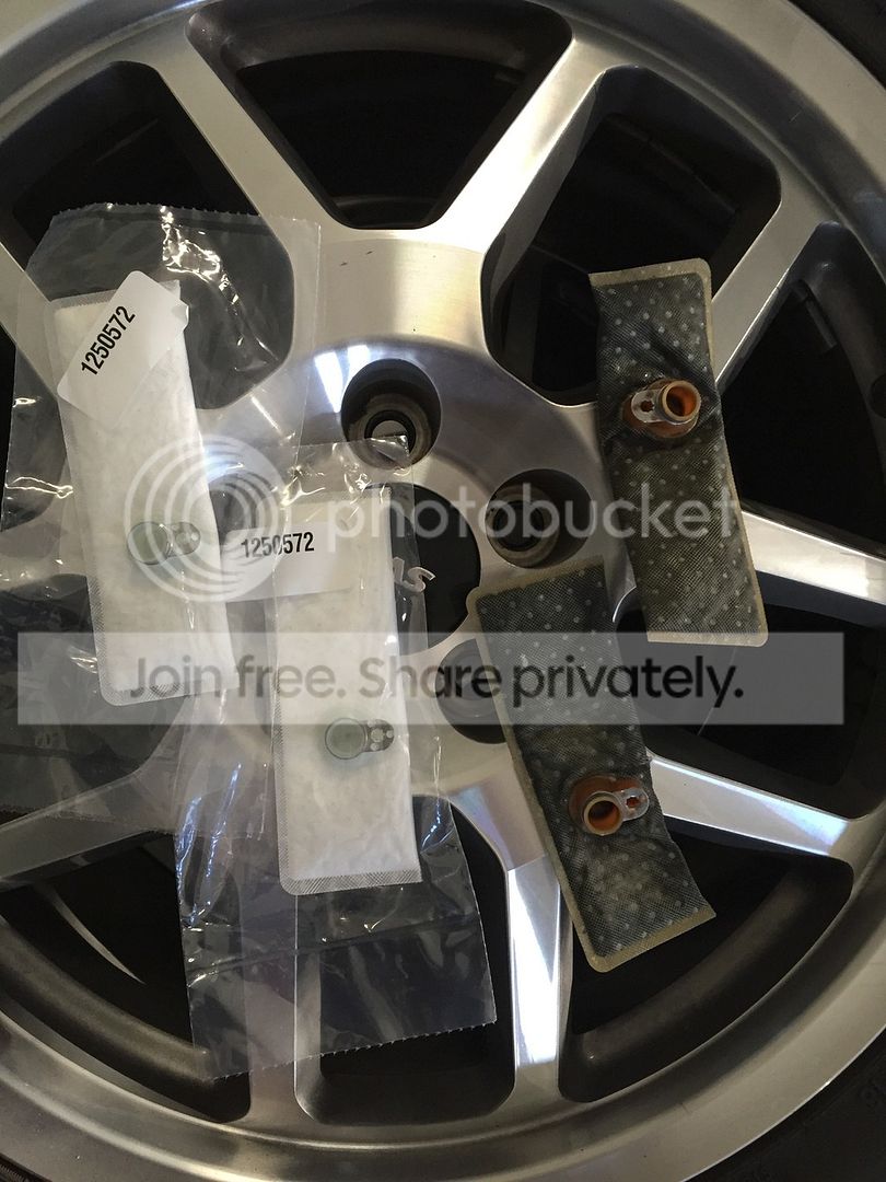

Compare to new ones.
