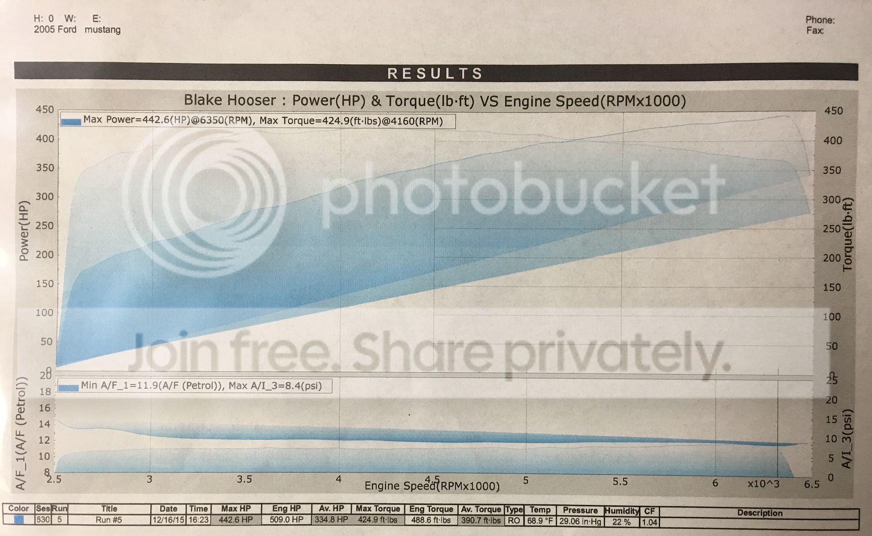

Update: back from Gearheads getting tuned. As many suspected, it was the tune that was causing the issues. I also learned that it has a smaller pulley than I thought. Can't hate these numbers:
I'm really pleased with the work from Gearheads in DFW. Drives like a completely different (much faster) car now. Idle is good, no stumble at all at higher RPM.
